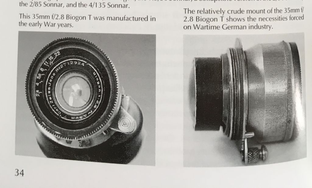

                        With enormous thanks to Keith and his contact … We have something reasonably approximating hard evidence:
                        That Biogon is Wartime issue, so a little later than the ‘Holy Grail’ pre-War 5cm 1.5 Sonnar … BUT we do have a photo of the mount : It’s still not definitive, but it does look like a Whitworth thread-form to me, and crucially, I see no reference in the text to any 60° metric pitch approximation.
