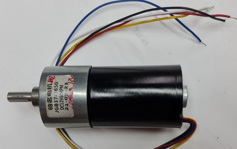

                      Very interesting Michael especially the calibration process – I must download the Arduino code and see what it does about the intertia of the motor.
                      I have been using a brushless geared motor like this
                      to drive the leadscrew on my little Taig lathe. It's 12v, 7watts, 60rpm rated at 15kg.cm of torque and about £25 from Ali express. The gearbox is 131.5:1 reduction. It has forward and reverse control, speed control via PWM input, and outputs 6 pulses per rev of the motor (787.5 pulses/rev of the output shaft) on a signal line – all at 5v logic levels.
                      It has worked very well, and my little Arduino controller used the pulses to measure leadscrew speed. Some time ago I decided to try and count the motor pulses as a way of determining carriage position with a view to implementing an auto stop. It worked OK, but I could not get the stop at a chosen zero. It consistently overshot (by up to 0.15mm) but repeatably so, and I assumed I had a code error.
                      It took a long time before the realisation dawned that there was enough inertial energy in the little rotor (@ 7000+ rpm) to drive the load of the carriage – through the gearbox and leadscrew for several ( up to 10) revolutions of the motor once the power was cut.
                      By computing and allowing for the overrun based on the speed of the motor, I can now get it to stop the carriage repeatably within 0.01mm.
