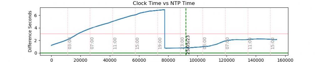

                      This morning's graph is looking much better:
                      To test the code I ran the clock with compensation switched off. In this state the graph should show straight-line drift with deviations due to changing temperature. The graph is consistent: it show rate of drift falling overnight as the temperature drops. (The pendulum should speed up when the rod shortens due to cooling.)
                      Too soon to break out the Champagne, so I'll leave it running for another day to make sure. If all good tomorrow, I'll switch the compensation on.

                        More distractions, big chunk of yesterday spent with a relative in hospital, visiting mum today, and I've been jabbed against pneumonia.
                        However, just looked at the clock, which is running with drift compensation only, that part now seems to be working OK.
                        Until after 19:00 yesterday the clock ran uncompensated on average period, drifting about 5 secs in 20 hours. The blue cliff-edge is me resetting the clock to UTC, about 0.2 out because I didn't bother to correct it closer. Then the clock gains slightly until dawn, when the temperature rises and it speeds up. Since about 8am it's been about 2 seconds fast. Very tempting to switch temperature and pressure correction on, but better to let the sensors collect more data whilst the weather happens to be providing some decent temperature and pressure swings for the statistics to chew on.
                        Although drift correction looks good now, I'm not sure why it's necessary at all. The analysis calculates the pendulum's average (and median) swing times, and compares them with a more accurate clock (NTP). That gives my clock's 'should be' average, which is fed back to the clock. As the pendulum's actual period doesn't vary much (stdev 0.000052s), and the distribution is balanced, I don't understand why the clock drifts in a more-or-less straight line away from NTP. Must be a constant error somewhere in the system and it needs to be identified.

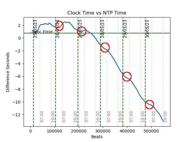

                                                      Ho, hum, bum!
                                                      Latest result not good:
                                                      As can be seen, the uncompensated clock kept reasonable time for 2.5 days with bumps explained by the weather, then at midday it started losing time in a near straight line, i.e. constant drift.
                                                      I have no idea why. Nothing happened at midday, and the drift isn't obviously related to temperature or pressure. The pendulum seems OK. Nor is NTP to blame. Possibly my logger program or the operating system is introducing a delay. Or drift correction has mysteriously turned itself off. (Thinks – overflow?)
                                                      Another oddity is ringed in red. Just after midnight the rate of drift slows until about dawn. Could be daylight or temperature related.
                                                      Although the parts needed to build the vacuum enclosure have all arrived, I see no point in sucking air until this latest problem is fixed.
                                                      About 25% into a giant tidy-up too. Tedious and tiring, and I haven't started on the workshop mess yet!!!
