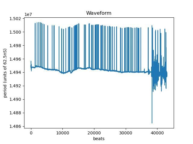

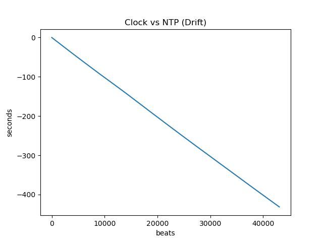

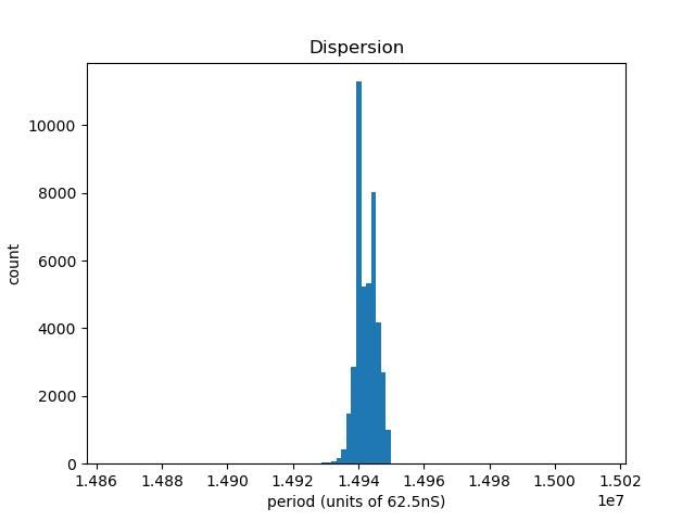

                                                    Progress report. I'm running the clock without compensation to see how much impulse the revised pendulum needs – the bob is nearly 5 times heavier than the Mk 1.
                                                    A few problems:
                                                    • Self-start isn't totally reliable (failed once)
                                                    • Despite being mounted in a brass tube, the IR receiver was still sensitive to ambient light entering from the rear. Even though it shouldn't be necessary when the container is fitted I've added a shroud, which ensures good behaviour whilst testing the uncovered clock in daylight.
                                                    • Software bug in my code, where compensation was applied even when told not too. As the temperature sensor isn't fitted yet, the compensated period was wrong.
                                                    • Had to write new code to report on reduced data (no temperature etc.) Made more mistakes!
                                                    However, results are promising:
                                                    Nice straight line comparing my clock with NTP: it's consistently slow, which is easy to correct.
                                                    Dispersion is good (Q nearly 4000), but has two peaks, which is consistent with over-impulsing. I found balancing impulse so amplitude stays constant (approximately – see MichaelG's comment!), to be tricky. 18 is too low, 20 is too high, and the stats show 19 is slightly too high. The hardware timer's resolution is a little too coarse.
                                                    Something odd with the waveform, which displays a comb effect. Values that jump much further from the mean. The comb exaggerates the error – 88 times in 43153 is 0.2%, and it's not that big – standard deviation is 0.27uS
                                                    The wild jumping about at the end is due to me eating breakfast next to the clock and vibrating it.
                                                    Annoyingly have to go out now, because I have several changes to make!
                                                    #642975
