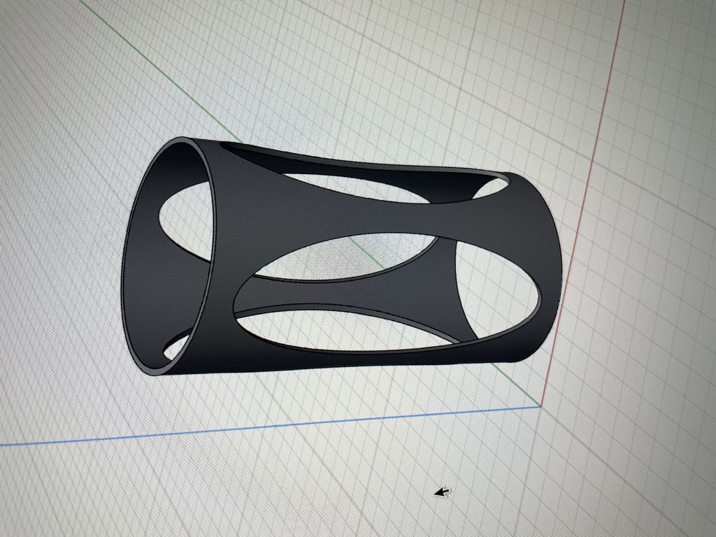

      A subtlety with my suggestion might have been missed. I am not suggesting a closed tube, I am suggesting starting with a closed tube and then milling oval shaped access holes. These holes can be quite big – as long as large webs are left top and bottom, a lot of rigidity will remain while allowing good access to the mechanism.
      Think of the steel roof trusses in your local supermarket or DIY store – commonly have large cut-away diamond or circular holes all along the centre web of the I beam, but retaining (most of) the structural strength, Now imagine that sort of thing rolled into a tube with the access slots around the side wall of the tube, blending into a full tube at the top and bottom, so it would give plenty of access but vastly improved rigidity.
      I would draw what I mean but am busy battling with a broken central heating system – during the coldest part of winter – of course !

        No need to draw it John, that's what I understood you to mean. I haven't dismissed the idea, because rigidity is important. The advantage of my tripod is it's easy to make, and provides lots of big gaps. The disadvantage is a tripod can't be as rigid as a tube, or cross-braced structure. Duncan suggested a Shukhov Tower in the other thread:
        These minimise material whilst maximising strength and rigidity. My problem is designing one – it depends on hyperboloid curves, and then assembling it. And it leaves no space for fingers!
        So I have to make compromises, and it's very possible I'll get them wrong. I hope someone else will have a go, because I'm getting more good ideas than I have time to try!

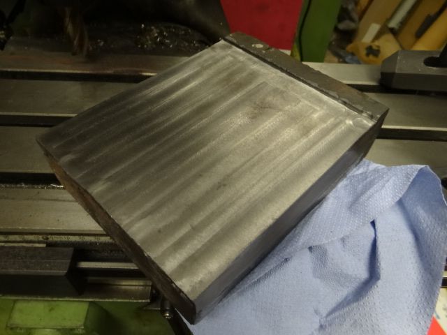

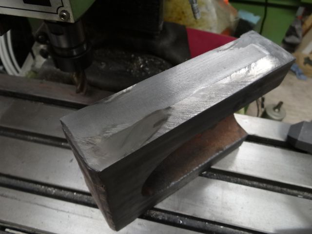

              Been out visiting and to buy food so the block is shaping up slowly. Had to go deeper than expected to get down to clean metal, but it will do.
              Could stop here, except I don't often get the chance to square-off a hefty block and need the practice. HSS won't touch the scale and I think the quickest way to shift it is with an angle-grinder.
              Decided, again, that I need a bigger milling machine! No chance, unless I buy another house first. As can be seen my biggest end-mill doesn't have the length needed to tidy the edges in one pass:
              Tempting to order a carbide shell mill for this but I'll see how my fly-cutter gets on first.
              The job is incredibly dirty, black dust everywhere, and the contents of my nose are extra disgusting. (Bogey photos available if anyone wants evidence!)

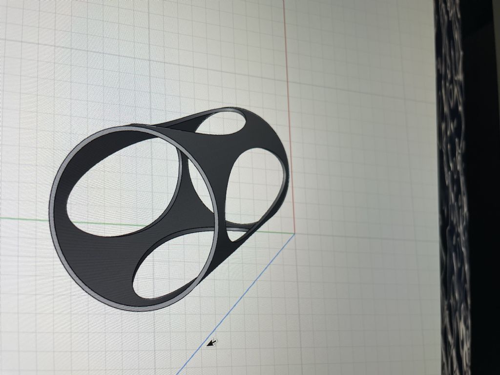

                  John Doe 2
                    @johndoe2
                    This is what I mean – of course the images have come out sideways, and I cannot find how to rotate them but I am sure you get the drift.
                    Moderator Note:  Unfortunately only moderators can rotate photos. It's a forum quirk and turning them is my main service to the community!     Dave

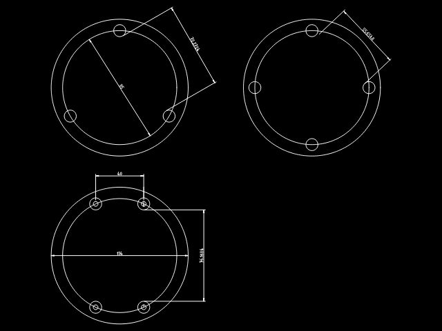

                      Played with some pillar layouts last night with 2D QCAD, which is easier to use for this job than SE:
                      I measured the space available for my fingers between pillars in three vertical configurations. Equalateral-tripod, square-quadripod, and rectangular-quadripod. Sorry about the blurred numbers – the tripod gives 72.3mm access, square 57.2mm, and the rectangle 70.77mm.
                      My hand: 4-fingers across = 90mm, 4 fingers + thumb = 110mm, and forefinger + thumb = 40mm.
                      The advantage of vertical pillars is space and simplicity of construction. A tilted tripod supporting a 240mm high platform would be angled at about 75°, requiring me to drill diagonally into the base and platform. Could be done, but it's harder to do and more error prone than going straight in with a milling machine. Perhaps in the Mk V!
                      The equilateral triangle both maximise stability, whilst the rectangle gives better access in exchange for less stability sideways (compared to a square.)
                      Spent this morning reading about columns with discouraging results. Apart from the maths boiling my brain, my book says things like "Great and apparently insuperable difficulties arise as soon as we attempt to obtain expressions which relate the strength of longer or more slender columns to their various dimensions."
                      It usefully explains why circular pillars are better than square or other shapes, the importance of fixing the ends, and would help if knowing the safe load was a concern. The safe load doesn't matter because my bob only weighs about 40g and even a spindly tripod will easily support it. And then the chapter on eccentric loads, which covers my case, doesn't cover dynamic loads (a moving pendulum), or say anything about rigidity, which is my chief concern!
                      I hope Solid Edge's Simulation tools will help, but frankly have to admit I barely understand the basics.
                      Going to spend an hour pondering what to do whilst de-scaling cast-iron in the snow. I guess cross-bracing a quadripod is the answer, but I'm not sure how to do it whilst allowing access. Before deciding, I need to model the chariot that carries the sensors and electromagnet. Either it fits through the gap or I have to emplace it first and then erect the scaffold around it. Hmmm.

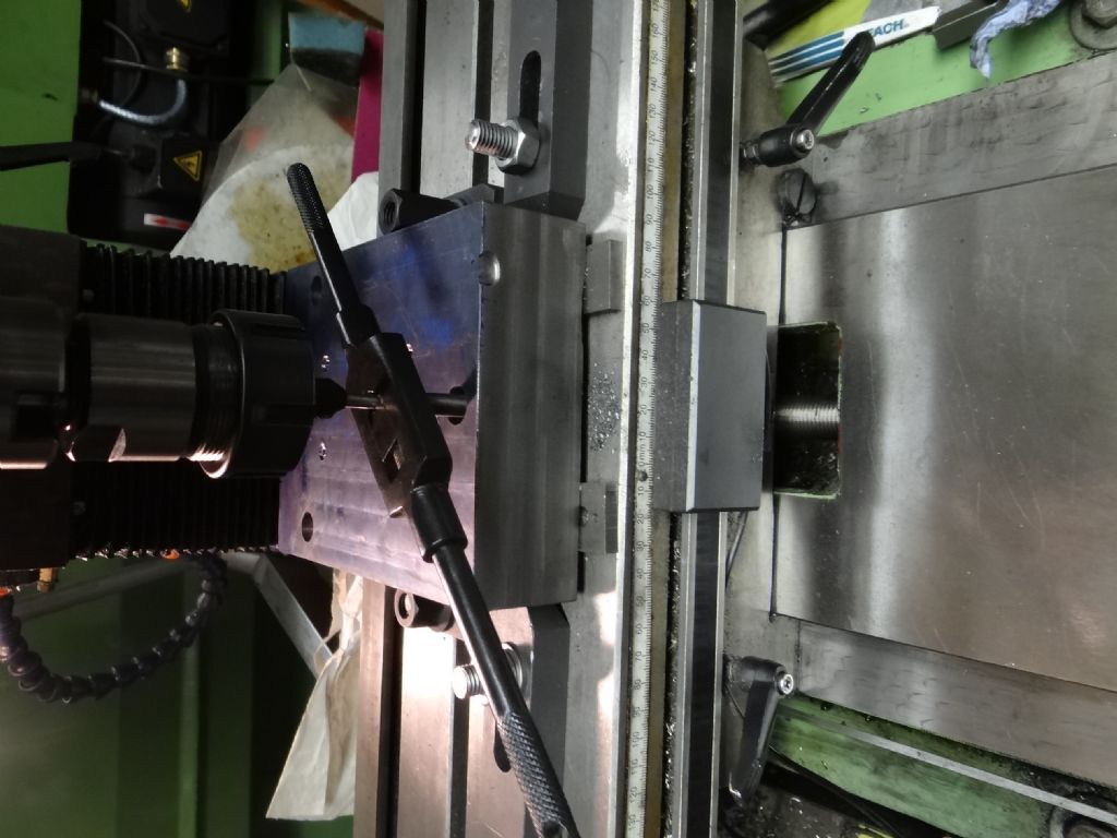

                          Slow progress for various reasons, but I'm getting there.
                          This is the base squared off and tapped to take the support columns:
                          And here I'm tapping the holes for the M12 adjustable feet:
                          Annoyingly the Aluminium tube needed to complete the four pillars has gone walk-about and I've decided to buy more.
                          The only remaining major operation on the base is cutting the 4mm wide circular slot needed to take a 4" diameter plastic soil pipe. Not sure whether to trepan the slot in the lathe or mill it. The problem is how to hold a block of that size. May open another thread on the subject – it's work-holding and cutting rather than clock related.
                          I'm dithering about where to put the vacuum outlet too. Under the block's centre of gravity for balance, but that puts it directly under pendulum BDC, where running the pump seems most likely to disturb the bob. Dithering about the rod as well, having gone off thin carbon-fibre, so probably another question coming in the Precision Pendulum thread.
                          Applying "lessons learnt" is proving painful!

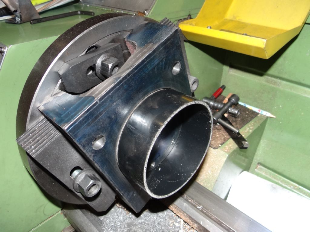

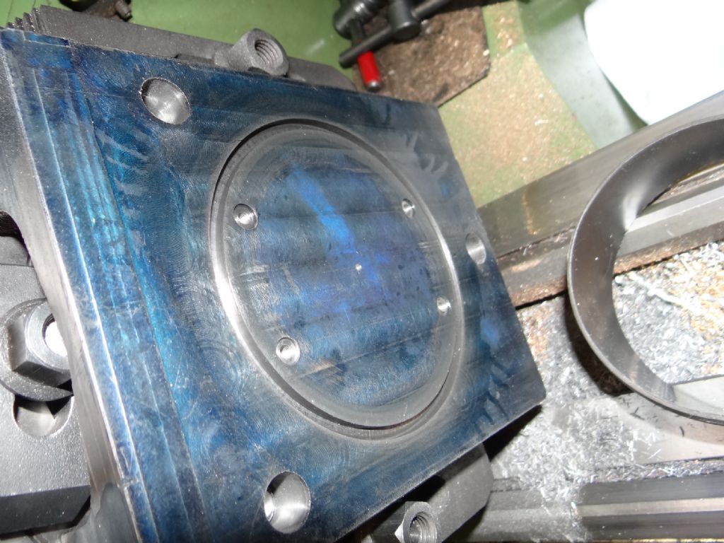

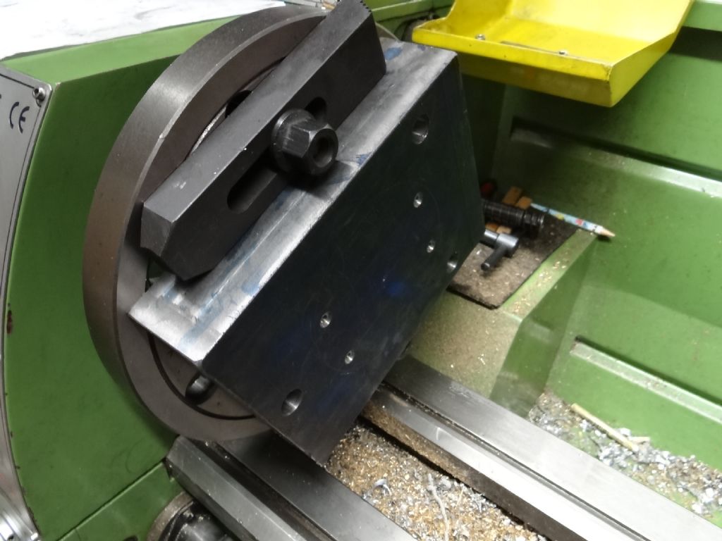

                          #640382

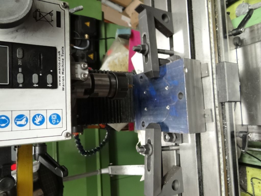

                            Decided the base block was too big for my rotary table without making some sort of platform, so I'm going to trepan it. The block clamps nicely to my 240mm diameter faceplate using its levelling screws:
                            The milling table clamp on top is for balance, not holding. There are 3 of them, and I'll find out how effective they are when the faceplate is powered up. Only about 100rpm, but it will be shake, rattle and roll if the balance is off.
                            Now all I have to do is grind a trepanning tool, and I'm infamously cack-handed. What could possibly go wrong? Fingers crossed!
                            #640420
                              Worked out OK :
                              And the test section of pipe fits perfectly, phew:
                              Edited By SillyOldDuffer on 06/04/2023 19:48:27
