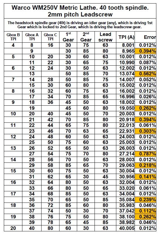

      A quick intro : for the last 40 years, I've been using my WW2 Lend-Lease Sheldon (Chicago) 10" lathe to restore pre-war British motorcycles. A couple of weeks ago, I bought a new metric WM250V and sold the Sheldon to a friend. Time will tell whether I'll regret this……frown
      Got a few questions on the WM250V if that's ok? BTW: I've already read many of the excellent threads on this subject and have downloaded NthreadsP and PICCLOCK's "WM250 Change Gear Calculator" but my favourite is this online tool, **LINK**
      1) The marketing blurb said the range of imperial thread is 8 to 56 and I foolishly forgot to see what actual threads fell within that range. Initially, I was a little alarmed not to see 26tpi as one of them in the gear change tables in the manual or on the front of the machine but Googling led me here and all is well. My first question concerns the recommended (as in the facia table) change gears for 20tpi which are stated to be 40 (spindle), any idler, 80-75, 60 (leadscrew). All the above software programs show this combination to have an error of 1.575% and yet another combination for 20tpi of 40 (spindle), any idler, 70-50, 45 (leadscrew) only has an error of 0.012%. What am I missing here? Is it that some combination won't physically fit on the machine? I've now created my own table covering all TPIs between 8 to 40 focusing on the least error and using the minimal leadscrew gearbox on the 250 (A 1:1, B 2:1 and C 0.5:1), this range can be expanded to 4-80.
      2) Second question concerns the engagement of the horizontal leadscrew. The 250V introduced power cross feed but this level can also engage the horizontal feed but at half the speed (I think) to the main lever. Is there any reason why I should not use this new lever for thread cutting? If not, it means I can set up the change gears (for example) for 20tpi on the A (1:1) leadscrew gearbox setting and cover 10tpi on B (2:1), 40tpi on C (0.5:1) and then 80tpi if I use this new lever for leadscrew engagement?

                  Hello Paul,
                  Now that I know the leadscrew pitch [thank you] I can confirm that the second gearing choice you listed will indeed produce a 20 tpi thread of 20.0025 tpi, close enough for most purposes I think. The version of 40/80 as the first reduction stage will produce a 20 tpi thread if followed by gearing of 47/37, hardly handy!
                  40–idler–63 on the leadscrew works well [error 0.003 tpi ] and with a 63T gear you can get most imperial pitches. My book on lathe gearing covers lathes with 2 mm pitch leadscrews. Available through Google with change from £15 it might solve several problems for you. [Gearing of Lathes for Screwcutting] ISBN 978-1-78500-250-2

                        Thanks Mick….that's good to know about the 250V. I loved my 80 year old 10" Sheldon but it lacked many features that a modern lathe has like electronic speed control, reverse motor, power cross feed.
                        I put the following table together using data from the bilar website link posted above, so I'm not responsible for the calculations but having checked a few of them with other software programs that do these calculations, they match. I'll be using this table rather than anything in the manual or on the front of the lathe. I have it as a PDF but couldn't find a way of posting a PDF file on this Forum
                        Warco WM250v Gear Change Table

                          Well, thanks again for that table, Paul – I've saved it and printed a copy to put in my manual.
                          I have found that threads I've cut as above – using the gear settings in the manual – have fitted existing components quite nicely, but I'll certainly use your table if I come across pitches not in the manual.
