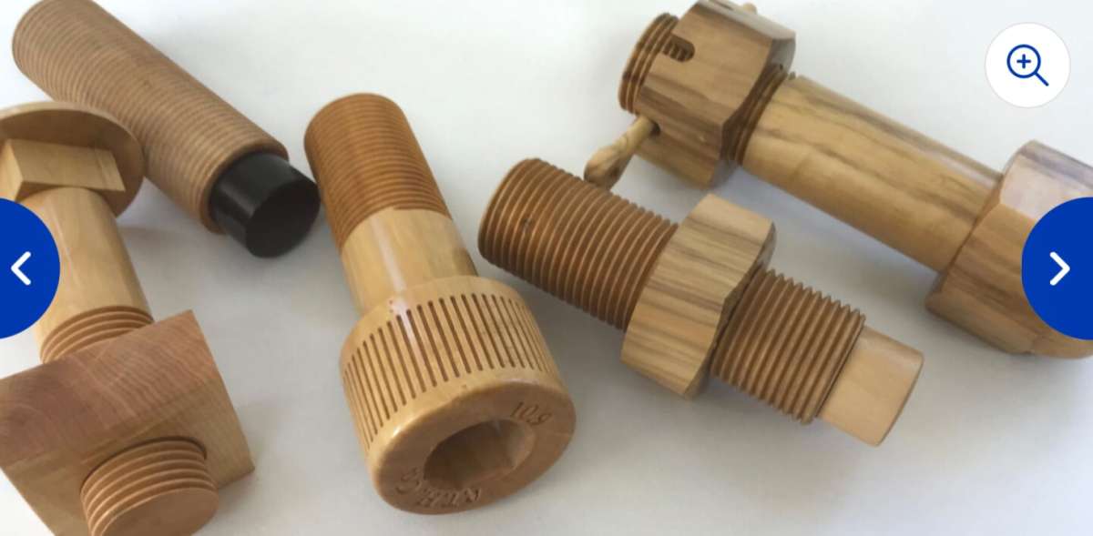

      Always seem to look nicer to me than metric ones. It must be the proportions? Is there some kind of formula that dictates the ratio between the various dimensions?
      I ask, as at some point I’d like to make some large decorative nuts and bolts in wood with my new jig.
      Failing some technical data from the web provided by Michael 😊, I’ll have to sit down at my Mac and draw some samples to see what looks nice!
      I’ll be making Hex bolts but I’d sure like to know how the socket was made in this socket screw!

        If its a really good piece of hardwood (which it looks like) it could possibly be rotary broached.
        #773616
          It’s a lot easier to clean out the corners of a routed hole in a piece of wood with a wood chisel than it is a metal one with a cold chisel
          Did not get the knurling right , looks like it is recessed again with a router rather than raised.
          Should be easy enough to find a chart with the spec for the nuts and hex heads for your chosen imperial form. 1.6 x D looks good to my eye.

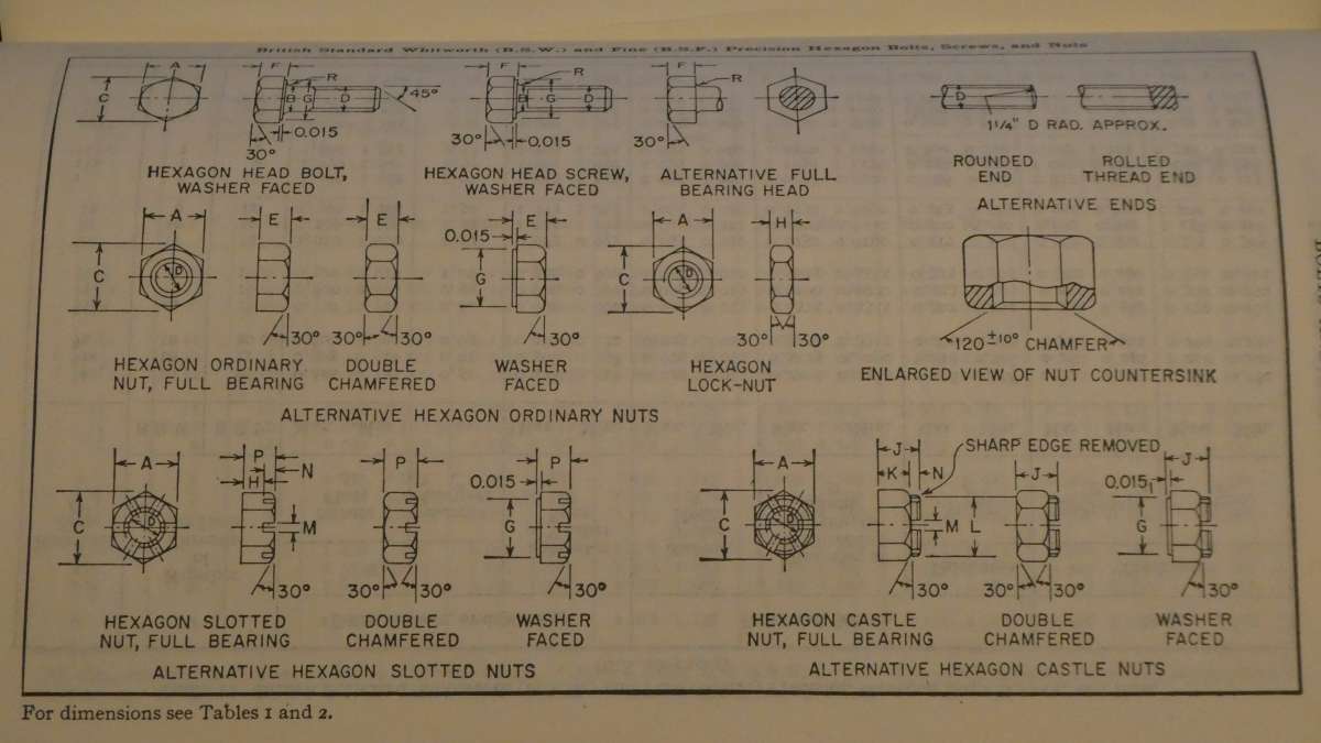

                            P1000751
                            B.S. 1083:1965
                            There are images of the dimension tables on the web.

                                Martin. Thanks for the picture, I’ll search for the table.
