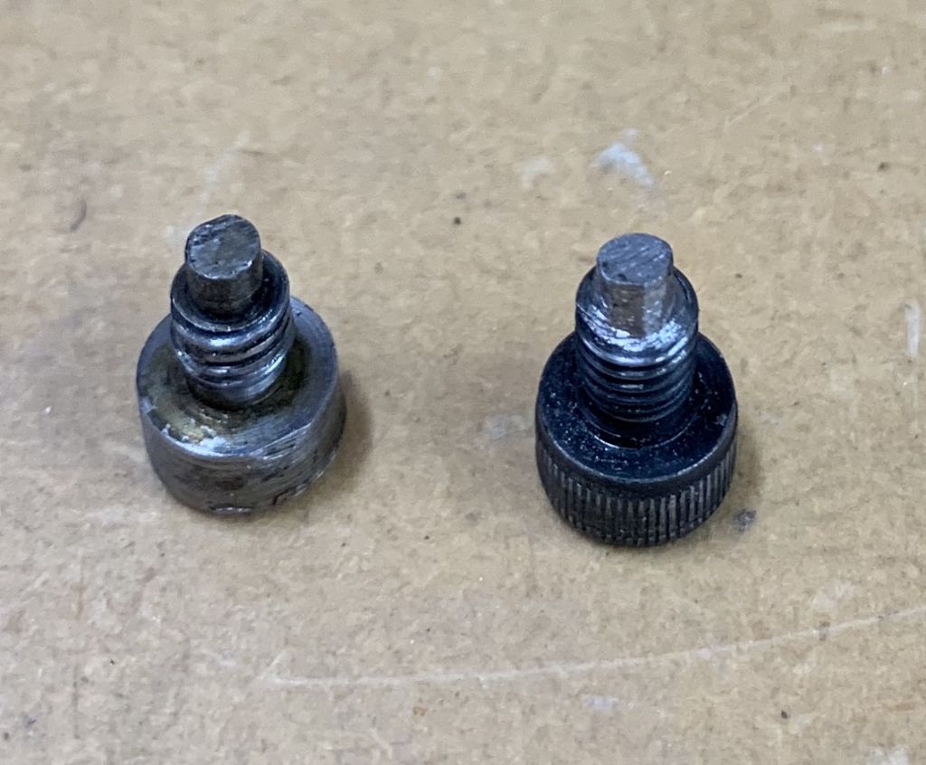

                                            Just thought i'd share a couple of photos of my newly filed dog pin socket screw – it retains the gear for moving the saddle along the bed. Both the original and the replacement are shown. I heard a similar story to Howard's many years ago – if I remember correctly an expedition to the Duhd Kosi river in Nepal had a problem with a wheel stud – the local mechanic simply filed a replacement which apparently gave good service for the remainder of the exped.

                                              The Model A at the museum is certainly not a museum piece, All the modifications and repairs use metric threads as they are easier to get hold of. The only exception is a 3/8 BSF helicoil in the apron where only about 50% of the original thread was left. I even drilled a couple of 8mm jacking screw holes in the saddle as it was a pain to get the apron separated as the dowels are tight. The repairs to the cracked cross slide use 8 and 3mm threads. If I can find the photos for that repair, I will start a new thread on the subject.
                                              That pic of the screws reminds me of when I was a kid and broke a banjo bolt in the rocker oil feeds of my R E Constellation. It was miles from home in Kent. I took the broken bits to a local garage and the mechanic made me a new one in five minutes by just filing a flat on a bolt, easy when you have a practical mind.

                                                      Once the lathe is operable, it may be possible to turn a stub on another capscrew as a permanent replacement.
