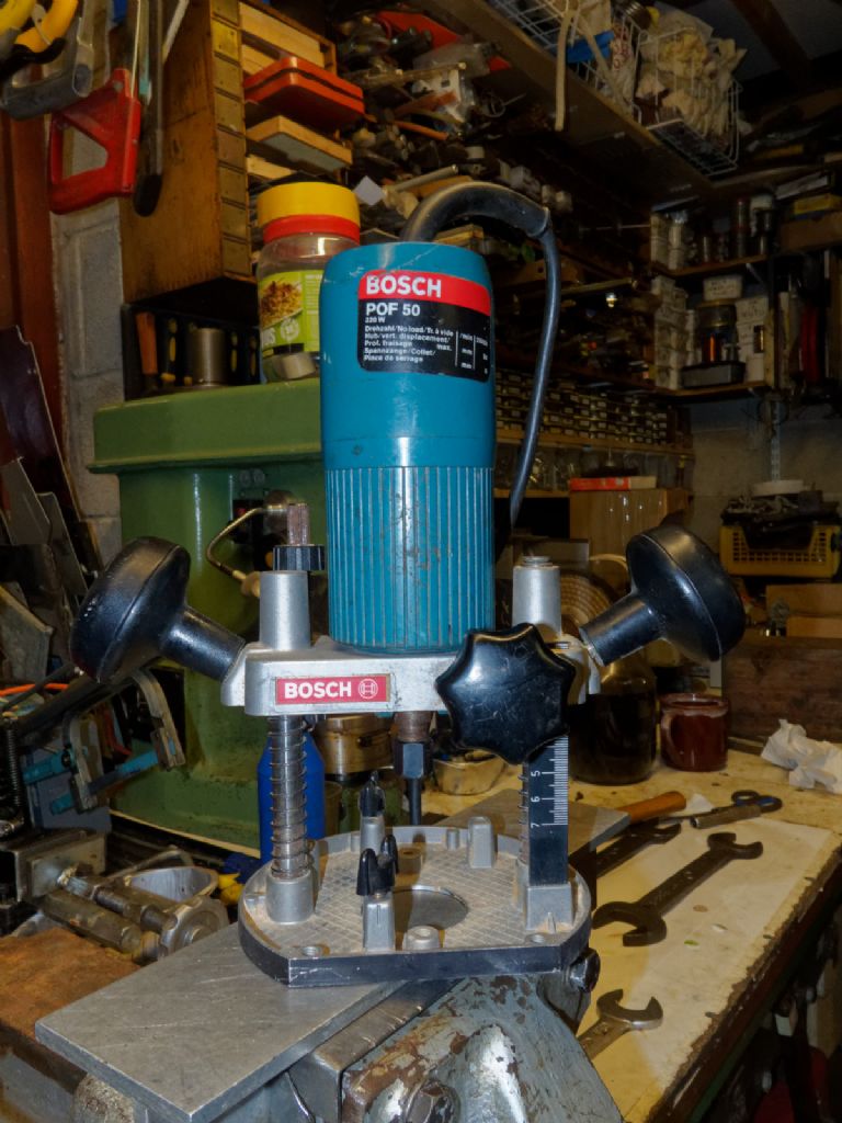

                  Posted by Sam Lawrence on 25/02/2020 12:45:34:
                  Oh and Google is not my friend for the bosch router, no results
                  Edited By Sam Lawrence on 25/02/2020 12:46:07
                  Sorry Sam, feeling slightly off colour and failed to spot my own typo POF500a not PFF500a
                  There was a whole different range of similar models over the years, all with detachable motors.
                  I've a POF50 and a POF52, which is green and a slightly higher wattage
                  This one's the POF50 in normal config.
                  And shown on the lathe (Warco 720 Super 7 copy)
                  Just a quick lashup to illustrate the idea, seen here with a 5mm router bit.
                  The mounting plate is simple enough, just an alloy sheet with a tenon to fit the tool holder.
                  It was originally made to fit a different toolholder before I got the Dickson type one, which is why it looks a bit clumsy on here, but you get the idea.
                  Bill
                  Edited By peak4 on 25/02/2020 20:31:36

                      Sam, in the example I lashed up above, with the router, it would be normal to advance the router along the bed using the handwheel/rack for parallel slots, or the topslide for slots which aren't parallel to the axis of the chanter.
                      The headstock can be locked by various means, but for most of them, the carriage couldn't be advanced under power from the motor.
                      It's possible to fit various forms of dividing or indexing heads to the main spindle to both lock and position it, but the carriage advance would need to be by hand, which shouldn't really cause a problem. e.g. The Hemmingway attachment
                      The only way I can think to drive the carriage with the chuck (as opposed to whole spindle) locked, is to disengage both the backgear and the backgear driver crescent. This would allow the main spindle to spin, but disengaged from the chuck. The chuck can then be indexed on a jaw, and a block of alloy resting on the bed. This would give 3 way indexing on a 3 jaw or 4 way on a 4 jaw.. With a bit of thought you could probably double that up to 6 way with a 3 jaw.
                      Alternatively, if your chuck is on a backplate, a series of holes in it's periphery and a peg to engage them, should provide lots of other options.
                      Bill
