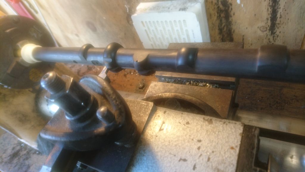

      Hi. I make wooden things for a living, and do a lot of work with non-ferrous. I'm finally going to get myself a "proper" lathe, I'm thinking ML7 size. I need a distance between centres of at least 19".
      I have a question – is it possible to have the headstock stationary, and use the lathe motor to move the carriage from side to side to cut keyways in hardwood? My hands get v tired moving the compound slide around on the ML8. If it is possible, is it possible on a ML7?
      The ML8 is cutting the slots slightly uphill, which is no good.
      The other thing I need an engineering lathe for is making tapered (mainly) reamers. I'd also stop turning my brass on the ML8, although it does work surprisingly well for this with the compound slide, and I have made accurate conical reamers from mild steel too.
      I missed out on a ML4 though tbf I thought it was just a bit too old skool. That was £310. I can't really go higher than a £1k, which would have to be for a solid machine needing little or no work.
      I'm not buying new, also can't be a massive heavy thing.
      What should I look at?

          Powered feed on a lathe is normally driven by the rotation of the spindle and therefore a chuck fitted to the spindle will rotate as well. There are a few ways to overcome this for your needs, mount the workpiece between centres and use a clamp to stop it from moving (omit the lathe dog that would usually be used to turn the workpiece) is the simplest. Alternatives are to adapt the lathe with something like the electronic leadscrew (ELS) or to go full CNC. I think the second two are probably something you don't want to do.

            Hello Sam,
            One way I might do as you are asking is to power the leadscrew alone, probably better done with a second drive and leave the headstock un-powered. It isn't difficult to isolate the gearing up to the headstock, just take one of the linking gears out when you run things that way.
            The new drive could also be readily arranged so that you still retain the option of using the lathe as the makers intended.

              A lathe with backgear can usually isolate the spindle from the leadscrew, and if you can lock the spindle, you're halfway there. A lot of Myfords have a handwheel on the right hand end of the leadscrew. The requirement for 19" between centres is more of a problem, I'm not sure about that.

                    For the keyway in the hardwood why not make a jig and use a wood router to cut it should not be too difficult.

                                Instead of racking the carriage back and forth you can convert the top slide into a slot cutter pretty easily. All it takes is remove the top slide feed screw and set up a long handled lever that pivots on a tower sticking up from the rear T slot in the cross slide and is attached with a link to the moveable top slide by bolting to the toolpost. Much easier than racking the carriage. You could even conceivably motorize the top slide with a stepper motor or motor and crank etc.
                                Or for wood, get a cheap router motor with integral collets and fit a cutter and mount it on the toolpost and use it to rout/mill the slot instead.

                                  This is what I'm actually doing, there can be up to 8 key slots on a chanter. I really don't like the idea of having to do this on a mill – I do possess the ability to mill and do cut slots in drone reed bodies using a cross slide on the substantial pillar drill. I know a milling machine is more accurate than this, but the clamping problem remains the same.
                                  A milling machine would be useful for removing the stock on the D reamers, but not essential.
                                  I can't see how I'd fix even a laminate cutter here and have the bit at centre height. Other makers I think use a dremel, or the remote flexy thing and mount that.

                                      When my hands are sore, I start the slot, then saw slightly inwards on both sides and knock that bit out – this leaves the tool v little work to do and I could maybe then remove the feed screw if I always did that.

                                          Here's another way of convertiing your topslide into a slot cutter.
                                          More detials here http://www.myford-lathes.com/accessories30.html

                                                Now that you've posted a picture to clarify what you are trying to acheive, I'll throw in my suggestion. Wouldn't something like this be a solution:
                                                Spindle
                                                mounted horizontally to the cross slide or topslide at centre height and traversed longitudinally with the carriage leadscrew or even manually using the cross slide handwheel?
                                                I think you mentioned 3mm slots, so it should easily cope with that and the advertised speed would be ideal for use on wood at those dimensions. You would of course end up with round-ended slots, but that 's not to say they couldn't be squared off, if that is what is required?

                                                    Similar to John Hinkley's comment above, but with most of the engineering already done.
                                                    Do a search for Bosch PFF500a router. There was also a slightly smaller blue model, 350??
                                                    The router body/motor has a standard collar size and will also fit drill stands.
                                                    I made a flat plate to fit in the toolpost of my Myford to take the router body, so I could use it as a basic toolpost grinder, but there's nothing to stop you using a normal woodworking router bit.
