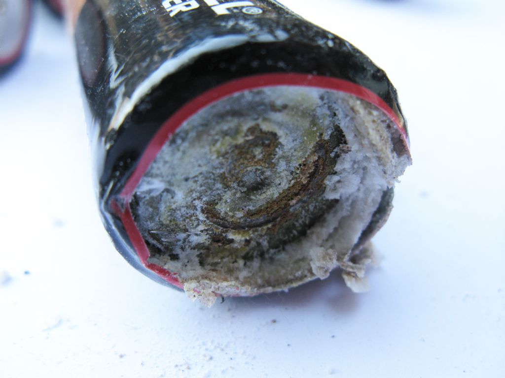

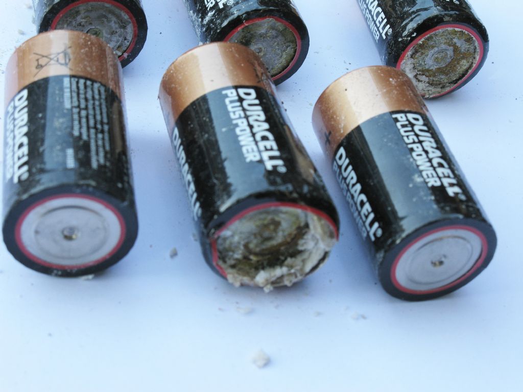

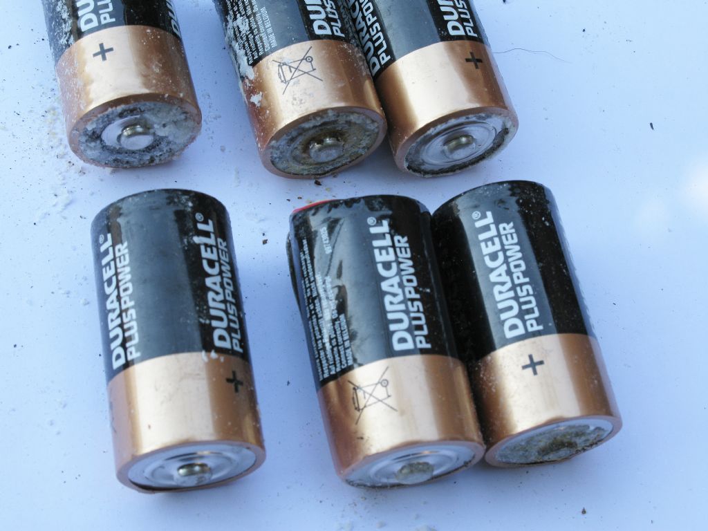

        I got a Thander battery frequency counter, worked OK in the past, I put it on yesterday, worked fine then 'zilch' the six C size Duracell batteries had leaked – looked like a snow drift, it'd been on about ten minutes! One of them the bottom was completely gone!!!! Thank goodness they are enclosed in a battery case, protected by a aluminium screen underneath there was no damage done.
        The very first time I've seen a Duracell leak, I also have a matching scope that runs on 4 C cells, these and other equipment was given to me by a pal many moons ago….. funny thing is this scope hadn't been used for about four years AND the batteries was still good and lasted another couple of months after usage.
        Why leak now I ask? Mind you I fitted them about two years ago and the last time I checked they was OK and no signs of leak.
        I thought Duracells never leaked…. and now my trust is fading.

                  The mess from the leakage can be cleaned up with either white vinegar or citric acid. You can obtain citric acid in fine crystalline form from eBay or (in virus-free times) from some food suppliers. Maybe also from other web suppliers. Dissolve in warm water and apply with a brush or a cotton bud. Wipe away with a piece of kitchen roll and rinse with plain water. Dry by brushing on methylated spirits, surgical spirit or vodka!
                  Best regards,
                  Swarf, Mostly!

                    I always smear the terminals with Vaseline before installation, and this seems to prevent the corrosion.
                    Howard

                              Several years ago the addition of mercury to batteries was banned. The old Duracell and Energizer alkalines had a small amount of mercury which aided recombination of hydrogen which is produced in the cell. Thse cells had a leakproof warranty. When the mercury was removed so was the warranty. The mercury free cells tended to leak even when not left flat. In the last few of years they seem to have solved the problem. Certainly in the USA Energizer have brought the warrty back. I have 20 year old cells that are fine but 5 or six year ones that have leaked. Recent ones seem to be OK for both brands.
                              Robert G8RPI.

                                            Well, like I said I was gobsmacked 4 had been in the 'Oscilloscope' for over 4 years and they worked for a while after that…. but these in the counter are the one's I put in…. the thing worked awhile then 'zilch', opened it up looked like a snow drift with white crystals I took one cell out and it had no bottom, I could see inside as it had dissipeared.
                                            The whole lot cleaned out easily with isopropanol and was well protected… wouldn't like that happen to my Canon A640 camera, just going to have a rethink here.. If I can think on I'll look Big Clive up see if I can find the review.
                                            Thanks for all the reply's, if I come across anything interesting I'll post back…. stay safe.

                                                    These actually worked for about 10 minutes…..!
