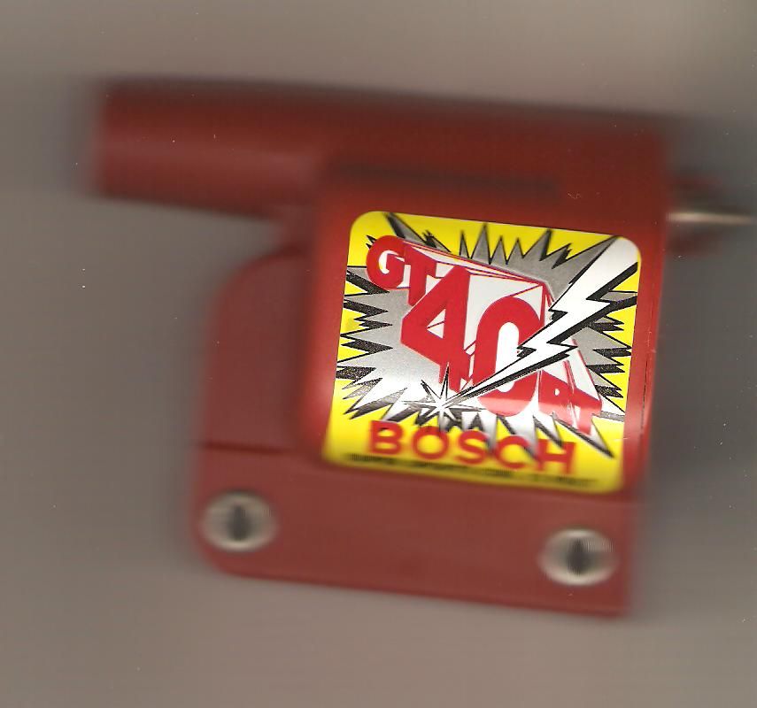

                                        guys in australia building model engines often use the Bosch GT40RT coil. it is quite small compared to the canister type coils
                                        this was just placed on top of my scanner a moment ago to show you.
                                        those silver eyelets are 5cm centre to centre.
                                        the coil is designed for kettering type points.
                                        it is epoxy filled. they are about $59 Supercheap auto in australia.
