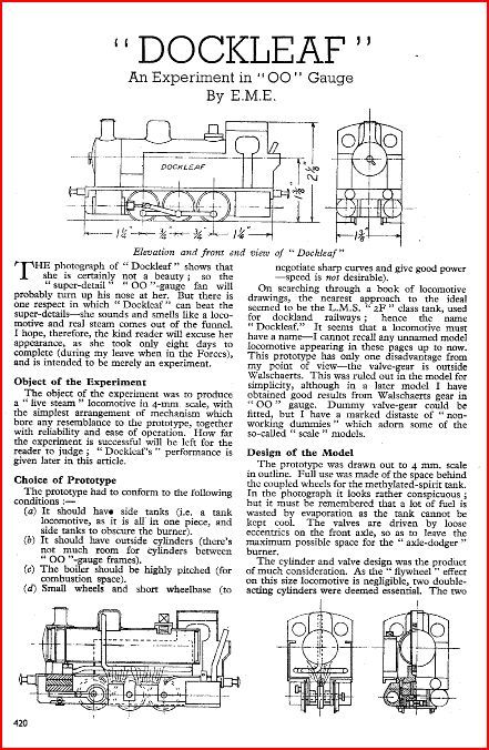

          Try ME 2393 vol 96

            Many thanks for your quick reply to my request – it is exactly what I needed to identify the loco so far as it currently exists. Can I ask for a favour – do you have the rest of that article? a bit cheeky to ask, I suppose, but anything else would be most welcome!

              Dockleaf was a one-off, as far as I know, unless someone else decided to make one of their own using gathered together bits.
              If Jason hasn't got the other two pages, I can scan them. the only other dawings are a sketch of the cylinder block and a section through the valve, plus a fairly poor photo.

                Seems to be largely cut by hand from brass, cylinders are from brass block, as are pistons. It is 4mm scale, so only 3"long x about 2" high.
                If Jason can't let you have the rest of the article, send me a PM with your email address and I will send you a pdf file – 3 pages – I have one already.
