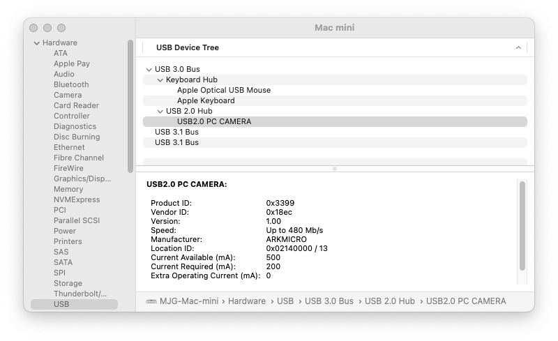

        In easy stages:
        The Mac mini has two ‘Thunderbolt’ ports [of no relevance to this discussion] and two ‘Type-A USB’ ports, which operate according to what is connected to them.
        My keyboard and mouse are in one port and, for the following examples, the other port is used directly [i.e. without any external hub]

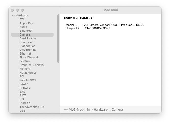

        Here are the relevant panes when a common little UVC webcam is connected:
        Chapter 2 to follow

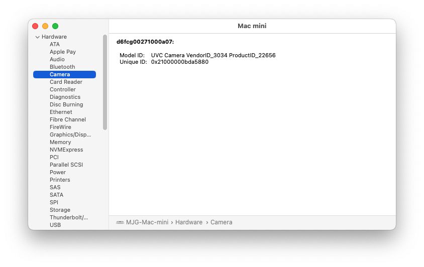

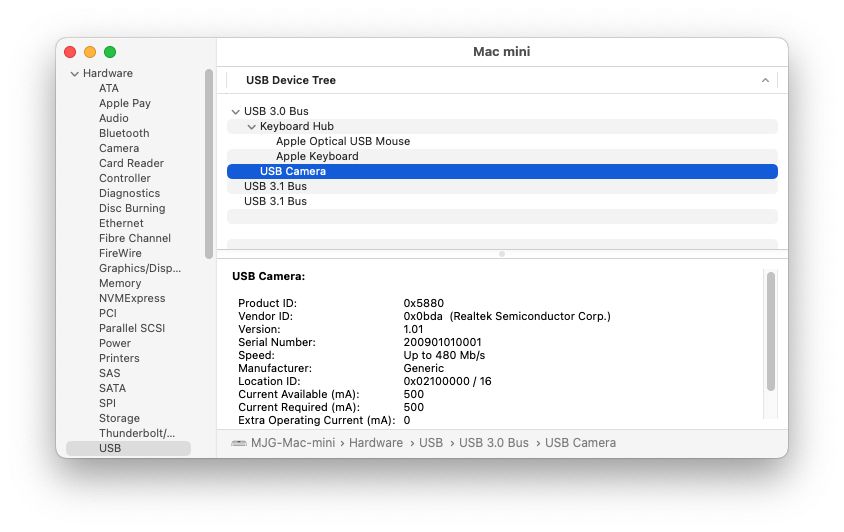

          … and now with the Visualiser device connected :
          Chapter 3 to follow

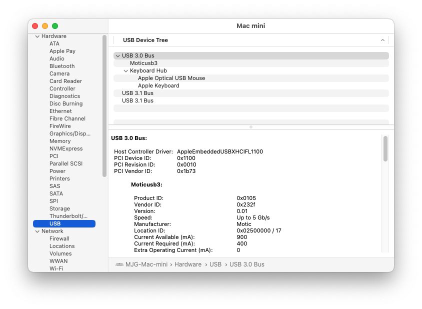

            … and finally … here is the USB pane for my Microscope Camera
            [ which is a proper USB 3.0 device ]
            Note: it does not feature in the Camera pane, because it is not UVC
