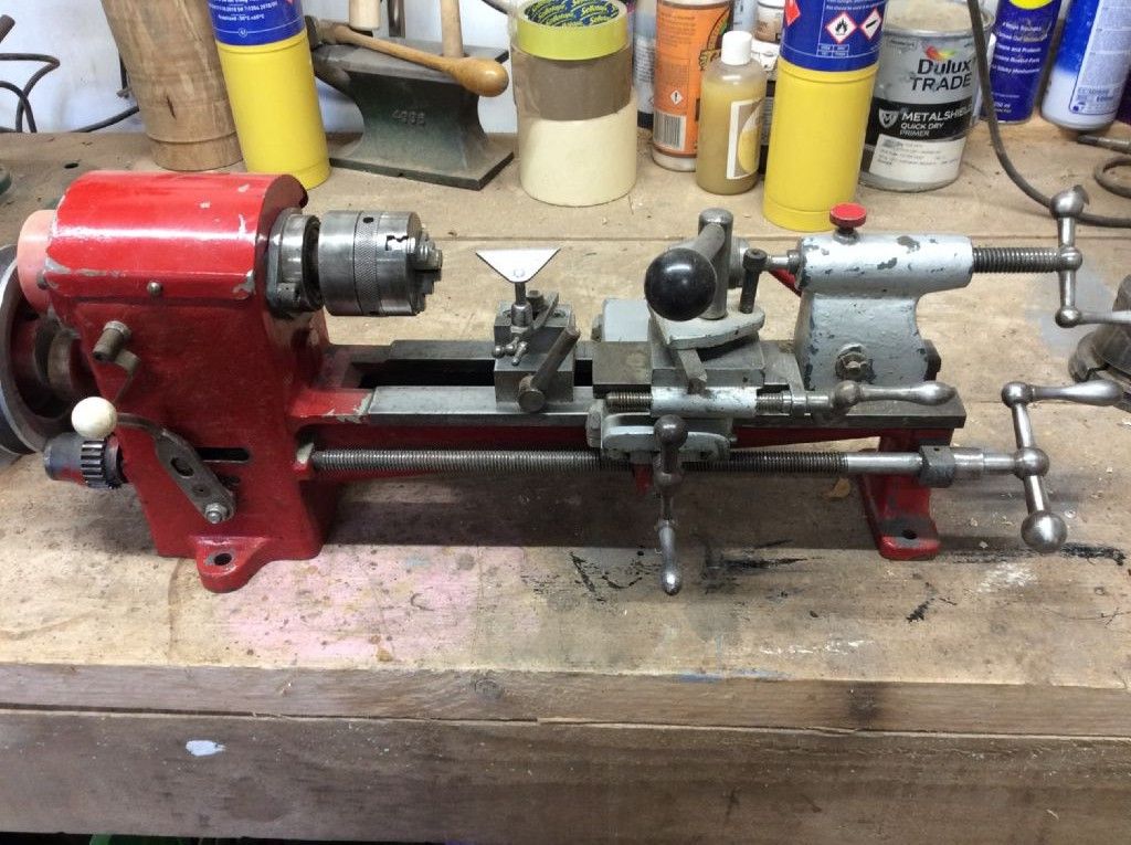

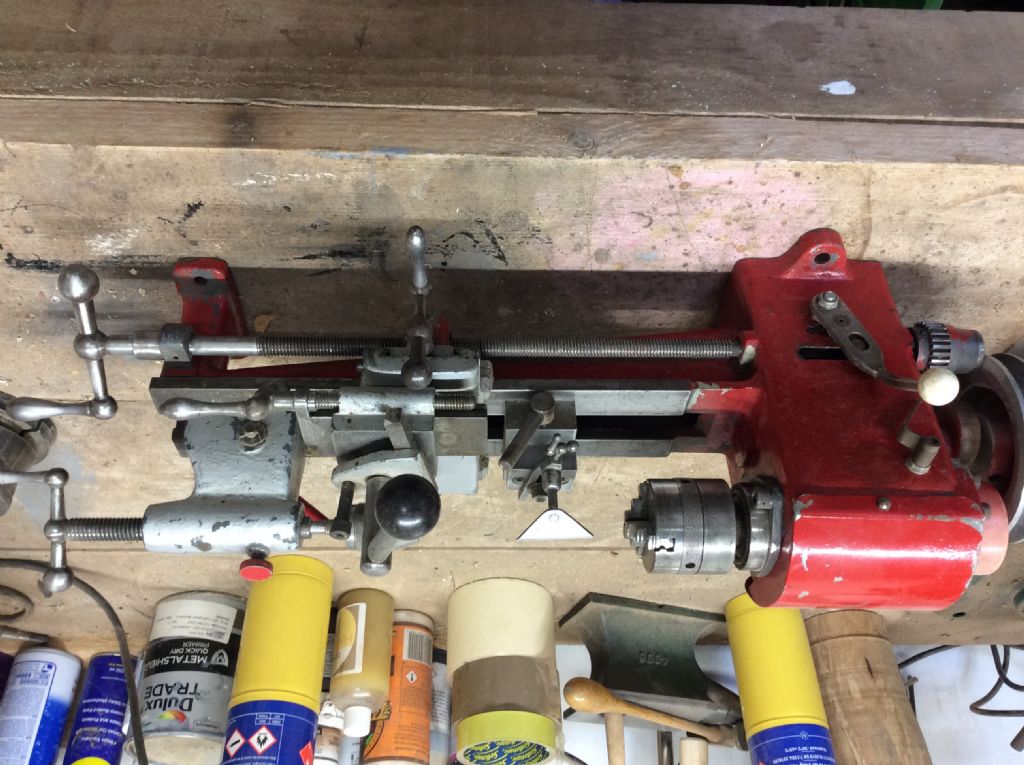

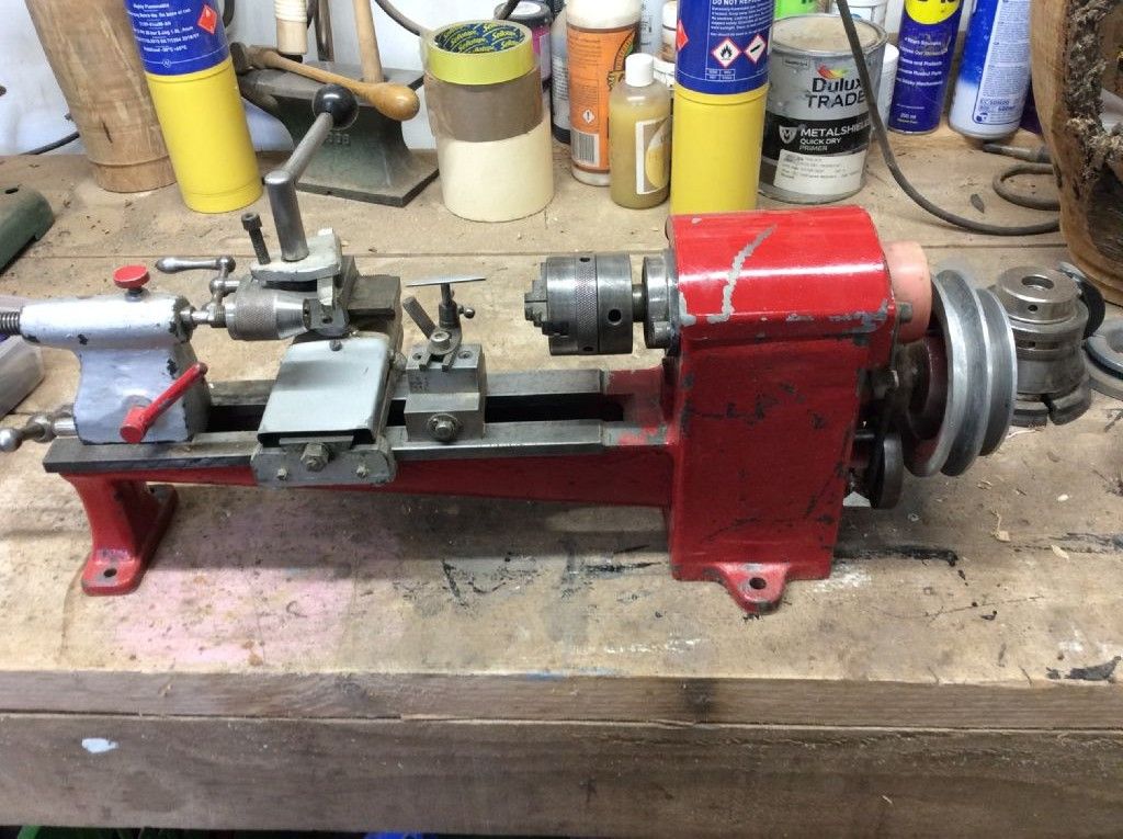

      Trying to identify this small lathe – 2.5” from bed to centre, 6” between centres and 22” overall. Would like to get it running and cannot see a makers name anywhere,

          I thought "Rollo Elf" as soon as I looked at it but it's not a common version
          The offset spindle drive is the sort of thing they did
          The tailstock may not be the original?
          Certainly looks like a nice little unit
          I've put the photos the right way up

            Thanks, I will try to trace it’s original maker and thanks for turning the pictures around for me ! Any idea of the motor rating that would be suitable for this? I was thinking of 1/2 hp

              I would have thought that 1/2hp would be overkill for this little lathe. Probably 1/4 or 1/3 hp at most.

                As Oldiron says 1/2 hp would be overkill, I used to have a little Lorch screwcutting lathe of the same centre height, this had it's original factory fitted motor which was 1/4 hp three phase. I believe single phase machines came with a 1/3rd hp motor. That never seemed lacking in power and could run up to quite high spindle speeds.
                Interesting little lathe you have there, well worth getting up and running.

                  This neat machine does not seem to resemble the Rollo lathes depicted on that site, and certainly not the Portass I thought it might be, having seen an ad for those in an old copy of "ME".

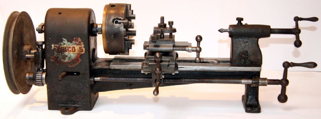

                                  Hi Folks, I’ve spoken to Tony at lathes.co.uk ( great bloke ) and he has identified it as a Damco. Looks like it was made in the early 1900’s The chuck on this one seems a bit big 29e13a0b-1882-4997-ba13-5a11eae02aa5.jpeg

                                    Very cool. Yes the small chuck on yours looks more appropriate.
