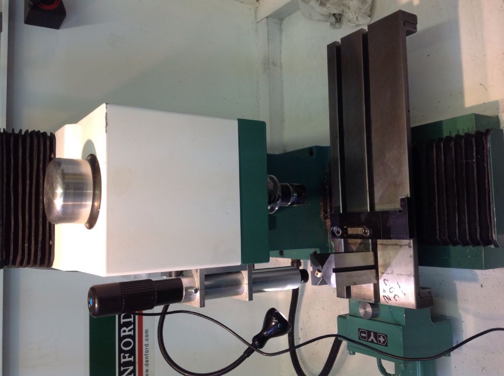

                              image.jpgI have just uploaded some photos to an album called Microscope showing one that I have fitted to my Novamill. Unfortunately the forum software doesn't seem to allow you to rotate the images! Above is one showing the microscope fitted via a bracket on the side of the mill head, viewing a tc tool tip sitting on to of a vee block.
                              the basis of this was an Aldi special buy which was quite a nice mic with a couple of eyepieces and a 4 lens turret, but also with a USB eyepiece that you can use to view or capture the image on a PC. I removed the lowest magnification objective and fitted it in the bottom of a piece of aluminium tube (part of an old bicycle seat post that fractured), with the other end bored to take the USB eyepiece. I think the photos are self explanatory. I think this is a mechanically much more solid arrangement than trying to mount one of the little self contained USB microscopes as these don't have very satisfactory clamping arrangements.
                              you can use the software that came with the microscope, or Centrecam, or as in one of the photos in the album the Mach3 video plugin. The picture shows the image of the tool tip. Using the table jogging you can focus the microscope, and move the object by precise amounts to measure it or calibrate the graticule.
                              I've only seen the microscope once in Aldi, they don't seem to be regular items, but I guess they may be available from other sources.
                              #144112
                                Neat installation, John
                                Nicely done!
