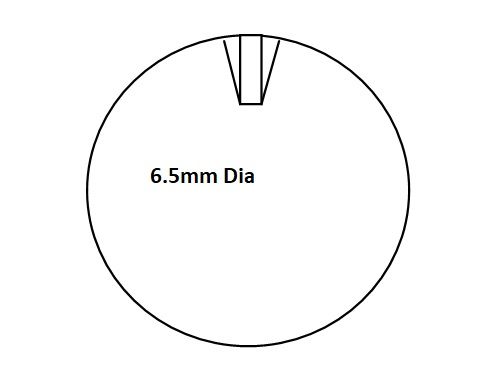

      Hi Guys,
                 Using a fly cutter to cut a clock pinion is not an easy task on higher carbon steels. I am told it is a good idea to remove as much metal as you can before using the cutter.
      Using a slitting saw achieves some removal.
      However what I am looking for is an economic way to remove metal after the slitting saw to leave a chamfer which the pinion cutter can hopefully finish.
      There are several possibilities and I have a rotary table so can rurn the stock as needed.
      My ideas off the top of my head
      Dremel diamond disk used on Sherline mill. A purpose made fly cutter just for hogging out. A chamfer bit (but is expensive) A double angle bit (is expensive), a rotary burr.
      What do you more experienced guys suggest (apart from buy a Thornton's cutter).
      Chris
      Edited By Chris TickTock on 24/08/2020 17:13:55
      Edited By Chris TickTock on 24/08/2020 17:14:18
      Edited By Chris TickTock on 24/08/2020 17:14:52

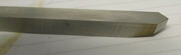

        #492343
          Simple single point tool in a homemade holder. Tool can be ground from broken ctr drill or milling cutter shank if you don't want to buy a HSS blank. Holder is just a bit of round steel bar, cross drilled for the toolbit and tapped at the end for a lockscrew
          Edited By JasonB on 24/08/2020 17:22:34

            Try making two angled passes per tooth, this will leave you next to nothing to remove with your flycutter. If it is so difficult for you to make a pinion why don’t you make a lantern pinion instead? Lantern pinion only involves turning a cotton reel shape and drilling a few holes and poking a bit of pinion wire into them.

            Chris TickTock
              @christicktock
              Posted by JasonB on 24/08/2020 17:22:11:
              Jason,
              No need for me to make the holder as I can use the HSS blanks I have in the fly cutter holder. I think this may be the easiest solution …thanks for post.
              Chris
              Edited By Chris TickTock on 24/08/2020 18:07:24

                Posted by Baz on 24/08/2020 17:26:12:
                Thanks Baz, I am making a pinion purely to know how to and in doing so trying to look at best options. The lantern pinion is for another day. I am told making a pinion from high carbon steel is difficult especially with a fly cutter. Part of the fun is finding the best way to tackle a job, given I am a man in his shed economics comes into play.

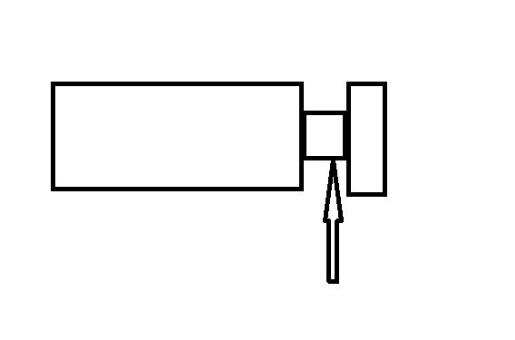

                                                #492486
                                                Chris TickTock
                                                  @christicktock
                                                  Upate: Making a 90 degree cutter from HSS was much easier than I thought . Will see how it cuts but it opens the door to making numerous other cutters. Picture attached
                                                  whilst on the subject I came across a video of a man cutting a lantern pinion. he was cutting between 2 shoulders with what looked like a wider parting tool. I should add the distance between the shoulders was approx 15mm so not possible I think  with right or left handed as you can imagine. Can anyone help out with the shape of a cutter to make as in diagram.
                                                  Chris

                                                    #492507
                                                      Chris the easiest way to form that shape is to use a parting tool and make a series of plunge cuts to just over the required diameter, you can then move the tool from side to side taking off very shallow cuts to get down to the finished diameter. On a small pinion I'd be using a 1mm or 1.5mm wide parting tool
