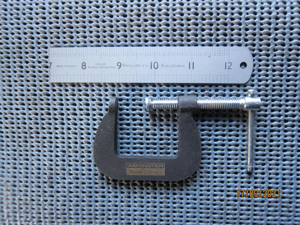

      I have recently acquired a couple of small (1.5" throat) G-clamps fitted with an 8mm dia screw which need to be reduced in overall length in order to fit under my limited height milling table. The obvious way of achieving this is to shorten the screw from the tommy bar end but it has prompted the thought as to just how one might go about making up a replacement screw complete with a new swivel foot. Has anyone had a go at making up their own swivel feet?

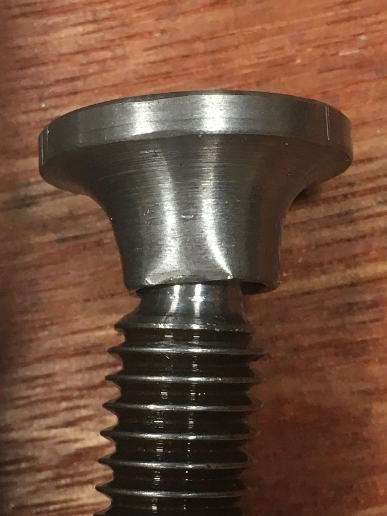

          Yes ! I made a batch up a while ago for some much bigger record clamps. Used something like 1"round bar, Machined the shape and bored a hole to fit the ball end. This bit was the length of the ball diameter and of a suitable thickness, maybe 1mm. Part off, fit on ball and peen over the edge to keep it on the ball. Hacksawing 2 or 3 slots may be needed to get the peening to work. Good luck, Noel.

            Same as Noel, did several a while back pretty much the same method. Don't forget, the peened over bit doesn't need to be excessive or a precise fit – as long as the foot is retained, that's all you need.

              I used some nylon bar, drilled out 8 thou less than the ball diameter and then used a round nose boring tool to make a snug fit for the ball end. Conventional shape for the rest of it and then part off. It has the added advantage of not marking the job.

                You could put a saw cut across the socket to make crimping easier.

                  But I see no need to bore the hole, or do anything fancy for the bottom. I just use a normal drill bit to make the hole a sloppy fit over the ball at the end of the screw and peen the new part in place.

                      I made several for a vice clamp, used a form tool to make the ball then made foot to suit with a drilled , nothing fancy. Do make sure the “neck” on the ball is long enough so the foot does not foul when it swivels. To hold in place close the clamp onto a suitable piece of material then with the material held in the bench vice peen over the end of the foot. I just gave a couple of strikes with a punch on either side but you can work around the top for abetted looking finish

                                Some time ago I made one for a 9" record. A bit crude but soldered a piece of copper to a short length of plumping copper pipe. The cutting tool for the pipe rounds it over making it a tight fti over the ball. Still in use after many years, didn't expect it to be as durable as it has been.
