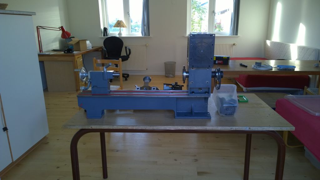

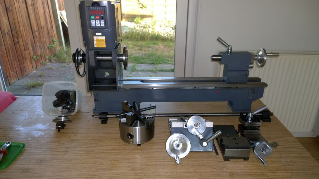

        My planned WM210 uptodating can have a 27 mm bore spindle with taper for ER40 collets and screw on thread using the ER40 locking ring .
        The collection of kit parts is almost complete:
        MyBoFoBane
        KitBack
        This produce  surplus:
        Surplus
        The parts have only done the flange slimming .
        Are there enough spares around , can they be used or are they scrap food?
        Coming from and going back to China.

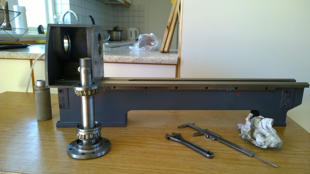

            It has been very easy to dismantle headstock and it will be easy as wel to put in a much more rigid spindle.

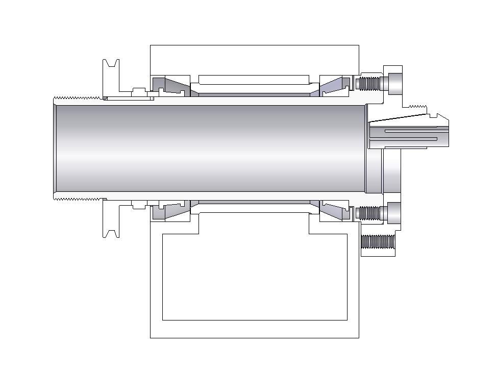

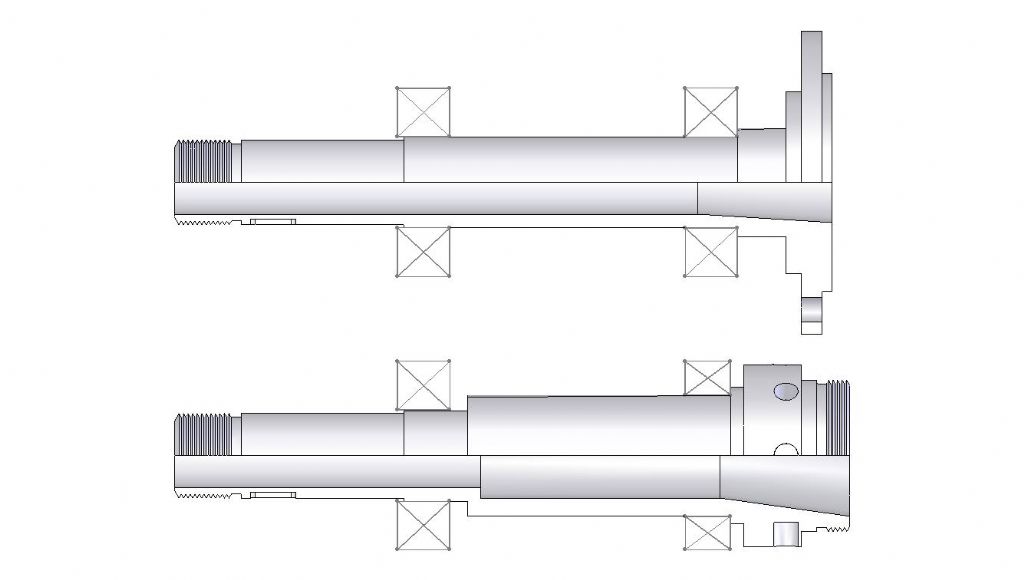

              I have made a new design for WM180 and 210 lathes:
              Upper is standard MT3 and lower is for new ER40 collets.
              The front bearing goes from type 30206 (30*62*17.25) to 32908 (40*62*15mm).
              Beaty is that no housing modification is needed

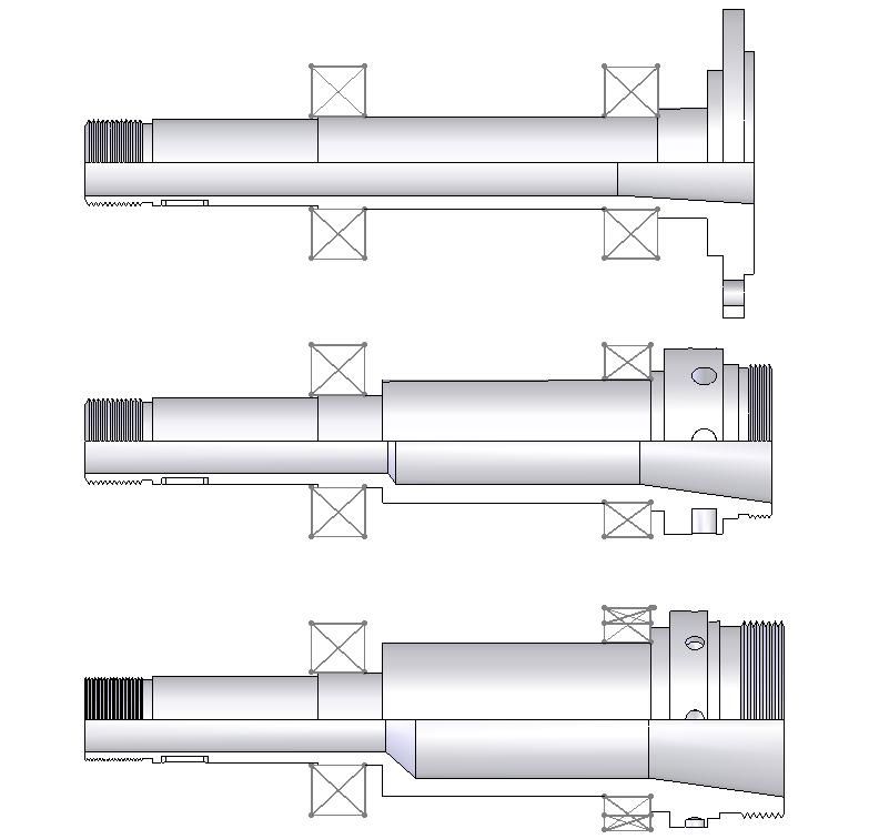

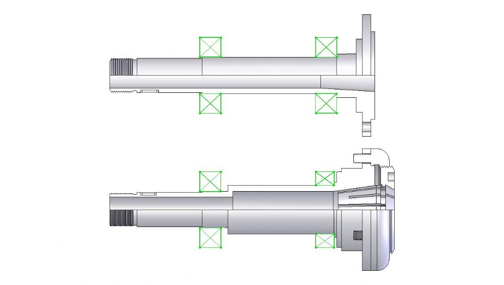

                My toolmaker friend has fallen in love with my former WM210 lathe and is blueprinting it.
                I have bought a WM180 and will get it on friday.
                He thinks he can rebore the front bearing hole in headstocks from present 62 mm to 72 mm diameter.
                In that case a 50*72*15 mm tapered bearing will enable an ER50 spindle.
                I want to keep the rear inner diameter of 20.5 mm to avoid the temptation to do water pipe threading and worse.
                Lathes are only 60 kg.
                Picture shows present ,ER40 and ER50 versions
                Waste of money maybe but more fun than TV.

                  Niels,
                  Thanks for keeping this thread alive. I have a feedback for you. The torque required to tighten ER50 collet's is considerable. Especially squeezing them down to the lower end of their 2mm closing range. This is based on my own experiments with some second hand regofix ER50 28mm, 30mm, and 32mm collets and a regofix ER50 ball bearing nut. you will need a very secure spindle lock on your design. Oversize collets are available for ER40 utpo 30mm. Something to think about.
                  I have recently come in to ownership of a small hardinge UM mill from the 1940's. Saved from the scrap man. Unfortunately this "lucky" find comes with a 5C (!!!!) horizontal mill spindle and no tooling. I am looking to design and make a new 30 taper spindle for it. So please keep posting your thoughts!
                  Steve
                  #369426
                  Niels Abildgaard
                    @nielsabildgaard33719
                    Hello Steve
                    Thank You for a very good advice:
                    Old men do not have the power for ER50.
                    My experience is ER25 and pleasant, but ER50 is four to eigth times more demanding.
                    Had not thougth of that.Will try ER40 then
                    The eigth radial holes on thickest part of my phantasy spindles are for locking during chuck and collet nut handling.
                    The Hardinge UM looks very nice.Do You have a parts list picture?

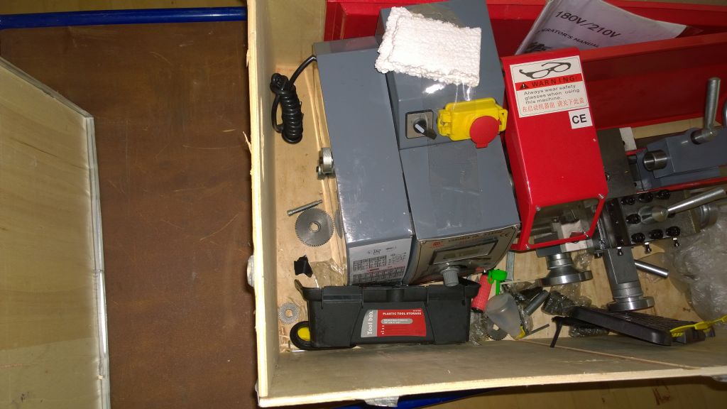

                      A WM180 travelled all the way to Poland and then to 50 meter from my door.
                      The danish/arian looking driver dropped it by accident and left very fast.
                      I have to wait with an absolutely scrap lathe in my small appartment to sometime next week .
                      Time for reflection evidently.
                      The bigger inside,same outside diameter frontbearing make a more usefull spindle possible.
                      All the mini lathes has the same 62 mm bearing hole as far as I can deduct.It can also benefit 918,RedBull ,Siegs etc and the manufacture of new style spindle is not more costly than the present versions.It can still fix the standard3 and 4 jaws plus faceplates and I like the flange mounting after widening the gap 5 mm.
                      Please look at it and tell me if there is something wrong or impossible.

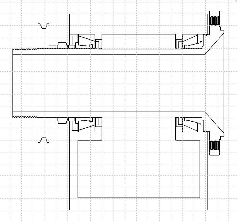

                                  I have come to the conclusion after reading the late,great John Stevenson and having done some practical tests my self, that my chucks will be fastened with three or four M6 or M8 screws from front.
                                  Short and very rigid.
                                  Extreme accuracy by machining spindle register on site
                                  For my former 30mm hole spindle it should have been made like this:New spindle
                                  Edited By Niels Abildgaard on 08/11/2019 19:10:29
                                  Edited By Niels Abildgaard on 08/11/2019 19:31:29

                                      Most three jaw rear mounting scroll chucks can have the holes drilled through to the front. If the original holes are 8mm, then drill them 6.2 through to the front and counterbore them for 6mm SHCS. You will find that is is possible to drill another three holes on the same pcd, usually so all the holes are spaced at 60 degrees, ( check first though for space). SIX holes are plenty for your threaded flange. Four jaw independent chucks are commonly front fixing and would be easier.

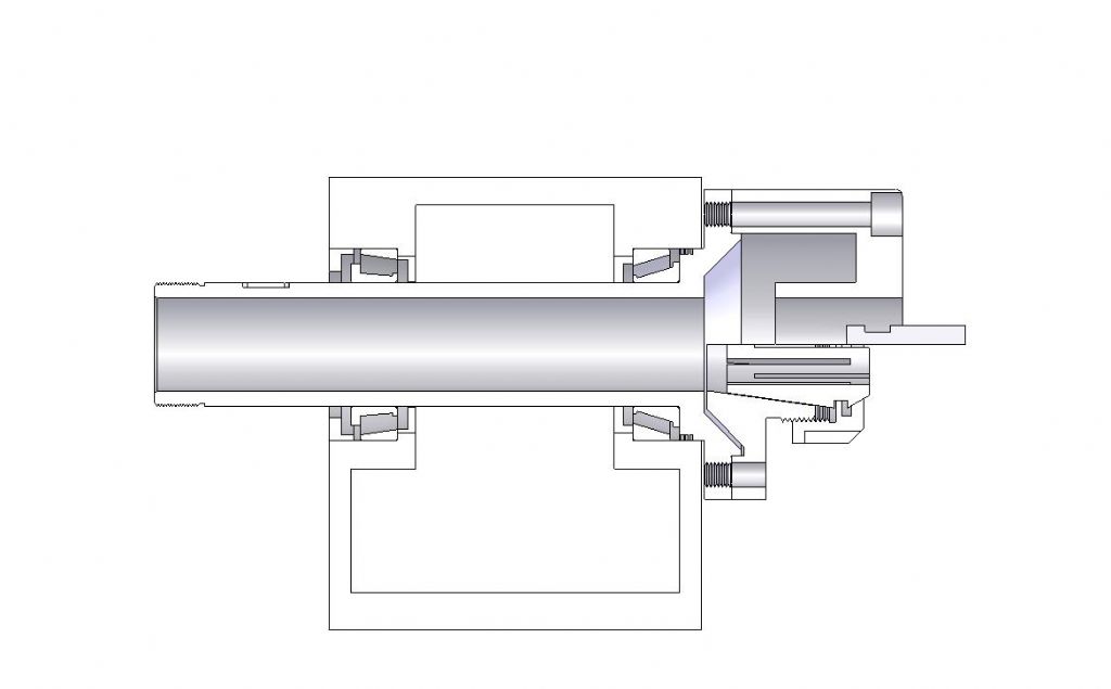

                                      Niels Abildgaard
                                        My latest 8*16 import lathe spindle phantasy:
                                        Buy one of these.:
                                        38mm bore lathe
                                        and two 32912 bearings and make a spindle with 50mm hole and max88mm nose as picture.
                                        You cannot buy suitable 3 or 4 jaw chucks with 50mm hole and is not really needed either.
                                        Everything round up to 38mm is handled with ER collets.
                                        Bigger and square by Harold Halls very nice faceplate /clamp combination.
                                        Overhang is short and bending stiffnes between bearings is 65 for a 30/20mm ,201 for the 45/38mm as bougth and 671 for the ultimate 60/50mm shown.
                                        Spindle Porn
                                        Edited By Niels Abildgaard on 03/12/2019 18:37:30
                                        Edited By Niels Abildgaard on 03/12/2019 18:39:12

                                          Having a tight tapered fitting is fine in theory, but allowing a small amount of radial adjustment means you can fine tune the runout to zero.
                                          #440074
                                            Posted by old mart on 03/12/2019 19:13:15:
                                            That does not seemed to have bothered the likes of Hardinge who also have their collet taper machined directly into the spindle bore.
                                            #440079
                                            old mart
                                              @oldmart
                                              So do a lot of lathes, including Smart & Brown, they rely on the collets being perfect.
