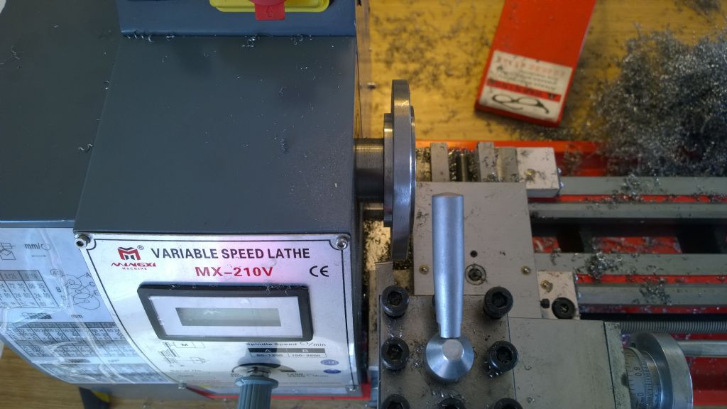

                                          I had an attack of old man feeling fit again and bought a ultra longbed AUD of very late model exported to a Danish school just before Boxford closing time.
                                          Expensive JunkBox
                                          Much to much money and a piece of junk really.
                                          The headstock rocked 0.08 mm from corner to corner and the skilled UK machinist cannot have been unaware as the front headstock clamp had never been tigthened and bed was dry rusted over 50 years.
                                          UK machining
                                          I threw complete lathe out and it was a nice kind of having tried it before.
                                          I have had 5 Allegro station cars, 3 Maxis and a Princess and drove all to the scrapper.
                                          After that I had a Punto and a BMW and had one tenth the trouble and drove two times as long.
                                          I ordered a chineese WM210 and had it delivered in my living room 7 days included:
                                          **LINK**
                                          The toolholder/compound slide is an absolute disaster but the accuracy is astonishing.
                                          There is no needle movement on the testbar shown.
                                          Its first job was to reduce the spindle flange thickness.
                                          How do I unfold pictures from my album?
                                          Edited By Niels Abildgaard on 16/06/2018 20:45:31
                                          Edited By Niels Abildgaard on 16/06/2018 20:47:31

                                                Hello John
                                                Thank You for advice.
                                                After having made the standard chineese cylinder register flange a little narrower in the combat area
                                                fiting and unfitting has become much easier and fast.The  register need not being tapered for me.
                                                I always remove chucks etc end of each sesion.No growing together.
                                                I will make a test rig with the bayonet ring and se if it feels easier.
                                                Am still tempted to make an ER40 nose on spindle.Everything 27mm and less in ER 40 collets and screw chucks,faceplate etc on the locking nut thread (M50*1.5mm) for bigger subjects at lower speeds.
                                                What is Your main dislike with screw on fittings?
                                                Kind regards
