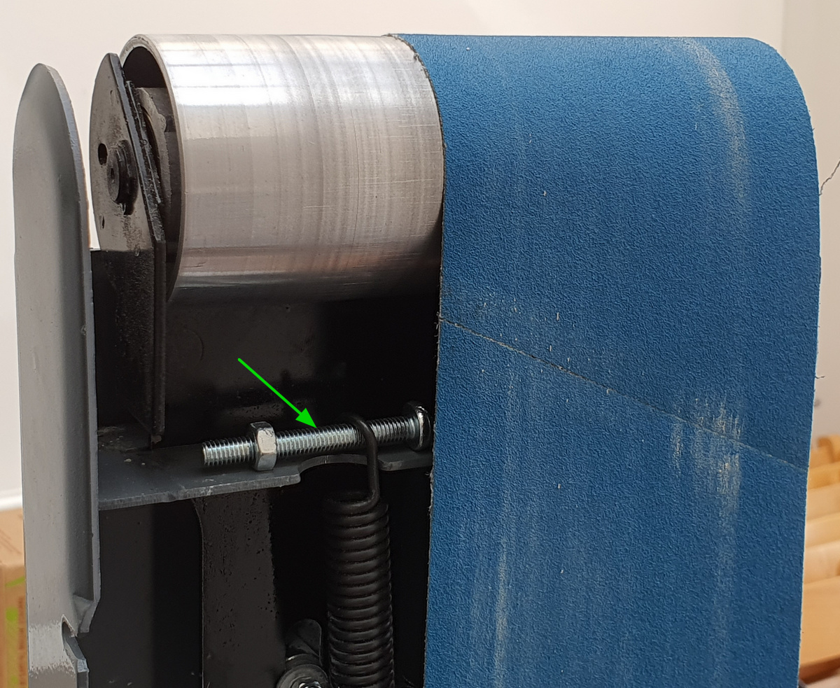

      Fwiw, I have managed to get a bit more tension into the belt by jamming something (a nut & bolt) under the spring.
      ==> The ("915mm&quot belt now lies much flatter.
      I shall report back after I next to some proper work using it.

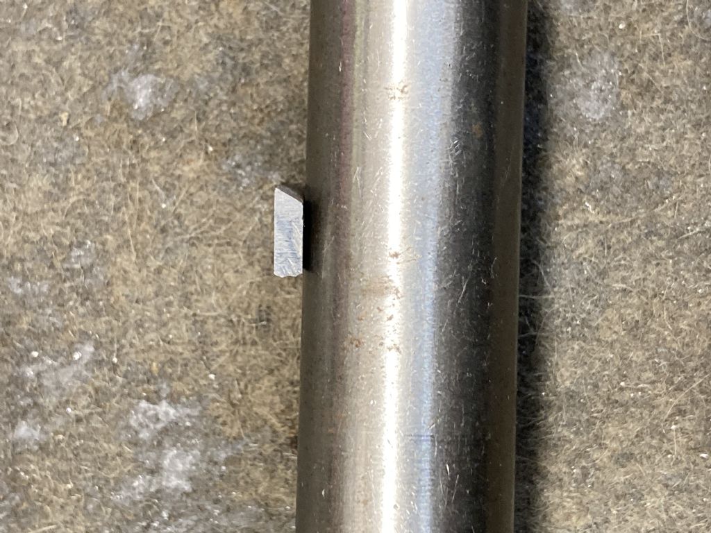

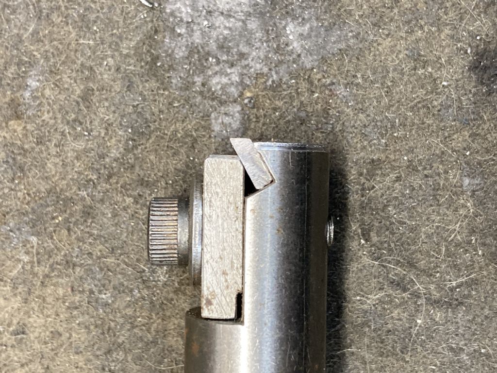

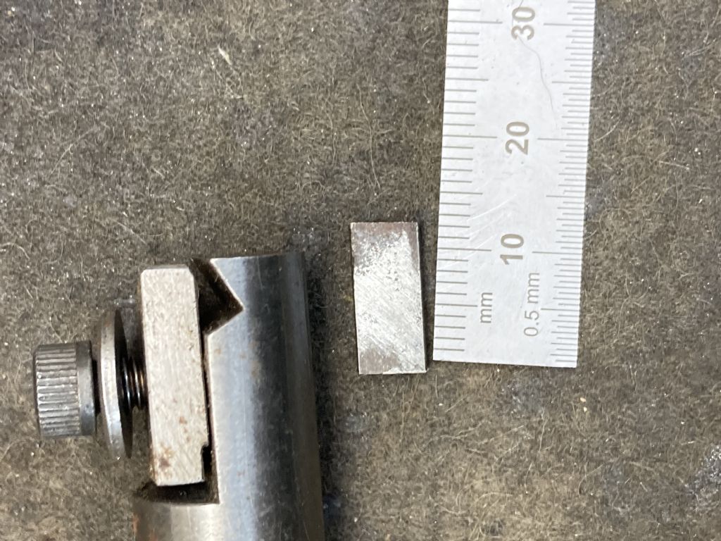

                                JohnF
                                  @johnf59703
                                  A bit late to the party and have not read all the posts but here are a few photo's of a jig I made many years ago to manufacture small dovetail pieces with a 60* angle but you could make one to do 45* in a similar form, I just mounted it in the lathe and took a facing cut, there is a sample I cut tonight to show the result — I did not have a mill at the time i made this but if I was doing what your early photos show I would make a jig to hold several pieces and in a vice on the mill and use a standard endmill. John
