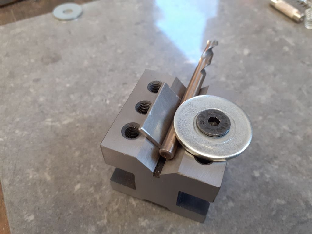

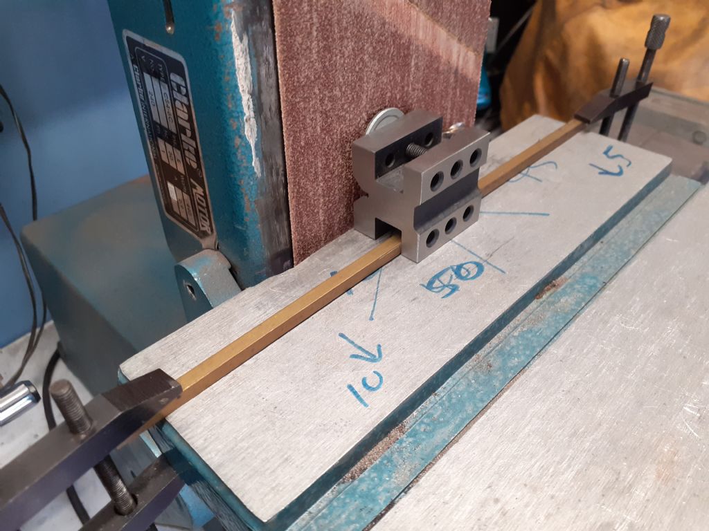

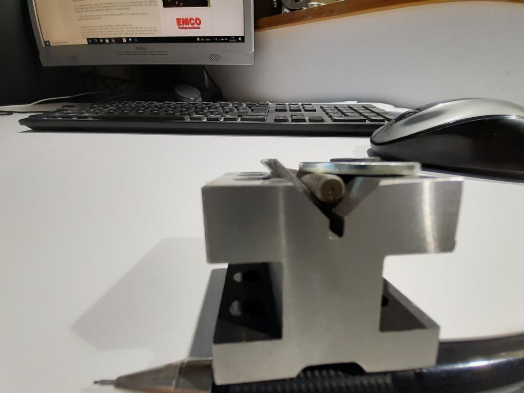

                          well assuming the 8mm was a typo and you meant 13mm as the photos and your earlier thread would seem to confirm then taking John's suggestion a stage further and bearing in mind you don't really have any tools how about this.
                          The Vee blocks that you have, a random round bit of rod, bar or even a drill bit, a washer and a CSK screw
                          Add a cheap Clarke sander from machine Mark odd bit of bar or strip of wood that loosely fits the notch in the vee block and two odd clamps. The bar stops the work and jig going too far and cutting too much off. The table was set at 90deg with a tri-square but a kiddies plastic set square from a geometry set will do
                          Less than to seconds work on the sander once bar position has been fine tuned so say 60secs per item allowing for swapping over in the jig
                          Edited By JasonB on 06/09/2021 18:22:13

                                    Posted by JasonB on 06/09/2021 18:21:01:
                                    I'd need to find screw/bolt with the correct thread… Do you happen to know what the pitch & diameter are?
                                    It's probably time I bought some more clamps too…
                                    But I have to hand it to you, that's darned clever!

                                        M5 Screw
                                        Washer for M10 so the screw sits as low as possible, would help if you ran a CSK bit into the washer or just used the sander to reduce the screw height slightly
                                        Bar or drill about 5mm dia
