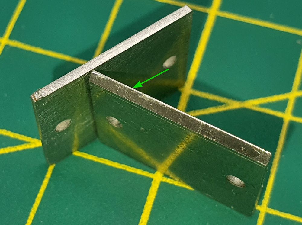

I need to cut chamfers into x64 pieces of mild steel – any advice?

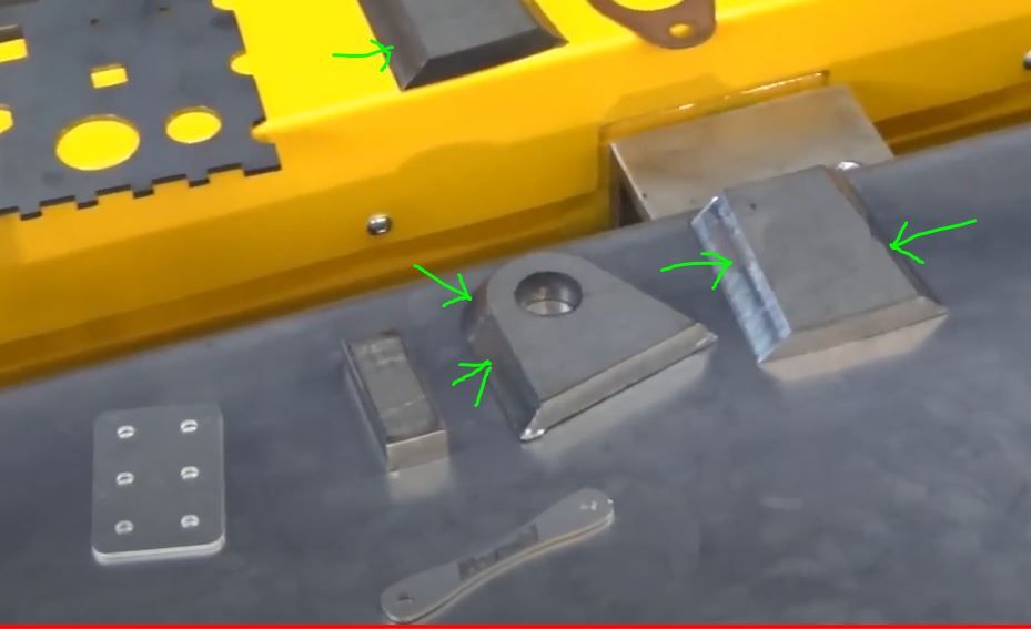

        Pity you did not get them cut by a company with a tilting head laser as they could have done one edge at 45deg. If made 8.2mm wide you would only be faced with flattening the knife edge by 0.2mm and that would be at right angles to the flat face so easier to deal with.

                Put one on parallels in a vice with a vice stop for location. Cut the edge with a 45° chamfering cutter. Repeat until finished.

                      My 2 penny worth, mill if you can or organise a filing set up, I think there is too much metal to remove using diamond laps/hones.

                            wasn't there an existing lack of tools/experience and a small budget?
                            Which makes buying a £100 belt sander, then using it and a few minutes to make a jig the way to go. It also means that the job provides a useful tool for other jobs. The OP could be done before dinner.

                                The parts have holes in them, so coach bolts and wing nuts will make swapping them quicker. And at only 16mm long, the jig could easily hold two at a time.
                                #561207
                                  It seems we are all in agreement that some form of jig is the best way to go with the amount to be made but I fear Brian may have a job making a jig. He was not able to cut bits of metal to 8 x 16 or put the holes in them after long threads on the subjects and has ended up getting them laser cut so a jig may be a challenge with the tools he has or more likely does not have.
                                  If he buys the proxxon it can be used to make a jig with a step to act as a fence, drill the holes for screws or dowels and finally machine the chamfer, can't do all that with manual or mechanical abrasives alone

                                          John Smith 47
                                            @johnsmith47
                                            Thank you so much for all your suggestions. I shall ignore the patronising/snide remarks.
                                            I asked around and everyone seemed to say it was 'impossible' (at anything close to a sensible cost). Does such a thing even exist if so who (in the UK) offers this service?

                                            I don't have a lathe nor a milling machine.
                                            I own:
                                            A) Two sets of Bahco metal hand files (large & small) which are excellent – highly recommended.
                                            B) a dual grit "SHARPAL 162N Diamond Whetstone Knife Sharpener"
                                            This has two sides: Grit Coarse 325 + Extra Fine 1200 diamonds.
                                            https://www.amazon.co.uk/gp/product/B07GRWN1PV/
                                            [I don't like using the coarse side more than necessary as it is already much less effective than it was when new, so I am using metal files to do the bulk of the work… but yes I am using both sides of the whetstone (and lots of lapping fluid)]
                                            C) I also own various out hand tools including jeweller's fine hacksaws, but no machines/desktop machines.

                                            Anyhow, in the end I just make the first parts by hand using hand files, both sides of the diamond whetstone and a heavily customised honing guide. I must have made about 30 or 40 already, but it's extremely time-consuming. Making 16 takes me about 5 hours, i.e. about 13 – 15 minutes each.
                                            Re the idea of buying a sander idea:
                                            A) Any sander would need some kind of "stop", to make sure I don't take off too much material, particularly if I need to make lots of them. Unfortunately most of them that I've seen don't seem to have such a thing built in.
                                            Maybe I would just have to glue a stop onto the table and make some kind of rig out of MDF or similar?
                                            NOTE: Exactly how to make such a rig was behind my original question!

                                              Buying the sander saves you the hassle of engineering a frame, motor and abrasive holder. Some way of holding your workpiece is entirely down to you. Just as it would be if you used any other suitable machine.
                                              Your job is simple: you want to use a machine to turn a 90degree edge into a 45degree one.
                                              They're small parts, and not much material needs to be removed which is why many of us suggested a sander which is far cheaper and easier to use than a milling machine.
                                              All your jig/fixture needs to do is hold the part at the required angle to the abrasive, and have some sort of stop so you don't sand too far.
                                              These machines all come with a table of some sort, which would need to be aligned with the belt to an appropriate level of accuracy. That's just a bit of fiddling with the tool.
                                              I'd do that first, so I could sand a suitable fixture on the machine, saving time and extra set ups. A chunk of timber or MDF with a couple of coachbolts and wing nuts to attach the work and you're almost there.
                                              All that's required is the stop: you could superglue a block to the table and be ready to work in seconds.
                                              I do admire your patience, there's no way I'd have had made as many as you did by hand. The first one would have forced me to automate the job. Or redesign the part; does the entire edge need to be angled or could you just do a few mm at each end and in the middle?

                                                John Hain gave a good idea of how the parts could be held, however this would be very dependant on the size as 8mm won't work but 13mm may well do so in this case size does matter. I even went as far as getting my similar vee blocks out to mock it up for you but could not do it with an 8mm part.
                                                As you don't want to tell us I can't really elaborate further.
                                                yes tilting head lazers will cut angled parts, you will have to look up someone offering the service. Green arrows show laser cut bevels

                                                      Nicolas – yes the part needs to be as photographed and yes, the entire edge has to be angled.
                                                      I am warming to the idea of a small good quality sander. Do you have any specific recommendations?
                                                      I am also warming to the idea of buying that damned Proxxon MF70 as it might be useful for various other small jobs… although it I know it's not very well made and looks like a bit of a toy… but at least it's small and light.
