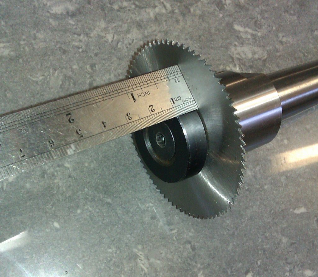

                      Graham if the work is stood vertically in the vice and the mill spindle vertical then the screw type will allow less sticking out, I use the type with a CSK screw which is not shown in teh link you posted.
                      Or you can get stepped ones that will take a range of saw bores.
                      And yes I know what you are all going to say, I've just been down and mocked it up for the photo
                      Edited By JasonB on 20/10/2013 09:22:13

                        I have the stepped type of holder as in Jason's picture. With a parallel shank it has to go in a collet holder and the thick washer is a pain. I keep meaning to make a new plain holder with a much thinner washer from an MT3 blank arbor, as all my slitting saws have the same size hole,..
                        #133146
                        Russell Eberhardt
                          @russelleberhardt48058
                          Whatever you do don't buy the stepped type. I made that mistake and the saws would only cut on two or three teeth it was so badly made. I now use one identical to that pictured in Jason's post for 1" saws and a couple of homemade ones for odd sizes.
