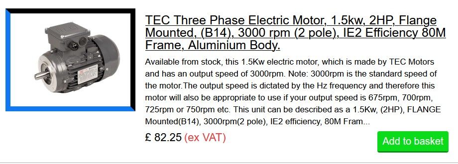

                  Martin King 2
                    @martinking2
                    Hi Robert,
                    Found this one:
                    Will this be OK?
                    It is just that I have a dread of ordering a big lump like this and opening it to find it is wrong, silly I know!
                    Any links for a VFD please, I know nothing about these either! Happy to help anyone out who wants to make a TV commercial or a Feature Film! wink
                    Martin

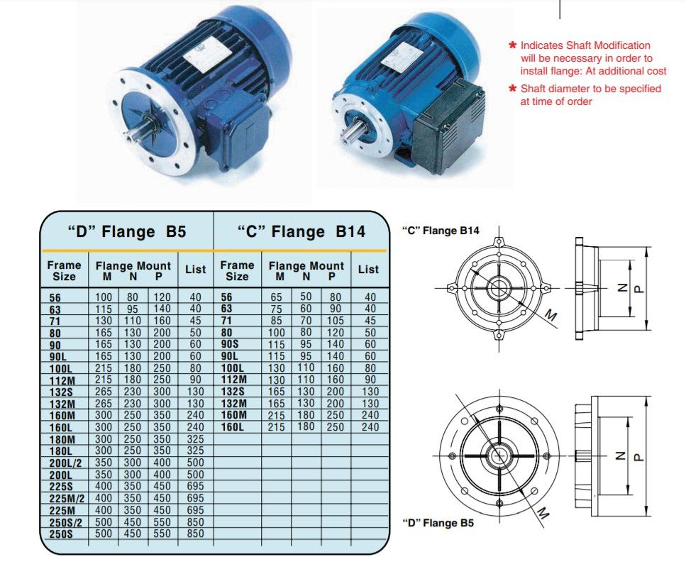

                      I'm not a motor expert, but the OP's link says B14 flange, but the corresponding picture is a B5 flange.
                      Clarification needed or have I missed something.

                                See, here we go, 2 Pole, 4 Pole! all means nothing to me. I just need what the German motor is.
                                German link does not state whether 2 or 4 pole?
                                The pic I posted says B14 flange not B5 whatever that is?
                                Getting confused now!
                                Is the pic I posted OK? (2 Pole), will that work with a VFD?
                                Martin
                                #549436
                                Emgee
                                  @emgee
                                  Martin
                                  You need the 2 pole motor and dual voltage 220/380v connected delta to operate from a 230v AC single phase supply VFD. As said check exact flange, B5 in the link you provided, B14 is smaller PCD fixings direct to motor endplate.

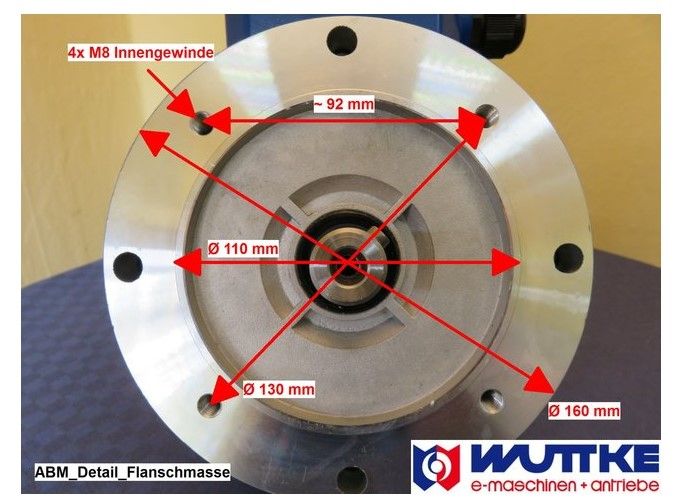

                                        This is the flange that I need as per the drawings for the linisher, I agree that the German link calls this a B14, but is it?
                                        Just checked with the maker of the linisher and waiting to hear back.
                                        Martin

                                                  It would appear that the German link I posted has an error in the flange type, B5 not B14.
                                                  People have been kind enough to try and help me out with this, I am sorry if it has caused you any confusion or irritation.
                                                  Regards, Martin
