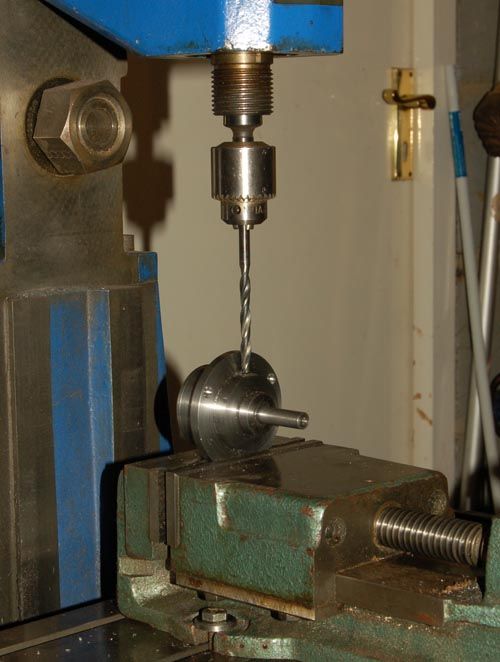

                                            I find it handy with my Rexon mill to have a collection of very short drills. With work held in the four jaw chuck, mounted on the six inch rotary table, there is very little head room, so I see what you mean when you say look out for that sort of thing. Ian S C

                                              Also handy to have the popular drills like tapping drills available in stub form with turned down shanks so they can fit into standard collets.
                                              Things like 6.8 which is tapping for 8mm reduced to 6mm so you can do away with a chuck and using a centre drill.
                                              Far more rigid, far more room and a lot quicker, applies to both CNC and manual machines in equal order.
