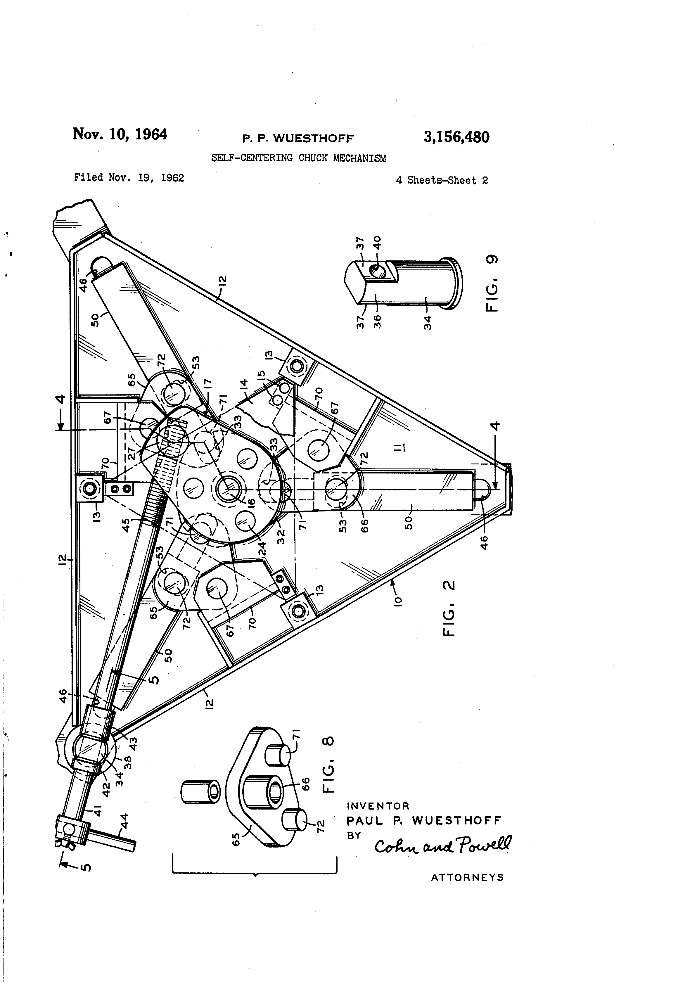

                                                #603079
                                                  Posted by Andrew Tinsley on 25/06/2022 20:13:38:
                                                  My main interest is its single pinion and why it was made thus and by whom.
                                                  Any chance it can be taken apart? It may not be a scroll chuck, perhaps a different mechanism designed to save time because it doesn't need 3 pinions to be tweaked in turn for maximum tightness:
