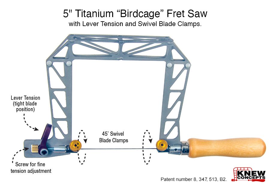

        This is tangentially related to metalwork in that I want to make a nice wooden presentation box for  some brass work. I have to learn how to make box (finger) joints and it seems that I need a fret saw to do them by hand. Prices vary from about £7.99 to:
        for £235.
        I'd like to know if (and why) paying so much for what seems essentially a simple tool would be worth it even for a professional woodworker. Seriously – I may be missing something, wouldn't be the first time.
        I also wonder what feature of the tool qualifies it for a patent. The design and mechanisms shown in the picture  are surely 'prior art' ?

          My guess: It's simply better. High rigidity and low weight will make it more precise and easier to work with. And written off over a few decades it's not really a big investment.

              My coping saw can swivel 360 degrees but the saw shown here has a limit of only 45degrees.
              #654772
                Their products are certainly ‘well-reviewed’ by users … and I think Fulmen’s guess is probably spot-on.
                My only nagging concern is that the ‘birdcage’ frame occupies a large volume and might be visually intrusive when working … but whether that presents a practical difficulty … I know not.
                Edit: __ The patent actually covers the flat-frame version of the saw rather than the bird-cage
                https://worldwide.espacenet.com/patent/search?q=pn%3DUS8347513B2
                … and don’t be shocked when you see Fig. 1

                  They had to work very hard to get that patent and it's so specific to the construction that it's probably not worth the paper it's written on.

                        I can't quite see why they think it is so important to make the frame rigid. Surely the blade should be mounted to cut on the pull stroke, for which the frame is only needed to hold the "far end" in the right place? I always thought that "junior hacksaws" were a waste of time until I tried putting in the blade "backwards"…
                        #654778
                          They type of blade they hold probably makes the biggest difference as they are more like a piercing saw blade and not as high or thick as say a typical Eclipse pegged end blade. This makes it a lot easier to enter the vertical cut and then turn the blade to cut out the waste.
                          Rigid frame does help if you get a blade going tight on the return stroke as well as being able to wind in a lot of blade tension

                            Coping saw frames usually allow 360* rotation of the blade and this is often useful for such jobs as cutting out the waste from dovetail joints. But the blade is very coarse compared to a fretsaw blade.
                            For finer and more delicate work, including watch and clockwork, most fretsaw and piercing saw frames do not allow any rotation of the blade at all, so the frame shown in the OP is a distinct improvement and if one were using it all day long then the lighter weight might be helpful. Whether it's worth the money is a matter of opinion.. Fret and piercing saw blades are both held by clamps and are interchangable, but a coping saw blade is pinned and so is not interchangable with the first two, I have sometimes thought of trying to make a fret /piercing saw frame with 360* rotation but not tried it so far.

                              KNEW also have a flat frame design that's not 3D titanium, and at a much more reasonable price. I have one and it works perfectly. Why I'd want a fancy 3D titanium one is beyond me.

                                  The patent is almost certainly an American "Design Patent" which is basically a more formalised version of copyright protecting certain aesthetic features of a product that the makers consider vital to its appeal.
                                  Pure fluff in engineering terms.
                                  It's tempting to wonder if the elaborate design actually makes any useful improvement in stiffness. A proper engineering analysis would be interesting.
                                  From an engineering perspective titanium is dubious choice of material for something whose purported benefits lie in shape, partial triangulation and wide section, rather than exploitation of material properties. Titanium is a sexy material but it is heavy and difficult to exploit.
                                  Out in the real world good enough is good enough. I suspect any improvements over a well made version of the common design are so far down the marginal end of the spectrum that no one would ever honestly notice. It's awfully easy to convince yourself that the new improved uber expensive version is actually better when seeking justification for the expenditure. Frankly, once good enough performance has been achieved, balance and handling feel count far more when seeking precision operation of such hand held tools than marginal improvements in whatever parameter the sales folk choose to puff up.

                                      A friend of mine has one of these, although I think it might be the flat rather than 3D version. However, he is rather a fine clockmaker and uses it for crossing out clock wheels rather than wood, which is perhaps a little more demanding. His comment is that it is a bit of a luxury, but it is very nice to use and does allow rather more blade tension than a more conventional frame.
                                      On the whole, I subscribe to the argument that paying a bit too much for a tool that you will use a lot is better than paying too little – although there must be a limit to "too much"!

                                                  They do make spiral piercing saw blades (advertised on Amazon for example). These cut in any direction so why need a rotating blade? Just asking.
                                                  #654821
                                                    I don't see why a 360deg is needed unless you want to go down one side, along the bottom an dthen up the other all with a shallow blade that will wander.
                                                    jap saw does the vertical cuts (board held vertically) then coping saw can simply be tilted to horizontal to cut out the waste upto the limit of it's throat. If you have awider board then rotating blade to 45deg is about right so you can saw horizontally without the frame hitting the work.

                                                      Those Knew Concept saws polarise opinions. Some people I respect swear by them, others (who I respect at least as much) see no benefit and prefer tools with character.
                                                      I suspect they don't make anyone significantly better. If people like them then fine. My favorite is either the cheapest deep throat eclipse (big knew is getting heavy), the medium one I made – neither are 'stiff'.
