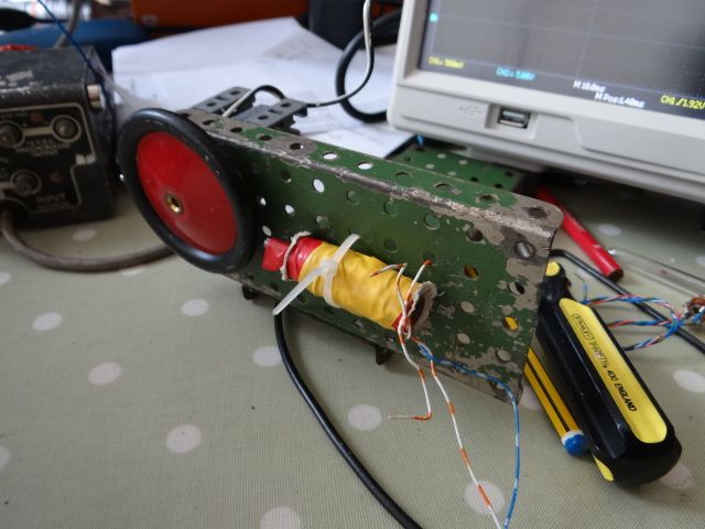

        Apparatus: A meccano lash-up with motor and wheel that spins a small super-magnet past a sawn-off nail with a few hundred turns of magnet wire coiled around it. The magnet is the shiny dot on the opposite side of the wheel to the nail and coil:

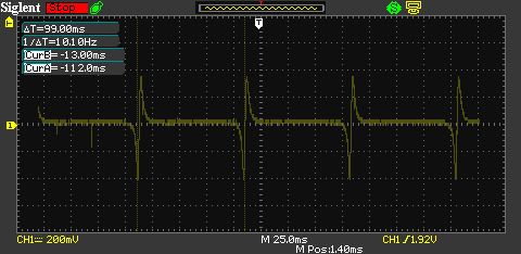

        A Siglent SDS1102 CML oscilloscope
        Method:
        Oscilloscope was connected to the coil on the 5V / graduation range and the wheel turned slowly by hand. This showed a pulse of about ±0.15V so the oscilloscope' sensitivity was increased to 200mV per graduation and the motor powered up with a 1.2V AA cell.
        Results.
        The oscilloscope registers almost exactly 10Hz so the motor is revolving at 600rpm
        The voltage spike is larger than I expected, at 760mV roughly double the turned by hand voltage
        Conclusion
        I knew but forgot that the voltage generated when a magnet passes a coil is proportional to the speed of transit. Thus, connecting this circuit directly to a sound-card is riskier than I expected! At 600rpm my experimental set-up wouldn't damage a sound-card, but higher rpm exceeds the limit. (At 4000rpm the set-up produces 2.75V pulses.)
        My pot circuit is too simple to protect the sound-card if the rpm varies.

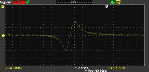

        I think Tim is looking for a display like this:
        The voltage swings ever more negative as the magnet approaches the coil, then flips to positive as the magnet passes TDC, and and falls as the magnet moves out of range. (Reversing the magnet would cause the pulse to go positive then negative.) Anyway, if I've remembered correctly, the voltage is proportional to the rate of change when the coil flips from negative to positive, which depends on how fast the magnet is moving – RPM.

            Posted by SillyOldDuffer on 25/09/2022 12:14:58:
            Thankyou for your efforts. It is interesting stuff.
            On the trace, where exactly is TDC? Is it at the point of maximum negative voltage, at the zero crossing point or at the maximum positive voltage?
            How many degrees of rotation does it represent from peak to peak? How many degrees from leaving the zero line to crossing it from below to meeting it again from above? The curve looks slightly asymmetric. Any speculation why?

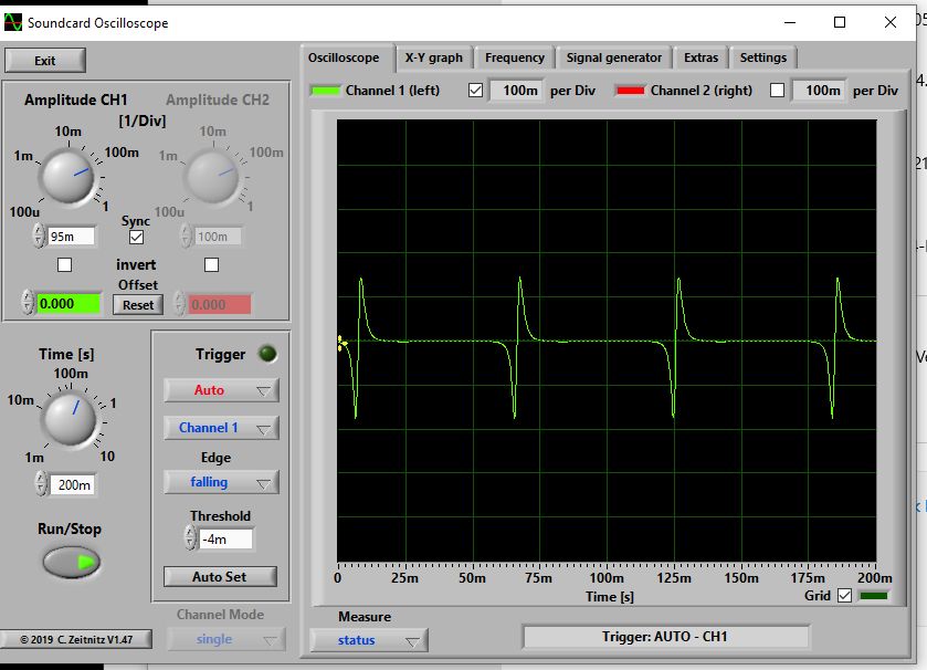

                        Posted by Robert Atkinson 2 on 25/09/2022 16:28:38:
                        Posted by DC31k on 24/09/2022 18:09:39:
                        Posted by SillyOldDuffer on 24/09/2022 17:46:55:
                        Results.
                        It would be interesting to see what your test setup produces with a soundcard 'scop software you proposed. Have to tried it?

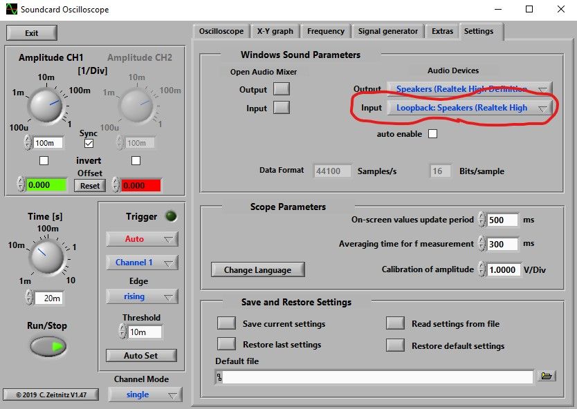

                        I have now, downloaded from here:
                        Slightly fussy getting it to recognise the input. My windows 10 PC has a Line-In (coded pink) socket on the front panel. Plugging in woke up the Realtek Audio mixer and I had to select Line-In. The scope still didn't work until I opened its settings tab (far right) and changed the input from Lookback to Line-In.
                        As I was certain my lash up powered by a 1.2V battery wouldn't over-volt the computer input, I connected directly. Might try a pair of back to back diodes later.
                        The waveform is in close agreement with the Siglent so concerns about soundcards only having an AC input are put to rest in this case.
                        Won't have a chance to think about Robert's questions until later this afternoon, but they're interesting too.
                        #615083
                        Robert Atkinson 2
                          @robertatkinson2
                          Thanks for that Dave,
                          Looks like good waveform fidelity. Amplitude is quite a bit off though. I wonder if the software has a calibration routine? One advantage of this application is the input signal is isolated so no ground loops.
