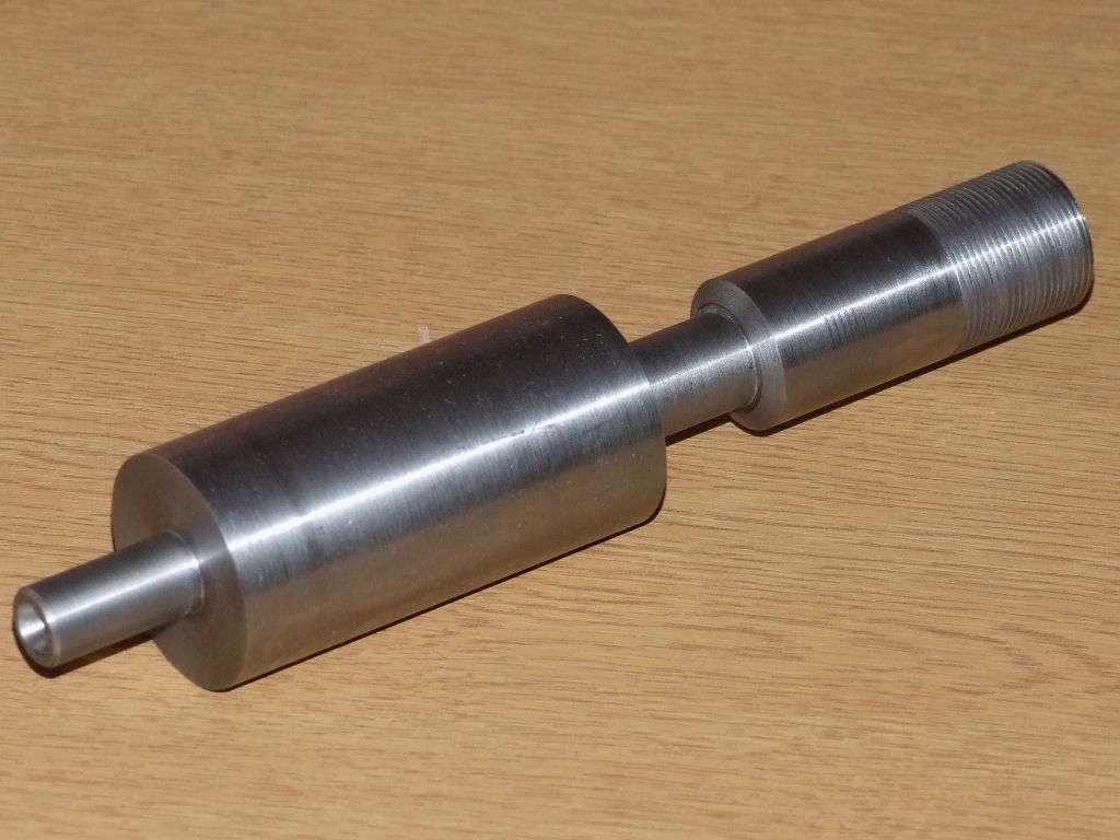

      I've just broken another one; that's the second one in as many weeks. Fortunately the broken bits came out easily. It was the last turning operation on my embryo hob for a worm wheel:
      I'd have been right put out if the part had been scrapped. If nothing else it's 30 quids worth of silver steel.
      The centre drills I've been using are a no-name set I bought many years ago, from an ME supplier, although I'm not sure which one. I've just put the whole lot in the bin; best place for them. I'll keep the nice wooden box they came in though. On Monday I'll order a new set from a reputable professional tool supplier.
      I never use centre drills for starting twist drills on anything other than the lathe. When drilling on the mill I either start straight with a four facet twist drill, or use a carbide spot drill.

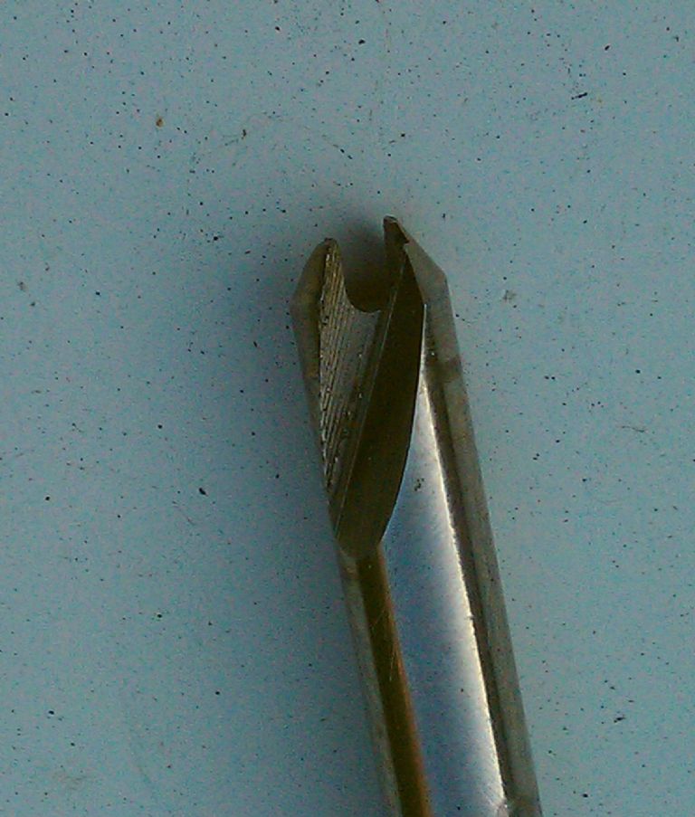

              Centre drills are a throw back to early lathe work. All the books like Chapman write about these as rote but seeing as there have been no new books written for centuries all the old rubbish gets regurgitated in any *new* books that come out
              Easier to copy / paste than do home work.
              The original use for a centre drill was two fold, firstly to put the cone shaped hole in to support a centre and secondly to act as a reservoir for white lead paste that was used as a lubricant for the dead centres of the day.
              Now the first reason still applies but seeing as most people today use revolting centres the long pilot is no longer needed, in fact it's a disadvantage as if it breaks the whole tool is scrap and probably the work. A good dodge is to regrind new centres to about half the pilot length, enough to clear the tip of the centre plus a couple of regrinds.
              THEN only use these for placing centre holes in work for use with lathe centres.
              Anything else you use spotting drills, in industry today you virtually never see centre drills as spotting drills have taken over for one simple reason, they are better or industry wouldn't use them.
              However if you do break a centre drill don't throw it away. Usually this is what you get.
              Sooooooooooo.
              Make the perpetrator do the repair.
              Grind the old broken centre drill up as a trepanning tool as in the two pics below.
              Top view.
              Bottom view, not the clearances all ways round.
              Then feed this in round the brokem tip until the broken bit stands proud, then a quick smack leaves it like this.
              Which is now easier to reclaim now it's missing a hardened piece of tool steel

                  John, that's a very nice way to get the tip of a broken centre drill out of the work.
                  Thor
                  #130944
                  Boiler Bri
                    @boilerbri
                    That's a good idea John. Looks like you have had a few broken ones to come up with that idea. I usually dig or shatter them out with sharp centre punch.

                          John Stevenson 1
                            @johnstevenson1
                            Neil,
                            I originally posted this on another forum a while ago, in fact the pictures are dated January 09.
                            I looked for one of these trepanning cutters and as usual because I wanted one, couldn't find on so I sorted out, found a centre drill that had seen better days from a tin of old HSS blanks. Then proceeded to break it on purpose just for the photo essay.
                            From what I can remember, because it was a pre-shortened one, which is what I do to all the centre drills, it took some breaking , just because I wanted it to break.

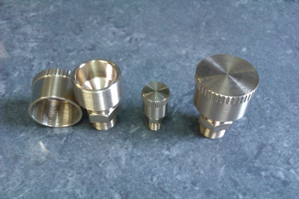

                                      The only problem with that is you will have to back the drill out more to clear the swarf as the flutes are very short.
                                      The other thing the 90deg spotting drills can be used for is to chamfer or even countersink the edge of a hole by drilling until the spot is larger than the intended hole. This saves having to go back after the hole is drilled and either Csk or deburr
                                      They also make handy engraving tools, I used an 1/8" spotting drill to do these grease cups this morning.

                                                      I thought I had posted this method of recovering from a broken off centre drill previously but I cannot find it so took a picture today of one that I reground a few years ago.
                                                      It was a 3/16" diameter slocumb bit that I broke the point off in a stainless steel job. The tip was stuck in a part that I had almost finished machining and the material was not long enough to shorten and start again.
                                                      I cut a deep 'screwdriver like' slot just a fraction wider than the diameter of the drill and just went in again with the modified bit which just removed the metal surrounding the broken tip (which fell out when I withdrew the cutter)
                                                      Basically the same as JS's single point trepaning tool but has the advantage that it is stronger and self centres itself. Another benefit is that the end result is just a slightly deeper centre hole.
