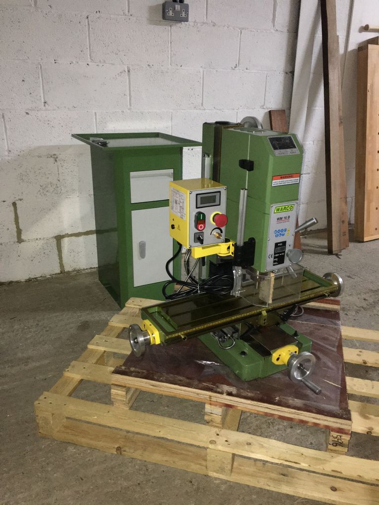

                  My milling machine has arrived from Warco and it’s ready to be lifted onto the stand. I want to buy some adjustable feet for the stand first. The tray is loose so I plan to hold it in position with some magnetic right-angle welding clamps, before I place the mill on there, I have an engine hoist to lift it. Then I can start to make some swarf !
                  Warco WM16B milling machine

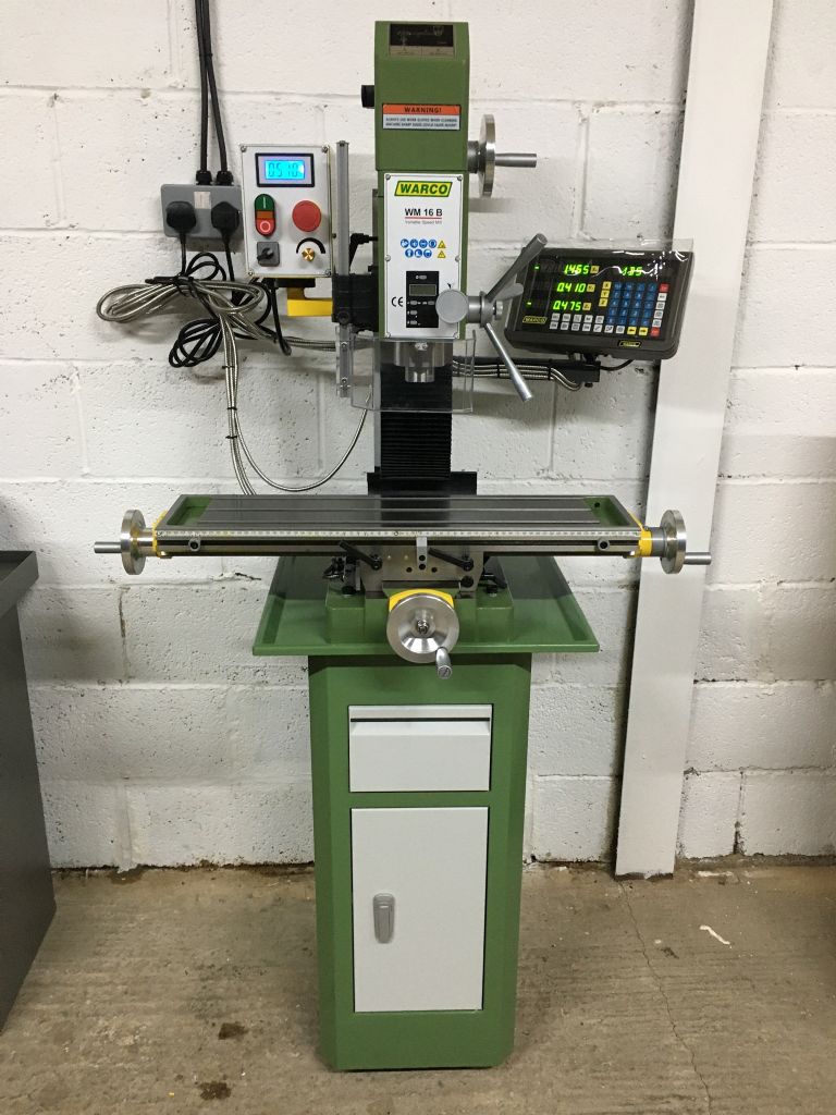

                                I now have my mill set up and I am starting to learn how to use it. I am very glad that I had the DRO’s fitted – I am now thinking about a Powerfeed. I have seen threads where people have fitted DIY power feeds to this mill, but I wonder whether anyone has fitted the Warco Powerfeed to this mill.
                                Warco WM16B
