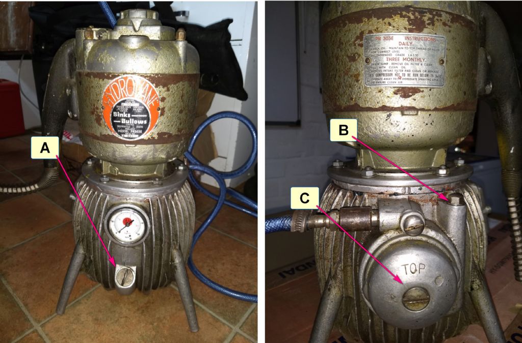

        I originally posed this question in another thread, but got no response. Quite simply, I've got a PR303E but cannot find a user manual for it. In the photos, I think 'A' is the oil filler cap, but don't know what 'B' and 'C' are. Can anyone help please? Does anybody have a copy of the user manual?

          Just guessing, but I suspect C would access the filter. Not so sure about B though.

            I haven't got a manual either BUT I have got one of these ! A wonderful and almost bombproof small air commpressor. It has a built in pressure relief set at about 40PSI. A) is the oil level. B) is the filler. C) is the filter. Any oilis better than NONE. I would use SAE 30 unless you have any better info. I can't check mine as I have lent it out. The were made for paint spraying. Hope this is helpful ? Noel.

                  Yes, i have one too. Someone left one by the side of the road a few months ago for free and i grabbed it. It was filthy, so i cleaned it up, sorted out the dodgy cable and it works perfectly. Mine has a tyre inflator attachment fitted. Yes, its the oil and filter. You can take them apart easily, there is viirtally no moving parts.

                                I think the instruction manual would boil down to 'clean the filter occasionally and change the oil periodically'. I can't see there is anything else to do or go go wrong.

                                            Anyway bought one yesterday for 20 quid. Yes, without finding this post I wouldn't know that it has an oil filter, so a manual would be useful. Powered it up yesterday, to test it. It runs and makes air, though I saw the gauge going up quite fast I turned it off to prevent it blowing up. Now I read here that it has a relief valve, something I was thinking of too that it should have, but couldn't see any so turned it off to protect it.
                                            Very silent, took oil level out and oil is a very milky inside. Is that supposed to be white-ish? My main question is, what grade of oil should I get? I can see a net search brings up ISO VG150 for hydrovane compressors. Is that the right oil. Is the oil filter obtainable from somewhere online? I will pop it out once I finish work today.

                                                Mine has the relief blowing off at about 45PSI. So I would be careful that your air receiver is good for at least 50 PSI. A safety valve on the receiver would be a good idea. Noel.
