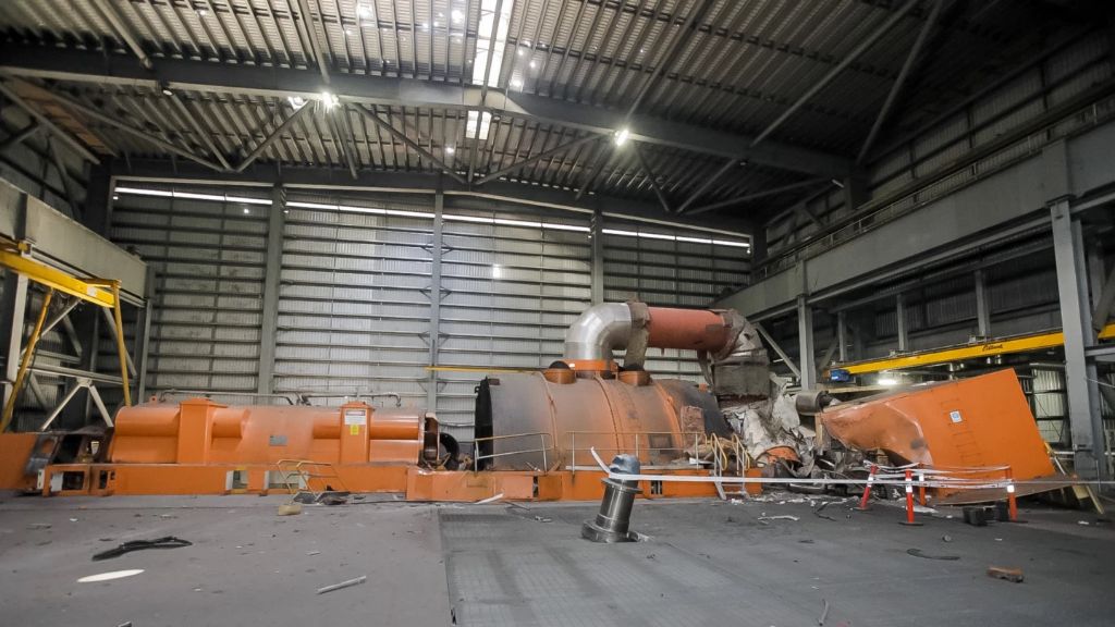

                            The 660MW alternators in the power stations are cooled by pure hydrogen , because it has a coefficient of heat
                            transfer 2000 times that of air, as I remember.
                            #628300
                            Hopper
                              @hopper
                              Posted by J Hancock on 09/01/2023 10:54:06:
                              With rather unfortunate results sometimes
                              Although this one (Callide power station, Australia) appears to have blown the turbine end, reportedly after the HP blades flung off and pierced the casing, causing a hydrogen explosion. The official report has not yet been released so still relying on gobbledygook from journalists how know nothing about it.
                              But apparently they lost the 12 volt power supply to the control system, which shut down the turbine by default in failsafe mode, closing off the steam valves and shutting down the bearing lube pump etc. But the breaker connecting the generator to the grid failed to drop out, so the generator started to act like a giant electric motor and spin the turbine up until it overspeeded, flung the blades and set off the hydrogen used presumeably for bearing cooling or perhaps even gas bearings themselves. Luckily they cleared the building before it went off. Turbine blades were found some hundreds of metres away.
