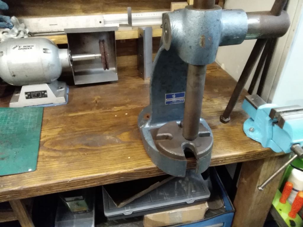

      Well it looks better than some of the slightly cheaper alternatives, something to think about is something like a simple job of pressing a bearing off a spindle, you need to hang it below the 2 black blocks, so you'd need to raise it up on something, or have a hole in your workbench below, I find these blocks have a tendency to move while in use sometimes, so making something to hold them in place while using is something to consider, I like being able feel the feedback you get on an Arbour press when putting small bearings on a spindle, Hydraulics can damage small parts quite easily without realising it.

          An Arbour press press hangs several inches over the edge of a workbench, so you can put in any length until it touches the floor.

              That's the beauty of an Arbour Press, your left hand is free to hold the part, while it is held rigid in the support that doesn't slide about, try that with a Hydraulic press, you need one hand to hold the part, one hand to hold blocks from sliding about, and a third hand to pump the lever.

                  If a Hydraulic Press is what you really want then that's your choice, I was just trying offer some advice, I own all three kinds, and it's my least favourite, I find it awkward to use for anything small.
                  But if you're willing to spend some time modifying it, i'm sure you can make it work for what you want, if you have a lathe and milling machine you'll be able to make fixtures to make it do what you need it to do.

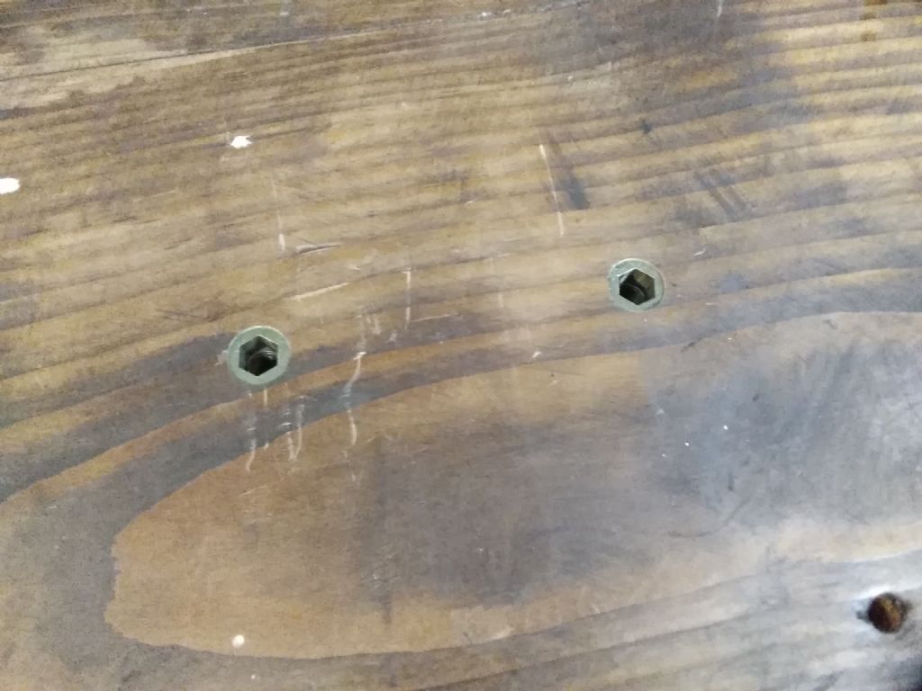

                      No worries, there's no reason you can't have both, I saw a small Arbour press on Gumtree for £15 not long ago, I picked up my Jones and Shipman for £25 from an old gent shutting up shop for health reasons I think, you can put them away when not in use, and use 2 of these flush fit wood inserts to bolt it to your bench in under a minute when you want to use it,
