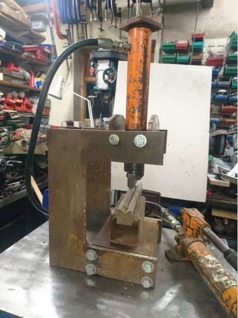

                  #407016
                  Simon Williams 3
                    @simonwilliams3
                    Fly press is good at a high force over a short stroke, which is what it is designed for when used for punching or folding. The actual thread converting the handle motion into downwards force is pretty coarse, so it's not the best for use as a pusher in of bearings or a broaching press. You find your self pushing in successive "bumps" so it can be done but it's not ideal. It's big advantage is that the bolster (coming down on the tool) is located well by a dovetail so alignment and pushing square come easily and are built in. But its a big heavy thing that you can hardly put away after each use, so your space constraints may dictate that it's impractical anyway.
                    A hydraulic press will give you better control over a long stroke, but is much slower to operate. You could motorise it, but I'm assuming this isn't for repetitive use. Various sources of the components exist, the body press kit made by Clarke isn't expensive and gets you started. Enerpac is another option but tends to be pricey. Here's one I made earlier:
                    This is a very controllable and versatile tool, I use it for pressing bearings, universal joint replacements, also folding sheet metal as you can see. Love it to bits but it's quite difficult making sure you are pushing square. The last broaching job I did with it went through crooked. It's relatively portable so it lives under the bench and comes out when needed.
                    HTH Simon
