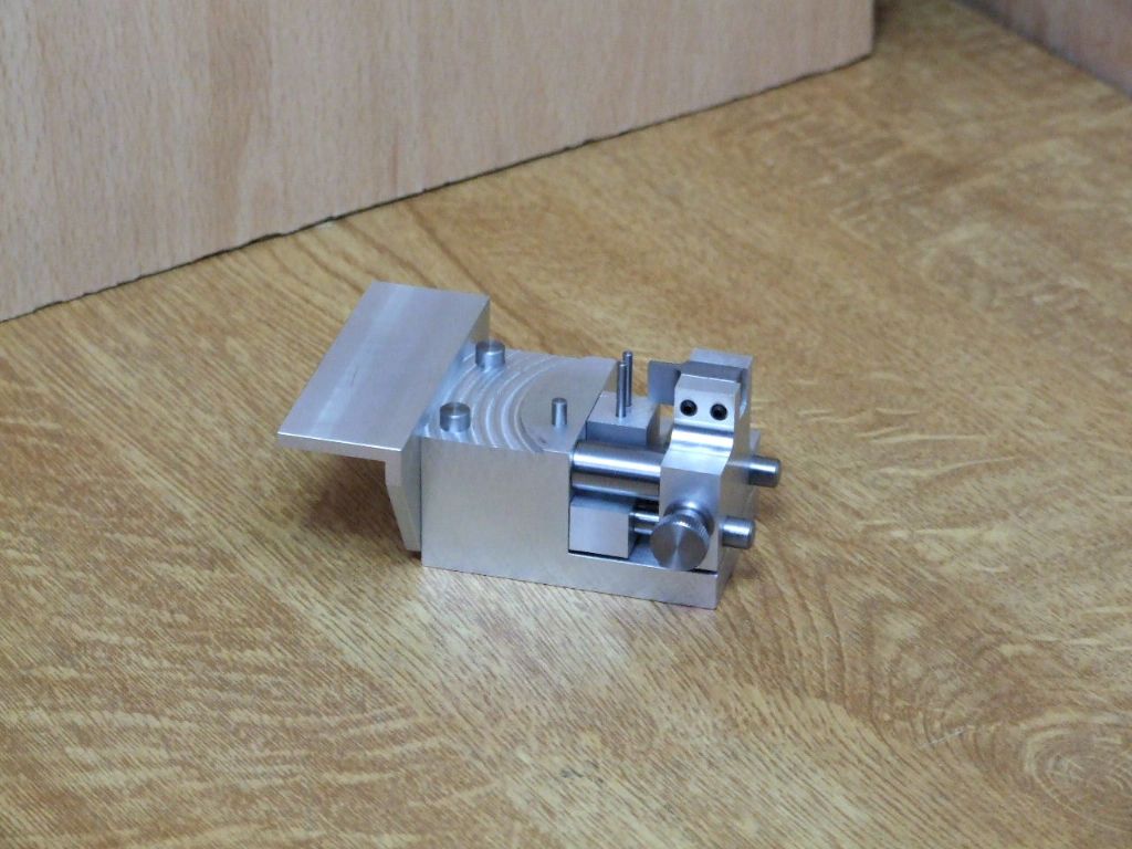

                It has been a while since my last post on this topic. The reason being I needed to make another tool to make things easier for me to complete this tool.

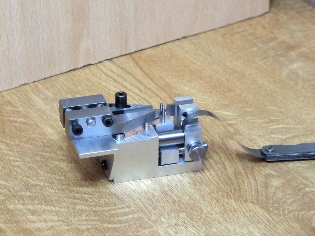

                Above is the set up for setting a specific radius. The feeler blade in this instance being 0.05 mm.

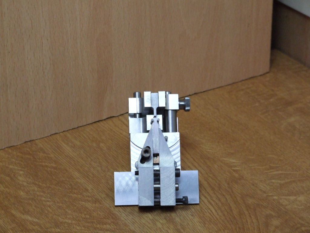

                This gives a better view of what is happening. The dowel pins are aligning the tool centrally on the fixture centre-line. The springs on the tool clamp hold the tool temporarily during the setting process. When the tool is being urged towards the fixed stop. Final tightening being done with the extended M4 capscrew.

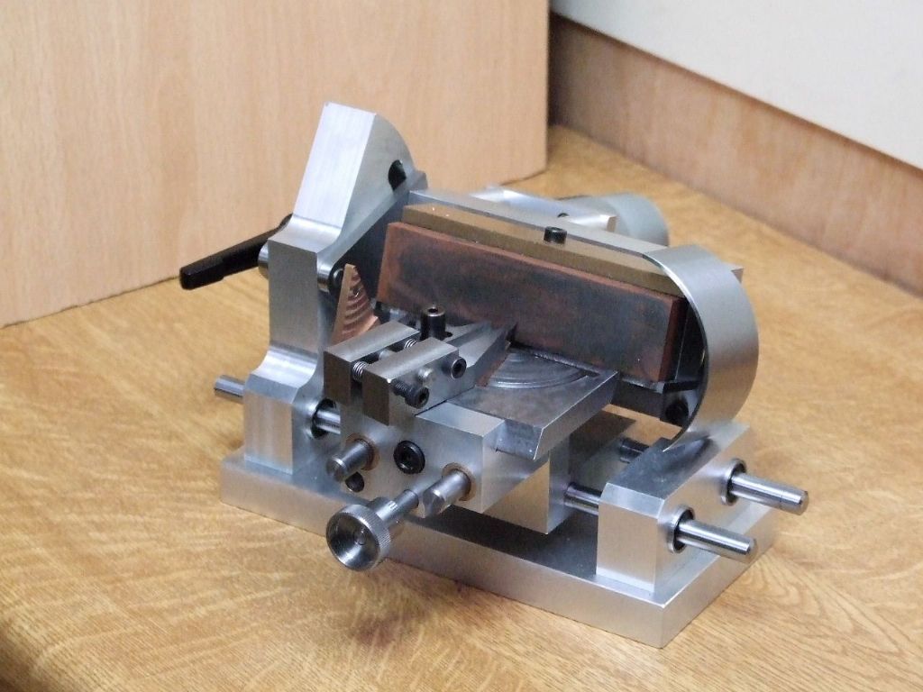

                The tool holder and segment are then transferred to the radius table on the honing machine.

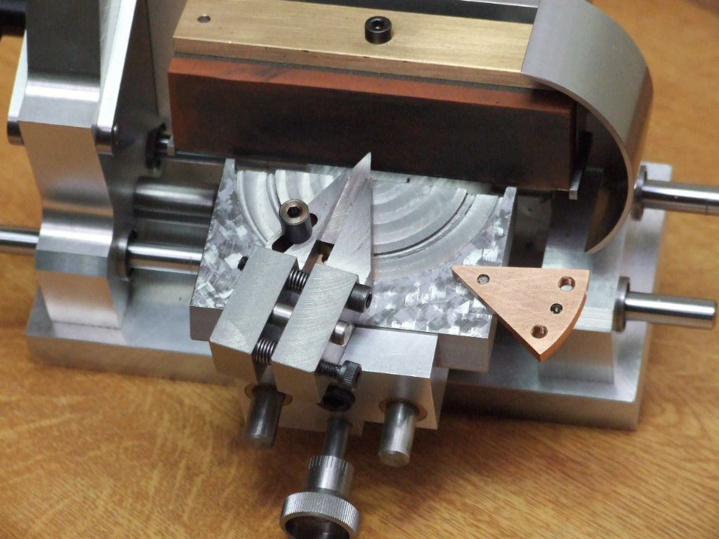

                I have found it an advantage with small radii to initially stroke the tool across a stationary stone. This takes away any tendency for the sharp point of the tool to dig into the stone.
                This gives a better view of what is going on,
                The spare segment shown on the right is held in position by some small magnets inserted into the tooling holes used to manufacture the segment. These also help draw the segment into the semi-circular recess.
