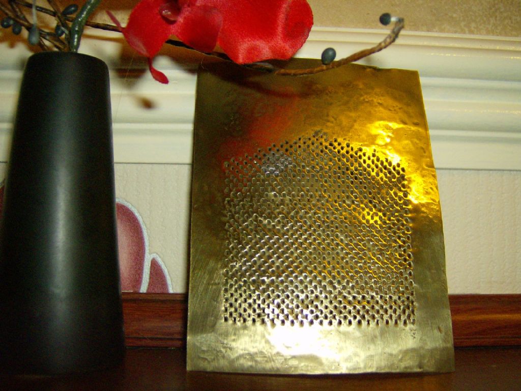

        This took a little thought and a lot of patience – and several tries!
        How would YOU make it?
        #87947
          Looks like its been punched out so would have to make a rectangular punch and space out a row of holes, step over for the next row and then back for the next etc.

            If this is something you have already made it appears to have had a hard life after you finished it with a distressed/crumpled look!
            Its hard to tell from the picture what size it is, or what the material is. If its painted metal then the holes might be smaller than 2mm so drilling them on a milling machine would not be too onerous.
            Is the material curved in two planes, like a mudguard? that would explain why the fenestration does not look to be on the centreline.

              Think I'd look VERY seriously at photoetching.
              Keith

                Looks like brass?
                I might have made a die block for the flypress perhaps not with all the holes say an inches worth then press index press….. ad infinitum
                Paul
                #87958
                  The bit of a metric scale in the bottom right makes it easy to see what the size is and how would you drill the rectangular holes on a mill?
                  Yes I thought brass as well.
                  J

                    I was beginning to think I had a different picture to everyone else, then I zoomed in! I am still not quite sure what we are looking at, it could be a bit of brass shim but I'm not sure what the original poster wanted to know.
                    Reading Neil's post again it seems like he has already made the part, in which case he posed the question as a sort of puzzle or test. It would have been better at the outset if he had said so or at least give us a some details of what we were supposed to be helping with.
                    I saw the metric(?) scale in the background but without knowing how far back it was it was not easy to see its size relationship to the yellow plate. Some of the holes, which I can now see are rectangular) seem to be only partly formed, or are they blocked with paint?

                      Looks like its about 5cm square x 6cm
                      2" x 2.5" approx
                      and it's been fabricated….
                      My inital thought was wire mesh which has been painted, then blown with compressed air to maintain the holes
                      …but it looks like it's been fabricated…and the holes have accuracy
                      It's the sort of pattern you could create on a sheet of soft metal with an industrial sewing machine which was fitted with a square needle
                      The alternative would be to make up a die punch block of square needles kind of thing, a lot of work for one job.
                      There seem to be scratches on each side of the mesh block, like it's travelled across something hard so I will go with the sewing machine guess

                        To do it by hand I would clamp a piece of wood on the bottom
                        Brass in the middle
                        and wire mesh on the top as a template
                        Then punch the holes individually with a square awl
                        Would take a few goes to get it right though…lol

                            Punch it but make sure the die takes the correct amount of metal otherwise if it take less than its own area you will end up with stretching.

                              Like this:
                              Brian is very right – the unhardened die plate got nibbled avway by the punch… hence distortion.
                              But by making the spacings one and two turns of the handwheel apart, it wasn't too tedious even with two annealingas and flattenings.
                              I called upon the spirits of copper-bashing (or at least those of my long-gone grandfather the coppersmith) and ended up with something a bit like this after some planishing:
                              The flash & polish makes it look worse than it is, but I may try a last anneal and planish. This is what it is meant to look like (yes I know it isn't dead to scale!):
                              Thing is, when painted will it look better than some wire gauze or mesh? The alternative is, as suggested, etching.

                                                  Quick update – I gave it a spray of high-build primer as an experiment and teh planishing marks disappear to leave it like a baby's proverbial!
                                                  I'll have to clean it off and respray with etch primer before the high-build but I'm relieved to see I can have a half decent result.
