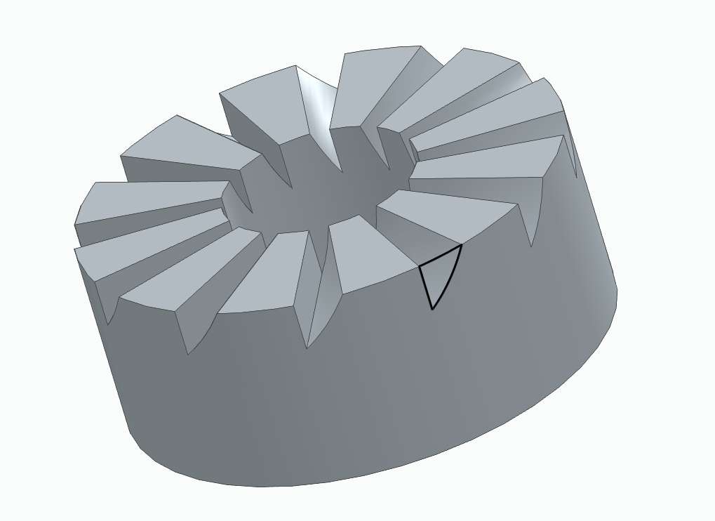

      Consider cutting the teeth with a 45° single-angle milling cutter, initially without the cylindrical inner: that can be added later if needed!  For the drawing below showing just the first cut, I have assumed 50mm diameter and 26 teeth.
      The aim is to angle the workpiece on the milling table so the depth of cut reduces to zero at the centre of the workpiece but gives the desired angle for each tooth.
      ratchet1
      The angle at the centre is 360°/26, which gives the dimensions of a right-angled triangle as shown.
      At point ‘A’ the depth of cut needs to be 5.98mm if using a 45° cutter. By my calculations, that means the workpiece needs to be angled on the milling table by about 14.3°.
      The above should produce sharp teeth with no flat tops: not quite as shown in the opening post. Adjustments could be made to the geometry to give flat tops.

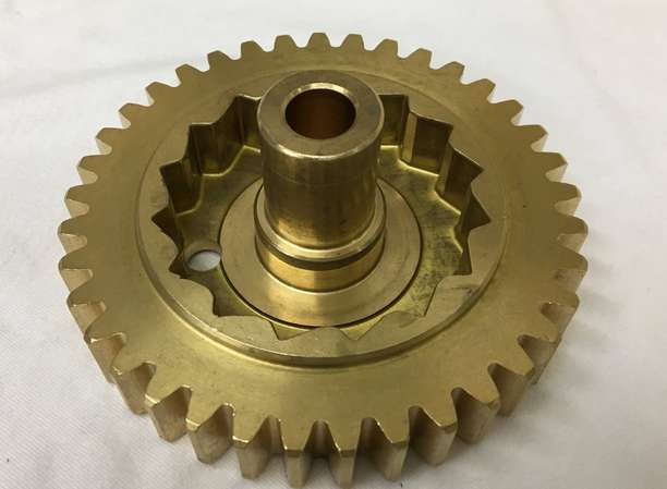

                Found some real examples on the web by searching for flattened ratchet, mostly found on bicycles and IC starters I think.  I can see how they were made by following advice given in this thread,
                marineratchet
                https://www.groveclassicmotorcycles.co.uk/Graphics/Std_Product_Images/bk87-4-first-gear-on-layshaft-19t-ratchet-gear-tt--1241-p.jpg
                Closest match to what I’ve modelled is this revolver cylinder, which I think Peter’s method can do:

                  I might be wrong,  but to me, the revolver example looks as if the barrel was mounted on the Z Axis and a dovetail cutter mounted with its shaft parallel to the X Axis and the flat face  of the cutter in the YZ Plane.   As the cutter crosses  the flat boss on the barrel, it rises in theYZ Plane, making a narrowing, shallowing tooth form.

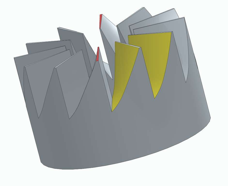

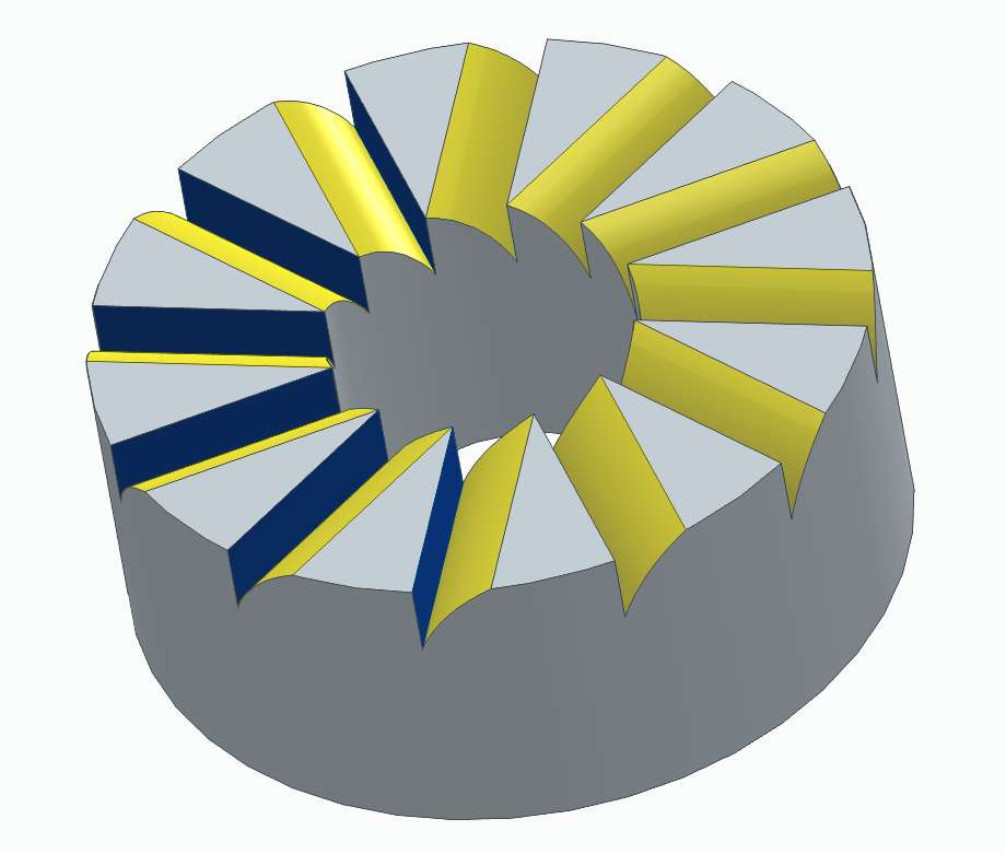

                          Only interrupted 4 times, though the work is taking longer than expected.

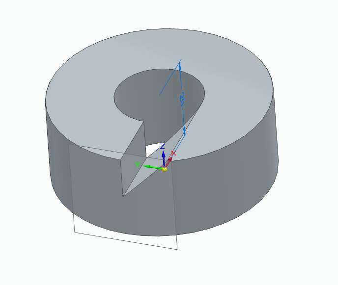

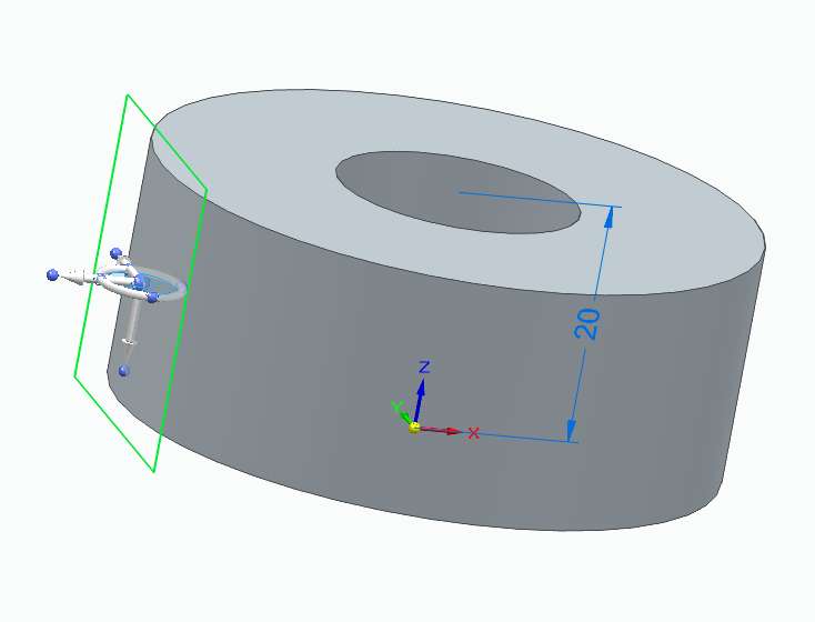

                          First off, made a blank with a big hole in the middle, as suggested, and added a tangent plane.  (In addition to the usual XY, XZ, and YZ planes, CAD allows tangent and angled planes as well.)
                          blankratchetwithTangentPlane
                          The 2D sketch representing the cutter is drawn on the tangent plane and can be projected into the blank in various ways.  I experimented with straight cutting at 90° and then with projecting the sketch onto the curved blank and letting the software cut at a diverging angle to an edge on the Z-axis.
                          Straight cut with a 45° form tool (as typical in a milling machine) produces:
                          ratchetStaightV
                          And repeating it with a rotary table would give:
                          ratchet45cutter90

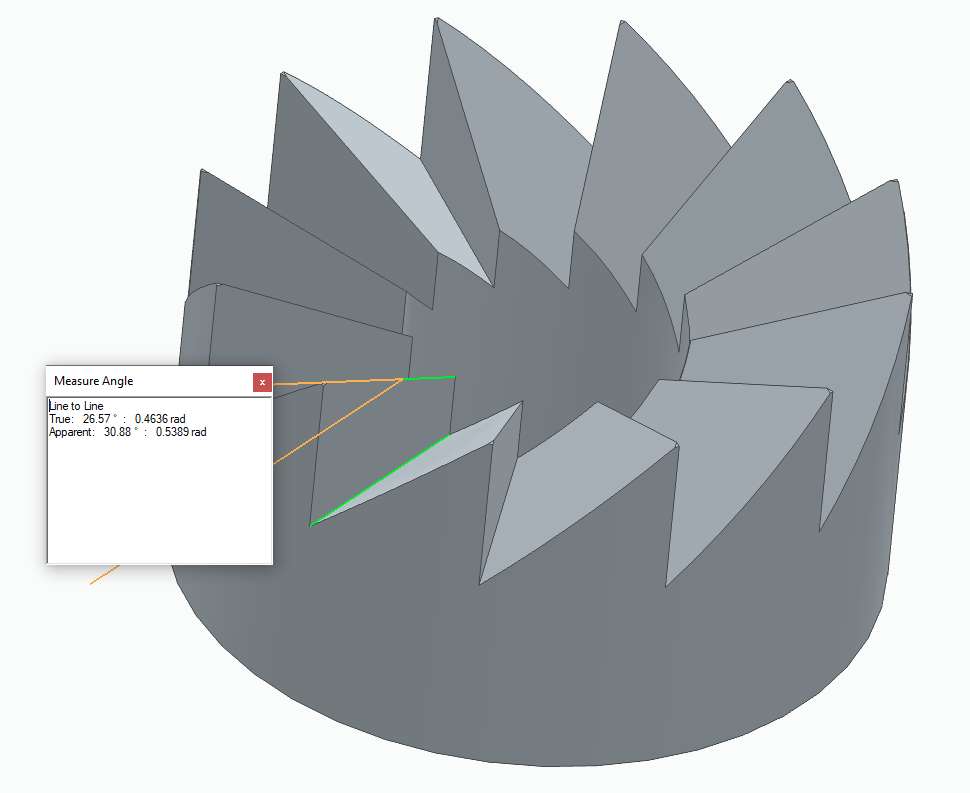

                          Though easy to make, the result is no good.  Tilting the job (or mill head) to 26°and going deeper, looks better:
                          ratchet45cutter26dot57
                          but it’s another fail.  On the outer edge the pawl has to climb over 12mm, whilst only 5 on the inside.  Not ideal – the pawl should climb roughly the same height wherever happens to be.

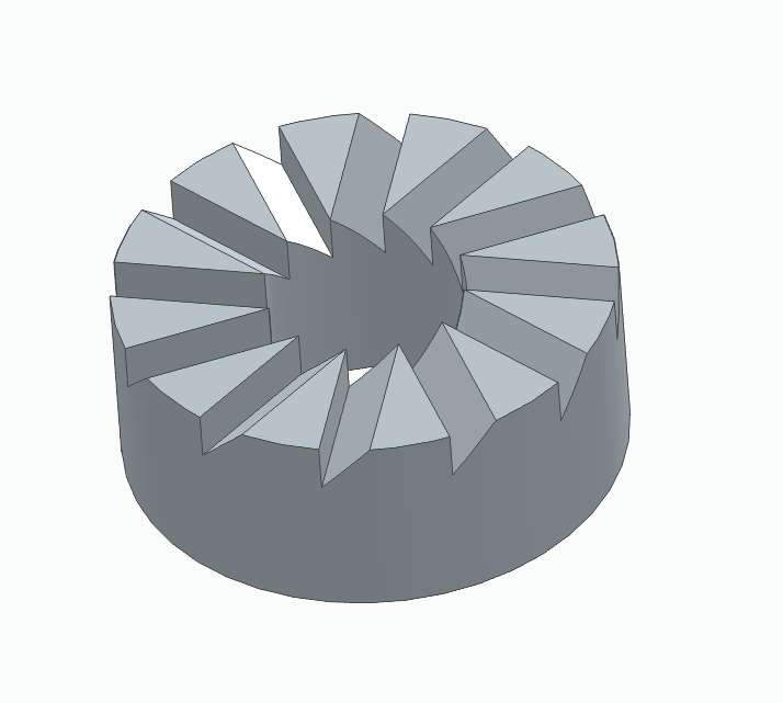

                          Next I tried altering the cutter form, in this example to a round rather that straight 45° V.   This could be done with a shaped grinding wheel.   There’s no advantage in the yellow curves and the flat triangular tops spoil the pawl’s action.
                          ratchetcurvedformcut

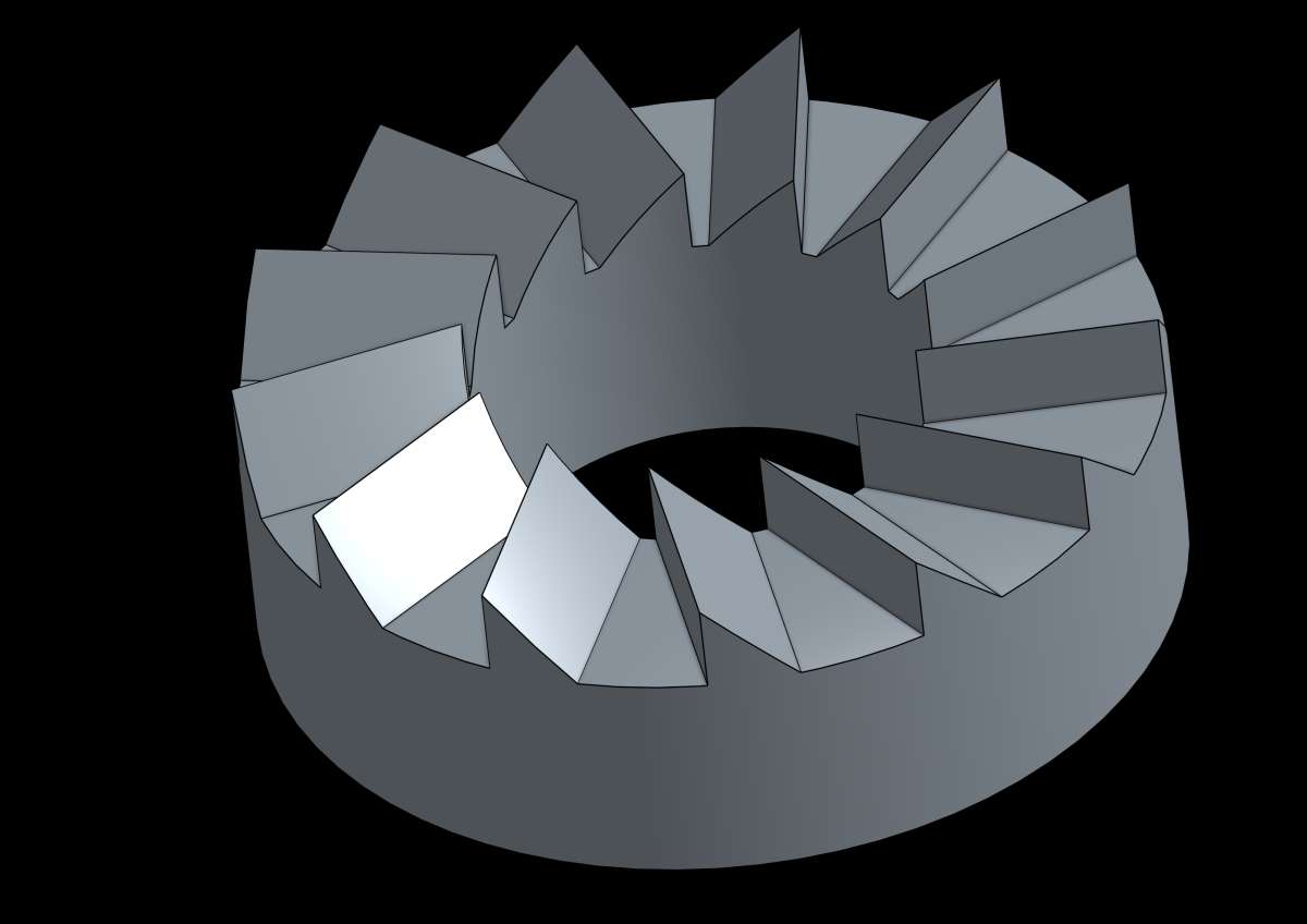

                          Next, the V is projected on to the cylinder, changing shape, and doesn’t cut from the tangent at 90°.
                          ratchetNormalFormCutWithposcurve
                          The top is flat, hurrah, and cutting deeper narrows the top to the desired nearly parallel edged form, shown in red below.  The pawl rises and drops consistently:
                          ratchetDeepCutNormal
                          But the yellow face is hard to cut because it’s profile curves right-left and in-out simultaneously.  That seems to require a cutter that changes shape and angle depending where is it.    Spark erosion or a laser.
                          Need to explore further, cos I don’t understand this properly, but it feels like the best answer is one of: 3D-printing a mould and casting it; 3D-printing it in plastic and hoping it’s strong enough; sending the file off to a 3D metal printer and having them make it; or sending it to a CNC shop who does sparks, lasers, and tiny cutters.  So far no sign of a way of doing this in metal with the equipment I have.
                          Oh, and as a few correspondents have pointed out, the pawl’s profile should match the ratchet.
                          Back to the drawing board is still an option, and I’m not convinced I’ve investigated Peter’s suggestion sufficiently.
