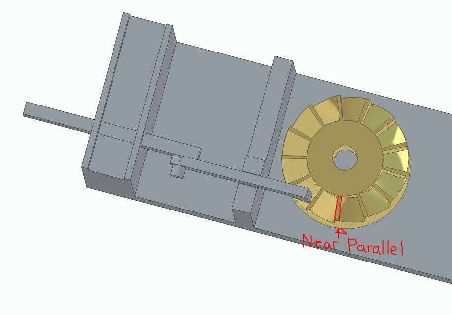

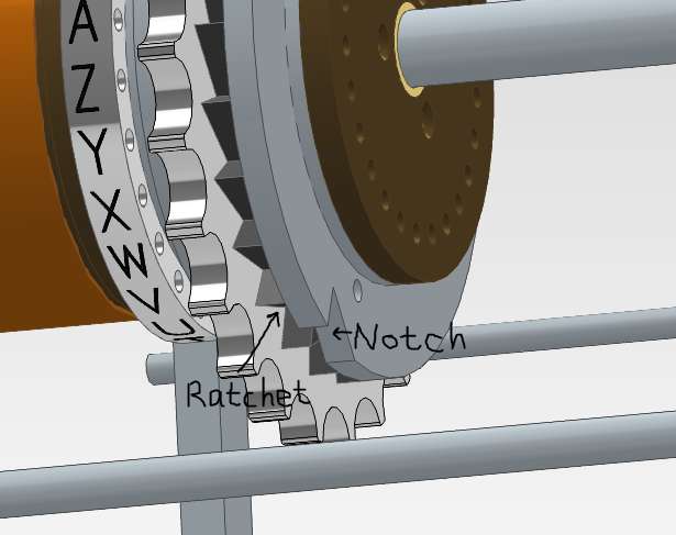

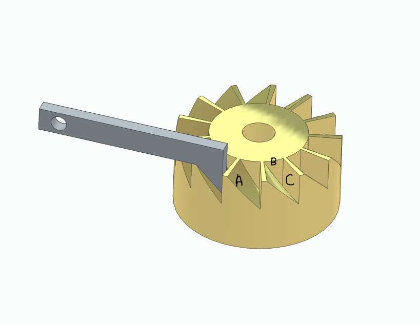

      Thinking about an odometer-like mechanism recently I came up with a ratchet drive in which a pawl pushed a wheel one click by pressing on a flat face like ‘C’ whilst riding up a curved opposite slope ‘A’ until it dropped down into the next notch.  (The pawl moves left to to right on a hinge and is spring loaded)   Something like this:
      ratchetWheel
      Though surface ‘B’ is rounded, wouldn’t matter if a cutter spoilt that.
      Even so, how could those curved ratchet notches be machined?  I can’t imagine either a straight or form cutter doing it however tilted.  Have I smacked into a design that’s easy to CAD but hard to make for real?  Or am I missing the obvious?
      Ratchets like this exist, so there must be a way.
      Help!
      Ta,

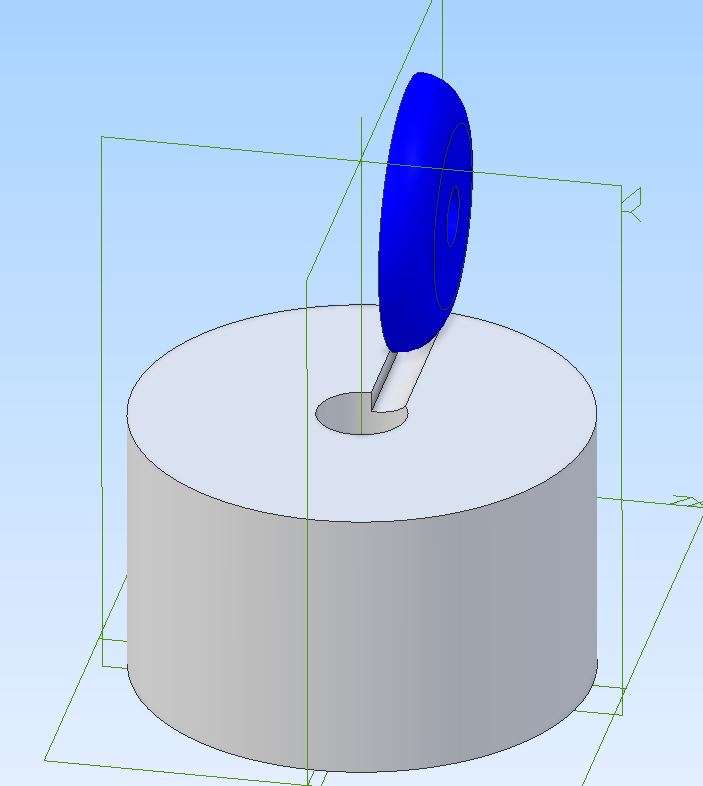

        A form cutter a bit like a 1 sided involute gear cutter would probably do it if the centre section could be soldered into a ring so that the cutter could have run out room or have the centre recessed to just below the valley of the teeth
        You would also have to watch that the cutter’s diameter was not too large otherwise it would hit the opposite side
        We did have  asimilar thread about hole saws which need a similar sort of cut
        If you could have a small radius in the internal corners then that opens up more possibilities
        #785282
          ratchet
          Something like this would cut the tooth profile, just index it round.

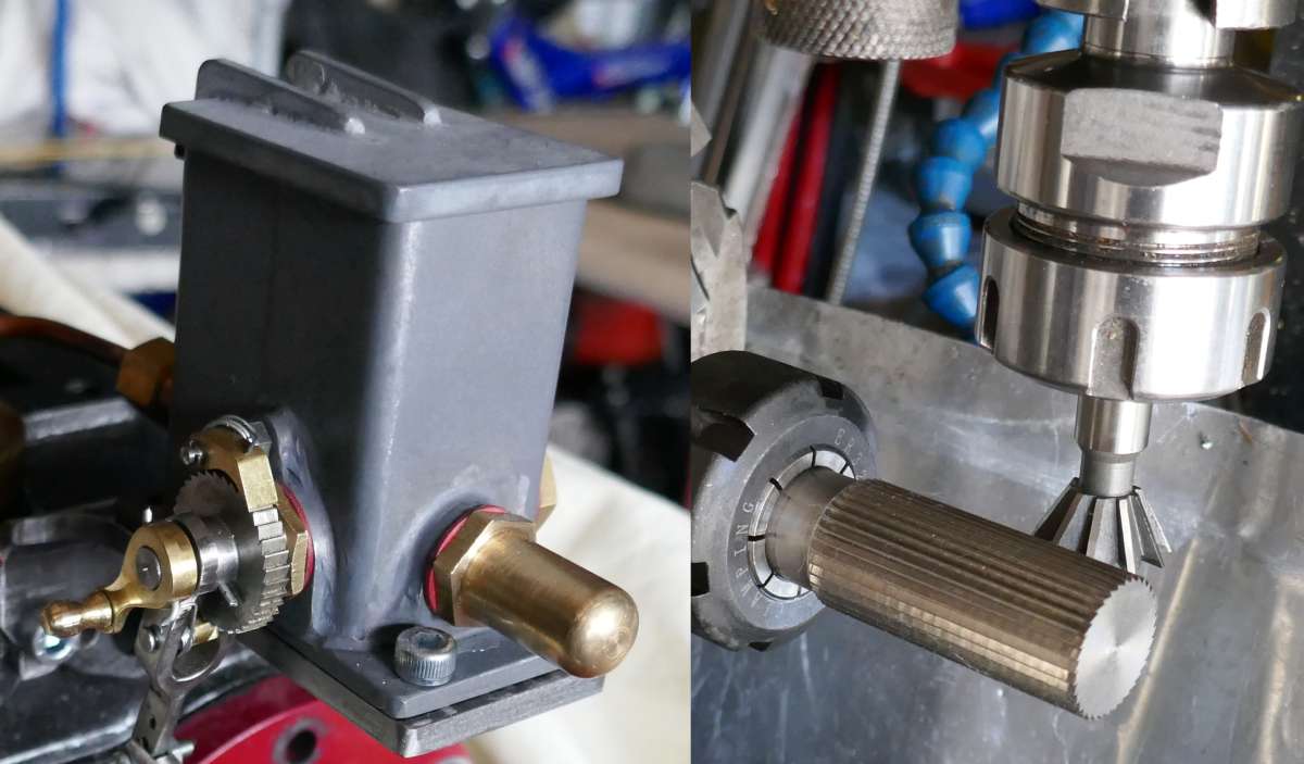

            Is the boss in the centre of the ratchet necessary?  Because it is very difficult to machine into a blind hole that has a sharp corner.
            I made a ratchet wheel for the lubricator on my engine by cutting teeth on a long piece of rod with a chamfer tool, then cutting a slice off the end for the ratchet. (lots of spare material for future projects).
            Ratchet 2

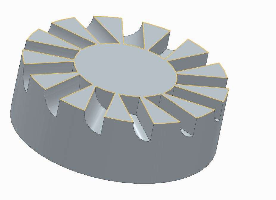

              #785298
                Feels like back to the computer.
                This is the shape of the removed metal, which I hoped might suggest a form cutter profile, nope!
                postooth
                Jason’s ‘D’ cutter does what Julie feared, I think.  Could be cut but the teeth won’t ratchet, the yellow lines aren’t parallel:
                ratchet
                Thanks for the suggestions, seems tricky!  I’m off to sleep on it.

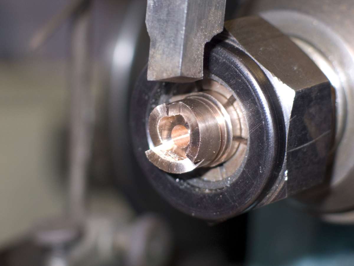

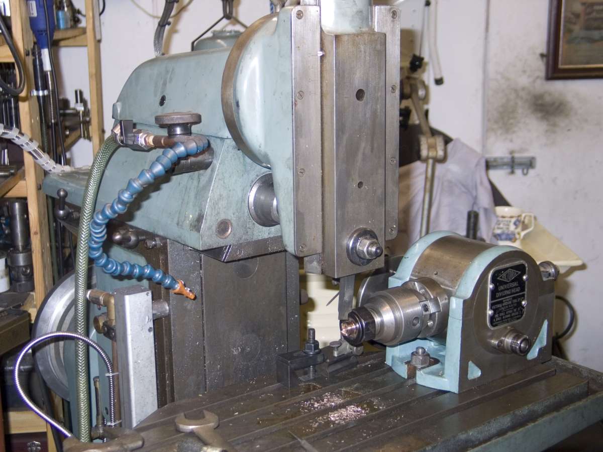

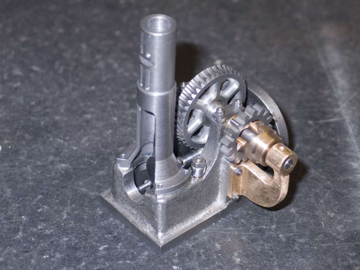

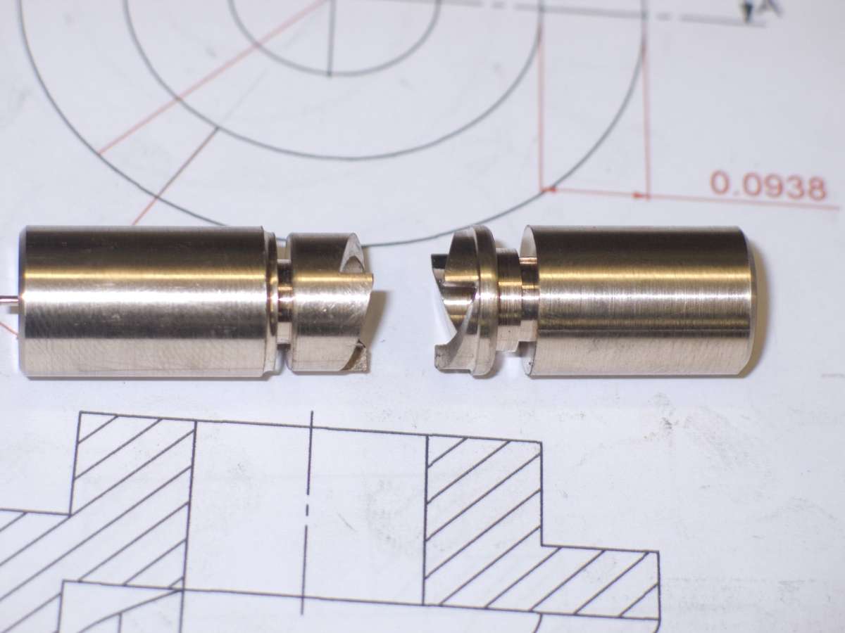

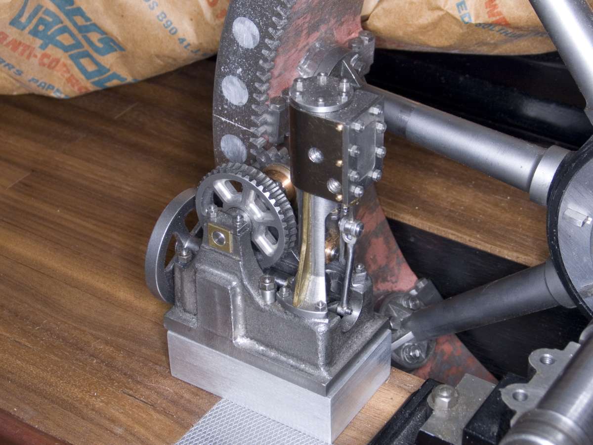

                  I made a radial toothed clutch for my little barring engine which was a similar problem. The only way I came up with was using a slotting head and a dividing head linked to the X axis of the mill.
                  Barring Engine 001 14-08-16
                  Barring Engine 010 14-08-16
                  Barring Engine 009 14-08-16
                  Barring Engine 014 14-08-16
                  Barring Engine 009 18-09-16
                  Minor Manifold 011 09-10-19

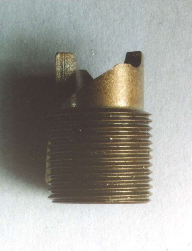

                    Not sure [and I am certainly making no claim to fame] but I wonder if Jason was recalling the question I asked years ago about cutting a verge crown-wheel for a clock.
                    If so, it was never fully solved.
                    I will have a look for the old thread next time I wake-up in the middle of the night.
                    Edit: __ ‘twas much easier to find than I anticipated:
                    https://www.model-engineer.co.uk/forums/topic/how-do-i-cut-a-verge-crown-escape-wheel/#post-212482
                    … still sipping a Glenmorangie
                    Edit: __ some of the content in that 2015 thread has gone awol so, for completeness I am quoting an observation I made in a related eMail:
                    Although JasonB and Mark C both provided very useful sketches … on close examination, both of them actually ‘demonstrate the problem’ rather than answering the question.
                    Mark was particularly helpful, and provided me with some more-detailed drawings; but the big ‘niggling’ question remained. [Zoom-in on a tooth in his SolidWorks rendering, and you will see that the tooth-tips are inappropriately shaped.]

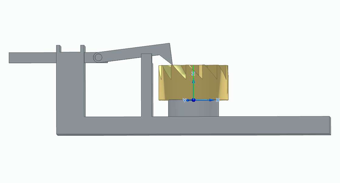

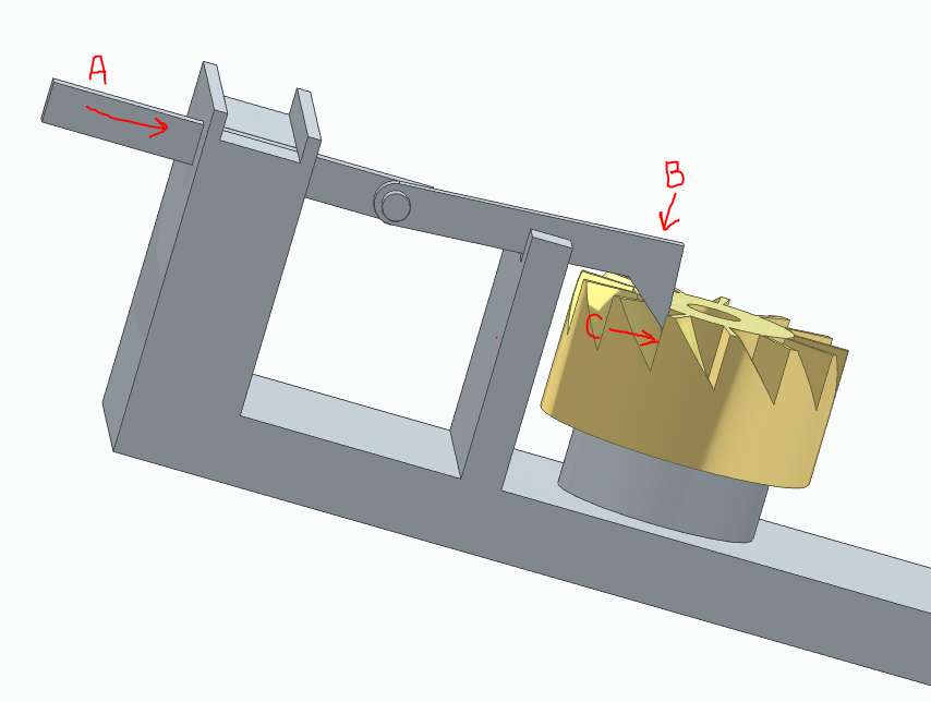

                                                    That part of the problem doesn’t worry me.  The ratchet is pushed anti-clockwise when the pawl moves from left to right, and on return right to lift, the hook rides up and over.  The mechanism is like this, not modelled correctly in that the pawl should be longer, but it animates OK.
                                                    First view, the pawl is moving left, has ridden up the slope, and is sat on the top about to drop into the next notch:
                                                    ratchetUp
                                                    It started from deep inside the notch, having pushed the ratchet one notch by pressing on face ‘C’.  Slider ‘A’ is  moving right and constrained by a block, but able to move up/down at hook ‘B’ due to the hinge:
                                                    ratchetpushing
                                                    Top view next showing the pawl at an angle to the notch, and why the two red lines are near parallel.  Not critically so but not wildly divergent, because that would delay the time the pawl rides on top.
                                                    ratchetTop
                                                    The action is similar but not identical to a ratchet or a verge.  In a ratchet a pawl prevents rotation in one direction, whilst a verge intermittently releases a wheel via a rising and falling pawl.  In both cases torque is applied by the wheel.   In my application the wheel free-wheels and the pawl shoves it round one notch, before returning and dropping into the next cavity.  The pawl driver slides L-R, and the pawl is hinged to ride back over the reverse slope.   I don’t see much problem with that, my problem is how to cut the ratchet wheel.
