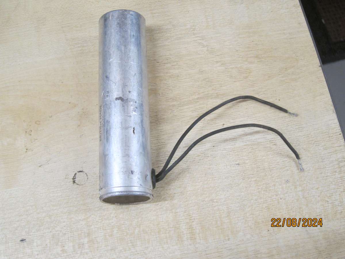

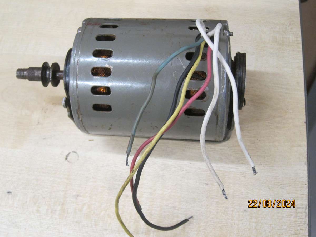

      I have acquired a vintage single phase GEC 2 pole motor running at a nominal 2880rpm with a starting capacitor rated 40-50uf. The motor has 6 leads coloured Red, Black, Yellow and Green plus 2 White. A test meter check shows that the resistance between Red and Black leads gives 26.3 ohms and 42.8 ohms between leads Yellow and Green and I assume that the 2 White leads are connected to the capacitor.
      Perhaps before making any serious mistakes someone could advise me on how the motor should be wired up to the mains.

        I believe the wire colours are blue and yellow which denotes the start winding. (not green)
        Red and black will be the run winding.
        The 2 white wires may possibly be across the centrifugal switch, check for resistance across the ends.

              I have checked for continuity across the two white wires and the resistance is zero ohms which suggests that the two wires may be connected to a centrifugal switch in its normally closed position but short of dismantling the motor I cannot be sure that this is the case.

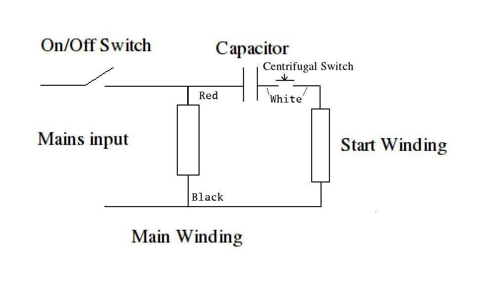

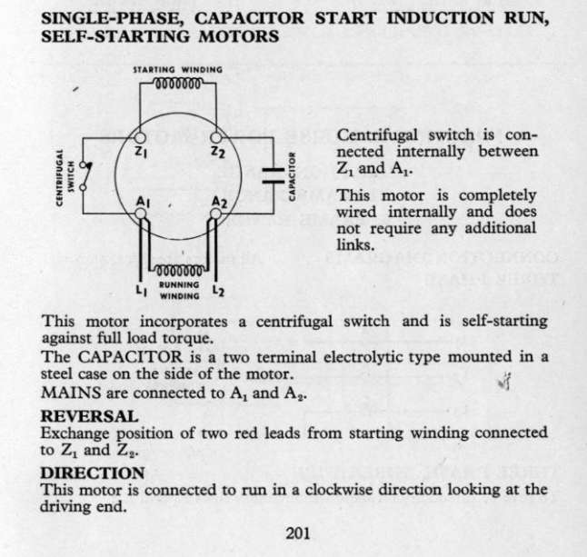

                Looks about right to me, though I’m not an expert on GEC motors;
                This is from a Brook catalogue
                image_2024-08-23_113637098
                You could try spinning it up with a soft start variable speed electric hand drill and see if the contacts open twixt the two white wires.
                In reality, it should probably fire up with just the run winding connected, though it might require a spin by hand in one direction.

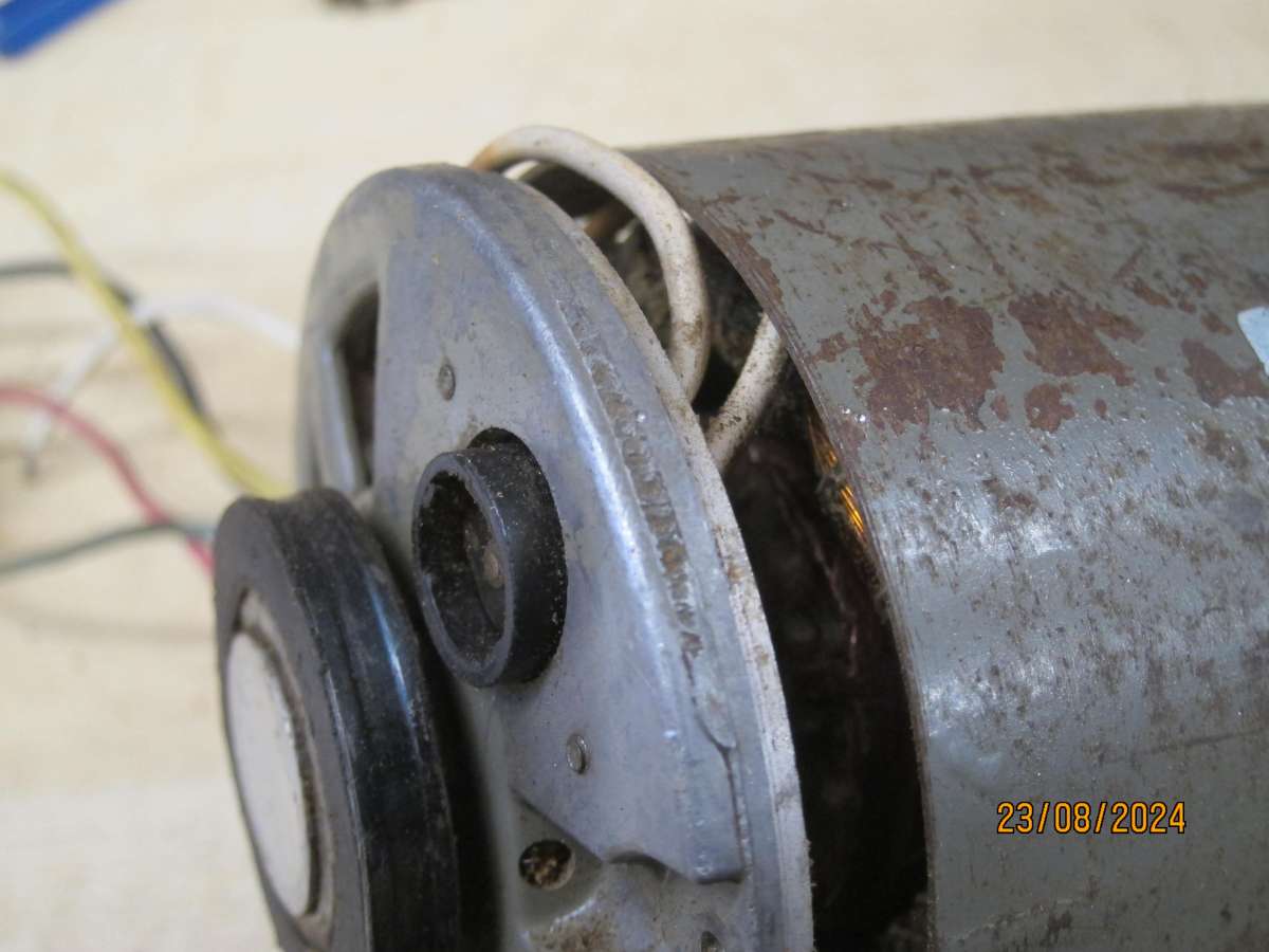

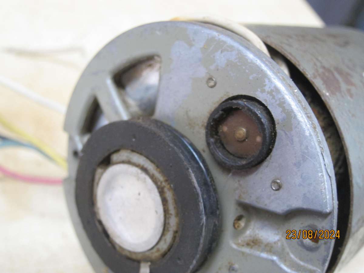

                    The mystery deepens. I tried a test run wiring the motor according to the diagram shown above on the assumption that the 2 White wires were connected to an internal centrifugal switch but the result was some nasty blue smoke emerging from the ventilating grills and the motor getting very hot. Fortunately I was able to switch off at the mains before hopefully doing too much damage.
                    Opening up the two end plates reveals the two white wire leading to an external location in one of the end plates but for what reason I have no idea. The photos hopefully illustrate the situation.

                      That device on the end frame is a thermal cutout, it should have a protective red plastic button over  it.
                      Normally it would have mains voltage on it. Don’t touch it when power is on !

                          If you now connect one capacitor lead to the red wire and the other capacitor lead to the blue wire and the yellow wire to black, the motor should start and run when you connect power to it.
                          If it runs the wrong way just swap the blue and yellow wires. Just keep an eye on the temperature for a while, just to check that its not overheating. Ignore the white wires.
                          I suspect that the motor is just a capacitor start and run, no centrifugal switch. If there is one you will hear it click as the motor slows down.

                            red / black should be the run windings. Blue/ / yellow start windings. White wires thermal cut out. I don’t think this type of motor has a centrifugal switch.  capacitor across the start and run windings. Good luck. Noel.

                                The diagram that I posted above is quite correct, just ignore the CF switch.
                                “If you now connect one capacitor lead to the red wire and the other capacitor lead to the blue wire and the yellow wire to black, the motor should start and run when you connect power to it.”
