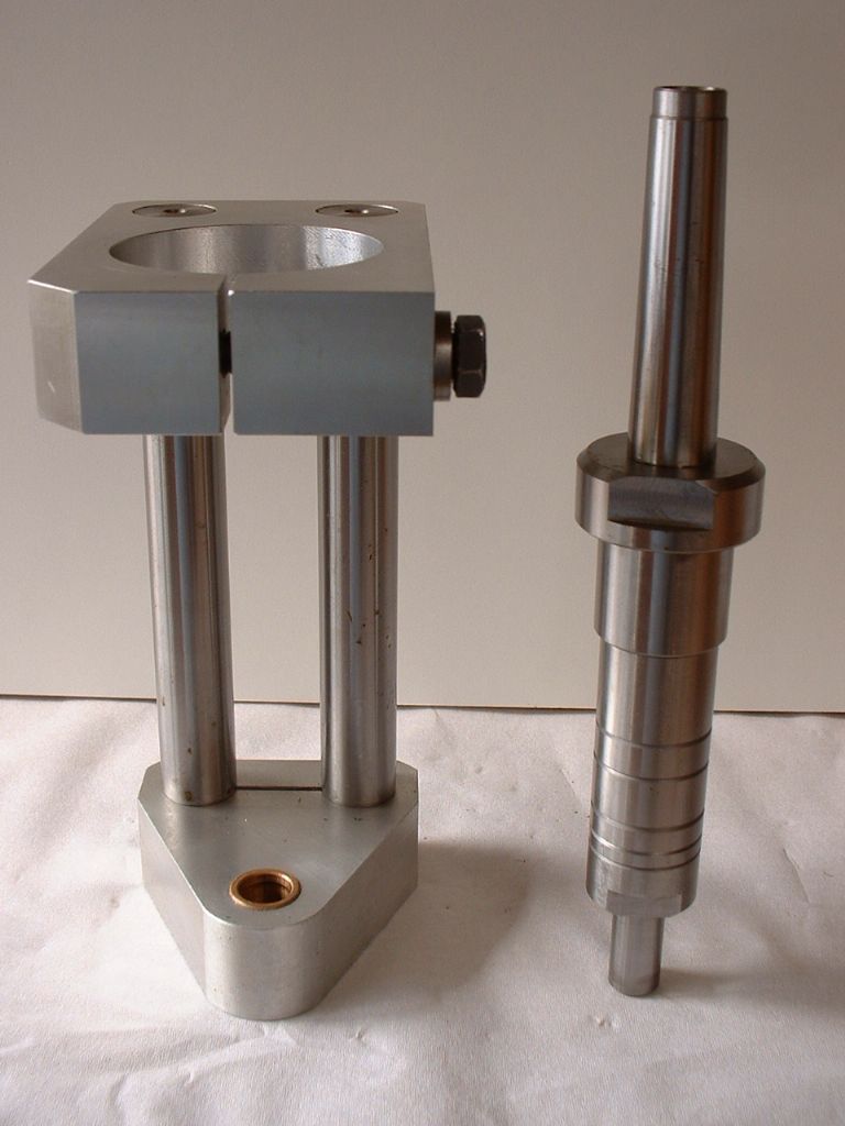

      I have a mill that has a round column with a rectangular strip to keep alignment.
      It also does not have a fine feed or depth stop on the Z axis.
      So far I have used it with end mills and it seems to cut fine, but I have a couple of questions on how to use it for slots and boring.
      I tried cutting a 8mm slot using a 2 flute slot cutter. When cutting vertically i.e. starting the slot, the head started violently vibrating side to side, but horizontally is fine.
      I used the quill feed so dont have a good feed rate, but guess it was about 1mm/10s.
      I found if I drilled a hole first, the vibration stopped so I guess it is due to the asymmetric forces from the different length cutting edges.
      1. Is it normal for a slot drill to do this?
      2. Am I expecting it to cut too fast vertically?
      3. Should I use the quill or Z axis to give the vertical feed?
      4. Is this just a limitation of the round column design and I should get a mill with a dovetail Z axis?
      Thanks
      Adrian

          1. No it isn't normal, but on any mill play in the quill, bearings or work clamping, or a poorly ground cutter, will lead to vibration and the slot drill possibly cutting oversize during plunging, even with a centre hole
          2. Feedrate seems way too slow although spindle speed isn't quoted. I normally plunge at about half the normal feedrate in deference to only one edge cutting all the way to the centre. Assuming a HSS cutter and steel workpiece I'd be running at 1000rpm and a plunge rate of 80mm/min
          3. Personally I'd use Z, but I have a mill with dovetails on Z so that makes life easier
          4. Not for me to say
          It really comes down to machine mass and flexibility. On my vertical mill an 8mm cutter would be fine, but I have seen the same issues when using 20mm, or larger, slot drills.

            Round column mills don't usually have an alignment strip. They clamp the head securely and rely solely on the quill for Z axis. Whether yours can be used moving the Z axis depends upon the fit of the rectangular strip stopping any tendency for rotation. This could be verified using a dti when the head is free to move up and down to see if the head can be rotated on the column. More than 0.002" movement would be too much.

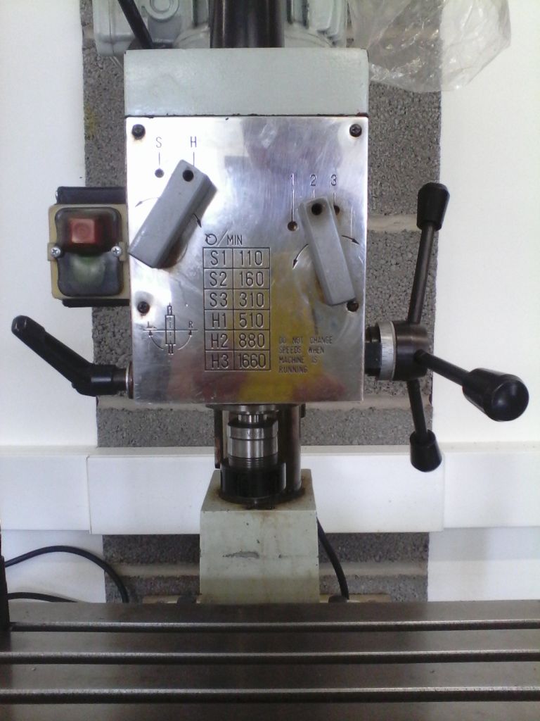

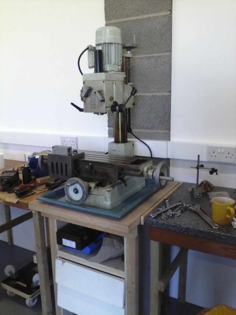

                        Could we have more pictures of the mill? Possibly a name and there may be more info on the "lathes UK " site.

                          The mill is a ZX-16 sold by Engineers Tool Room in 2003 as a BMD-16 but still badged as a ZX-16. Till today I had not known it is a copy of a Emco FB2. Looking at the head, the casting is identical, and I have also seen a youtube video showing internal parts, they look the same as mine.
                          It is still sold by the OEM XYMC

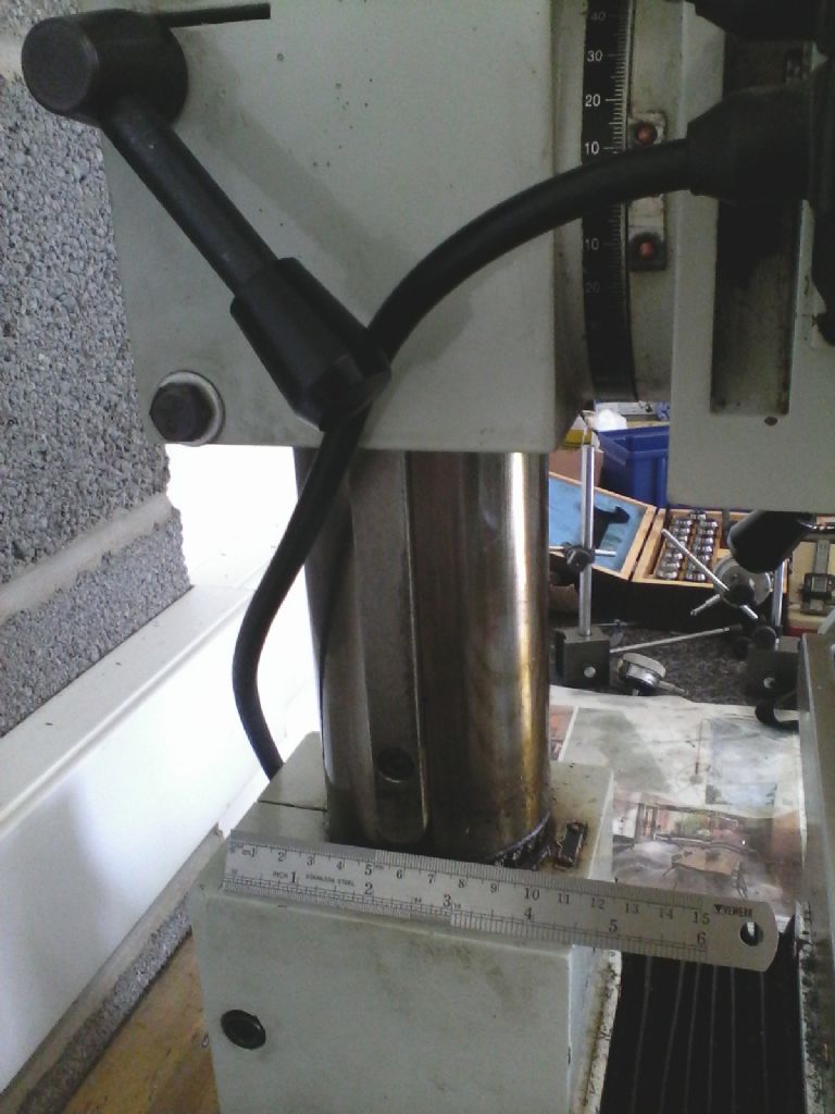

                            Could the metal guide strip on the column be loose? Without a fine feed on the quill, the only way to move slowly in the Z axis is with the wheel at the rear. Are any adjustments possible to the fit, such as a vertical jib strip?
                             In your first picture, behind the 11 on the rule is a plate which looks like it is a pointer. Can the column be rotated in the base? Is it tight?

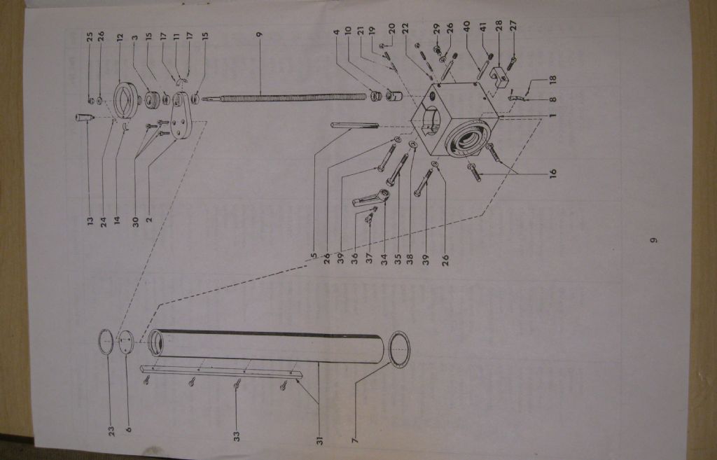

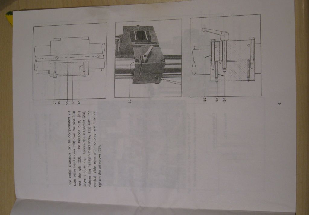

                              I have 3 FB-2 mills and have no problem with any, within the limits of such a structure..
                              The key is to ensure the various adjustments are well taken care of. You will never mill as heavily with Z axis motion as you could with a dovetail column mill. Likewise, in X and Y, you need to lock the head on the column when taking heavy cuts.
                              In the first picture you can see the vertical head Gib – item 20. This must be really well snug in the slot, up against the vertical key. Also, the sequence of setting the screws is important
                              page 2 shows the gib again (item 5) and all the setup screws.
                              It is also very important to ensure the two hex screws in the column support ( the base part) are well tight to ensure the column cannot rotate.
                              If you cannot read the text on page one, PM me and I will scan the pages and send them via email…
                              Joe

                                  I did make some adjustments to the gib and the hex screws today. However I think after reading those instructions I will look at it again tomorrow.
                                  I did initially have a problem with the column rotating when doing the vertical plunge. It shifted the head about 3mm which I could not move back without loosening the column. The side way forces from the slot drill plunge are really quite high, much higher than an endmill traversing. I have tightened the column and it is the vibration after that which I am asking about.
                                  I have some more slots to cut tomorrow so I will see if the column adjustments have improved it.

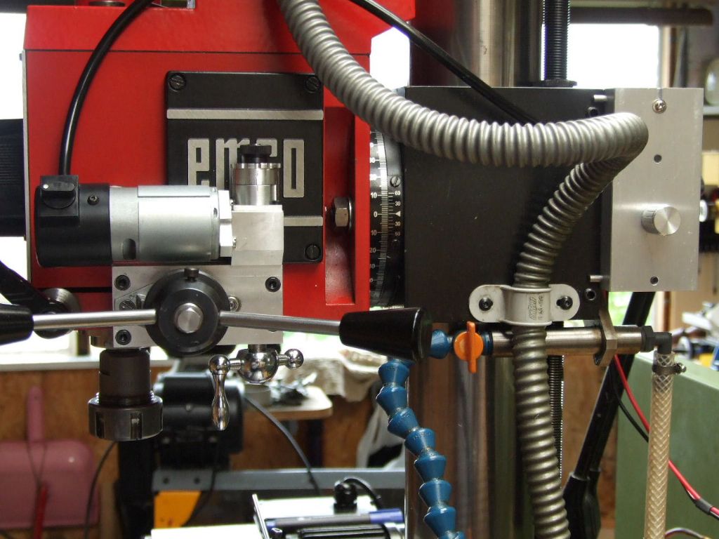

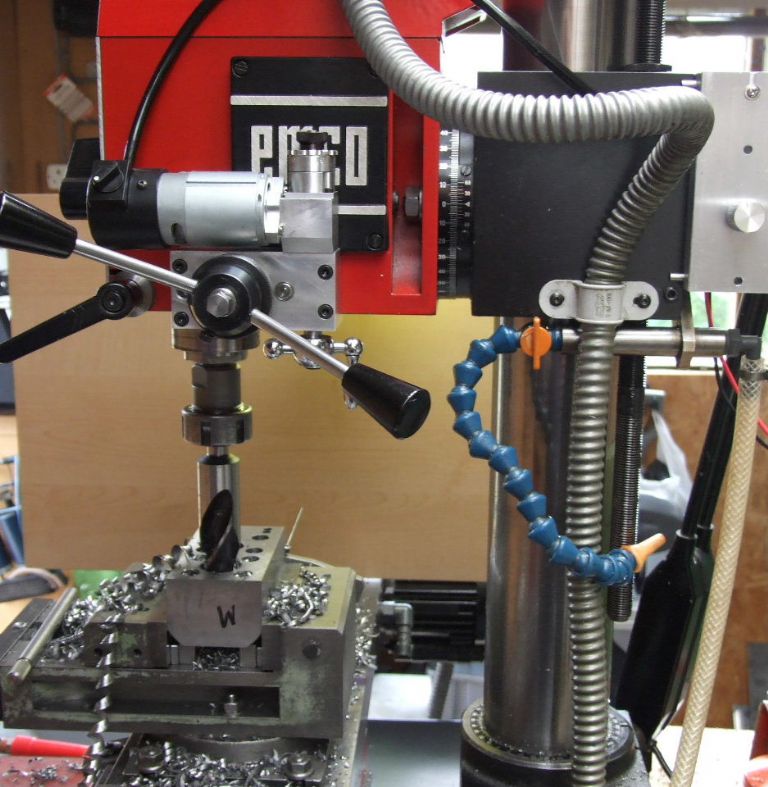

                                          Irrespective of the type of Slide way, the "Column" on any bench mounted machine is a torque tube.
                                          I have used Emco FB 2's for for nearly 40 years now and if treated with respect they can turn in a surprisingly good performance. I would not change my machine for anything else.
                                          Correct adjustment of the slider on the column is the secret.
                                          As regards Fine feeds, here is something I added some years ago .photo 4 emco fb2 quill feed finished.jpg
                                          The attachment was recently described in HSM.
                                          Regards
                                          Gray

                                            I second that wholeheartedly! Really a very nice machine.
                                            That fine autofeed is a superb mechanism Graham – very nice indeed.
                                            Here's one of mine, with power feed on X and Z.
                                            Did not know they came in Red and Grey!
                                            Joe

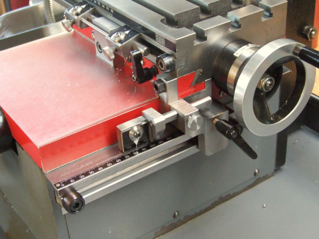

                                                  Here are a few more additions I have made for the FB 2,
                                                  Regards
