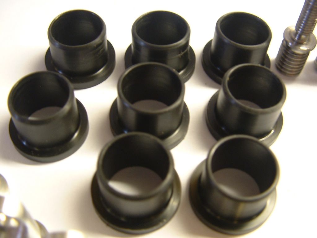

            I have found the same as Martin, whatever wall thickness when reaming using a machine reamer, after first drilling and boring, the reamed hole comes out really under reamer size, so boring to finish size is appropriate.
            I have no experience of adjustable reamers.
            The top hats shown are delrin with a 14mm bore, the SS316 stud is M8&M5
            Emgee
