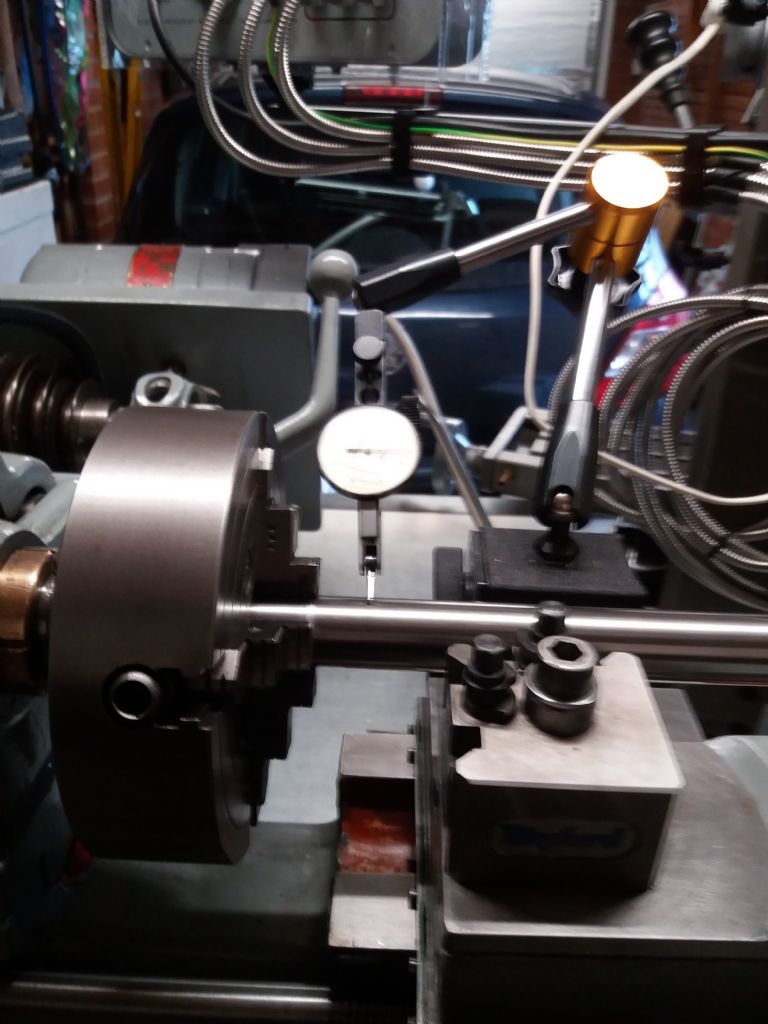

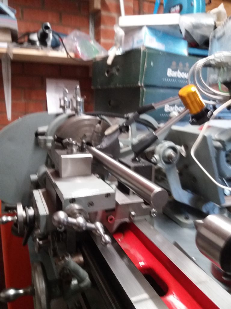

                          David George 1
                            @davidgeorge1
                            I set up my lathes with a 25mm piece of silver steel. I mount it in the four jaw chuck to run true at the chuck end and then tap the other end till it runns true as well. I then repeat til both ends run true. You can set a disk indicator on center height and run it back and forward to check bed true to spindle without wondering if spindle taper is damaged or run ing true. Repeat along top of bar to check height true running. Adjust bed clamps to adjust to run true. I then Mont a dial indicator on a stem in the chuck and allow the tip to run in the inside of the Morse taper of the tailstock and rotate the chuck to see if it is centred and adjust as nessesary.
                            I always get a true parallel cut and drill on center.

                              #617358
                              David George 1
                                @davidgeorge1
                                Hi John I was always told it was a knuckle union. They come in various sizes to match what you are holding and supporting with. The one in the picture is a 6mm to 6mm one.
                                This could be used
                                https://www.chronos.ltd.uk/product/imperial-dial-test-indicator-with-adjustable-holder/

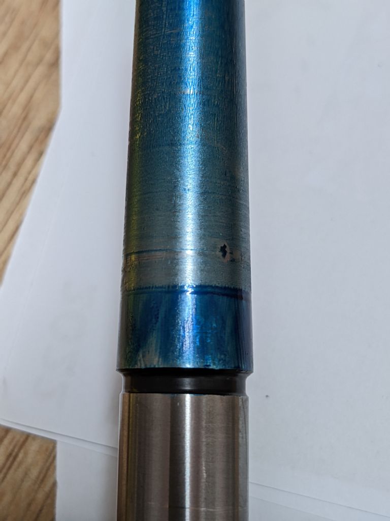

                                  Jon Halland
                                    @jonhalland84811
                                    Sorry for the late reply… the spell of decent weather prompted a garden and shed clean up, but today is proper miserable, so I'm doing a bit in the workshop.
                                    I made a blue test on the spindle taper using the test bar, see pic. The big blob is a very accurate impression of the dent in the spindle taper and also show that there is still some high rim to be polished out. I will post another pic when I get it sorted.
