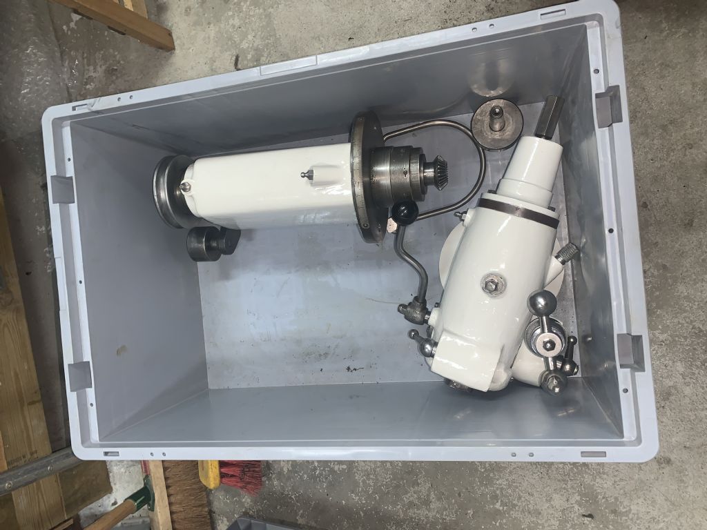

        Below is a photo of the thing apart.
        In the end I took it to an agricultural repair shop as the chap is frequently called on to renovate/repair machinery that has been hard used and unloved. It transpired that the ring/snugging nut was almost certainly in contact with the rear face of the chuck, so I was unable to gain further clearance between it and the end of the spindle which I is what I'd tried to achieve in the earlier photos. So we turned in as shown in Peak4's photo until it bore against the bottom of the spindle – it took a considerable effort to move the nut and a man sized spanner stopping the spindle moving which was clamped in jaws of a large Colchester lathe. We then tried heating it, but it made no difference. So back in the lathe and with some more enthusiastic hammering on the spanner until it finally came apart.
        The snugging nut is a nice clean thread so I'm sure it was just very tight up on the body of the chuck. The drawbar takes a meandering path from one end to the other, no wonder it wasn't very useful. The taper on the chuck seems to be nice and clean, but that in the quill has clearly had swarf and other inappropriate things in it. I'll have to get an MT2 taper reamer to clean it up.
        Gents, again thank your for you help – it gave me confidence in what we were doing and a successful outcome.apart.jpg

            Congratulations, it is such a relief to have it dismantled at last. The male taper looks ok, a little rust was expected. The drawbar thread looks a bit odd, I was expecting a 3/8 Whitworth and yours looks finer. You may have to make three drawbars, that mystery thread, a 3/8 W and a 10mm, to suit whatever tooling is fitted.

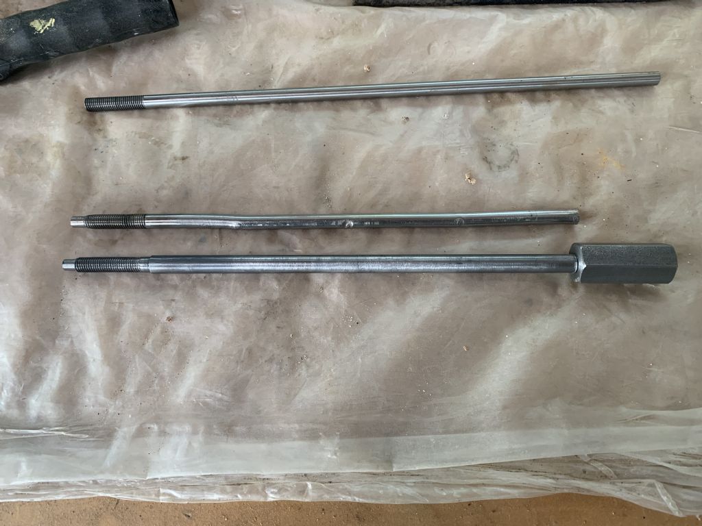

                        Finally produced a new drawbar. Turns out the thread on the original was 5/16 BSF (22tpi). So I've turned down a length of 3/8 and threaded it. I've added a length of Hex bar to the top with a 3/8BSF (20tpi) and will also drill and pin it when I can. The 3/8 rod is a firm fit in the quill, but I can turn it fairly easily with fingers so don't think it will cause any problems and should transmit any stout taps without too much flexing.
                        Its not at all sophisticated, but I think it will suffice and if I need to make another at least I now know how.

                          As long as plenty of thread goes into the end of the tooling, it will withstand the shock of breaking the taper very well. If you later decide to reduce the diameter by a few thousandths of an inch, it could best be done in three or four stages in the lathe. Start by putting a centre in the hex end for tailstock support and it won't matter if the overlaps show.
                           Steel for drawbars can be made from en16t or en24t they both machine quite well.

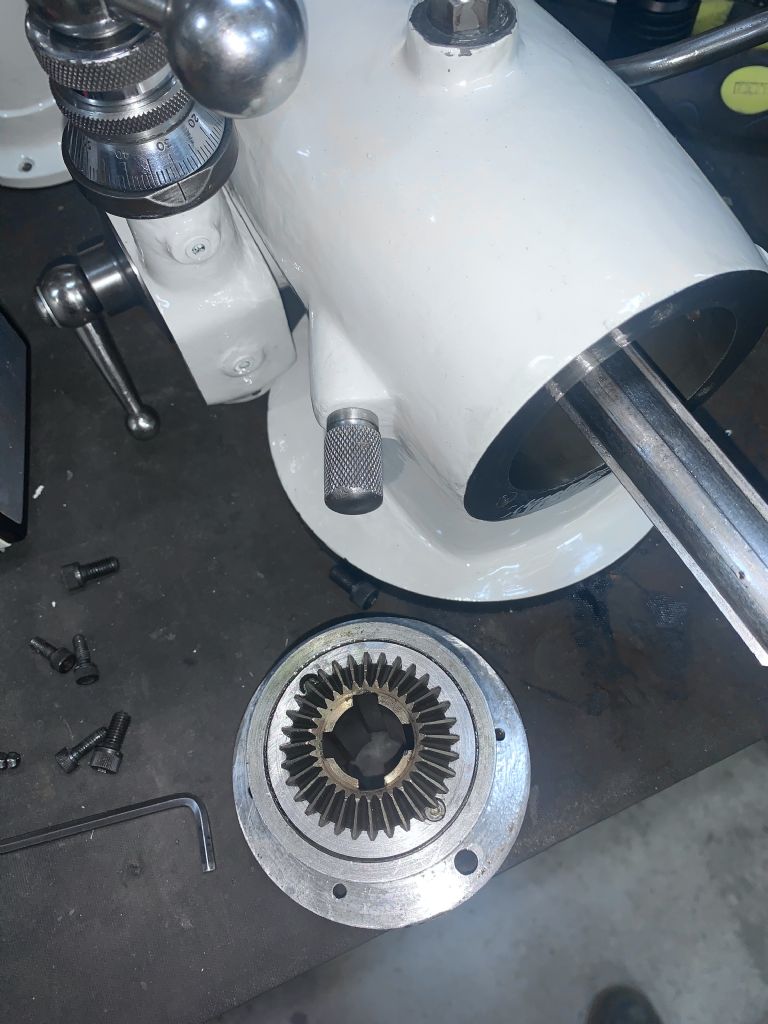

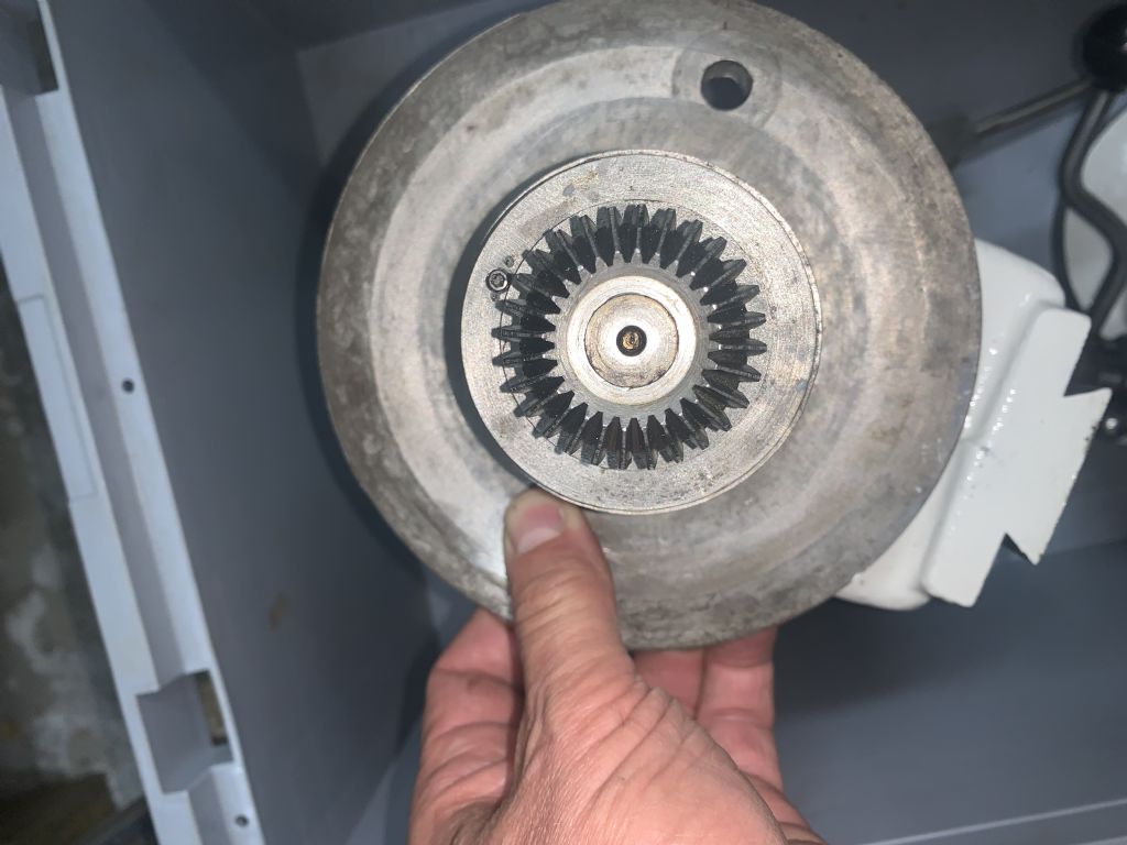

                              Hi Duncan,
                              I counted 28 on the driving shaft and 32 on the driven. By my calcs that gives approx 15% reduction in speed of 1600 input shaft and 1400 at the quill. Photos below:
                              Hope that helps.
                              Edited By Avon on 27/07/2020 22:38:24

                              duncan webster 1
                                @duncanwebster1
                                Excellent thanks, Using my tacho I'd got the ratio to be 0.8759, whereas it is 0.875. This is probably down to error in the resonator speed of the Arduino and or the xtal in the other tacho I used for calibration) (~0.1% that will do for me)
