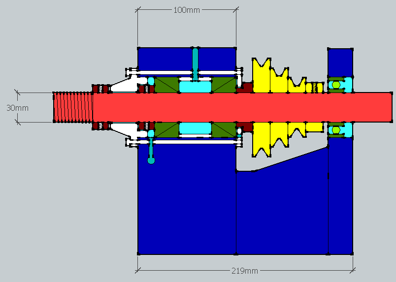

      It turns at there is a limit to what you can produce on a plain turning 1.75" centre height lathe. Due to these limitations I'm prepping for a project of making a new 150mm centre height lathe.
      Was looking on advice for the headstock.
      Red is 30mm bar, dark red is shaft collars, green is bearings, yellow is pulley, white is solid housing cross section and blues are hollow parts of the housing.
      In the front (left) bearing housing there is a deep groove ball bearing and twinned taper roller bearings.
      The two dark blue lines on the top are oil holes and the one below is the oil drain. According to Timken taper roller bearings naturally pump oil through themselves as they rotate so the oil should naturally splash about inside and be directed into the centre to drain off.
      My question is: Is it possible and/or necesarry to seal off the points where the spindle leaves the bearing housing? I don't want oil splashing out and I don't want dirt floating in. I was thinking of getting a shaft collar, turning a small part down to 1 mm under the size of the housing opening and screwing it in place which would stop large swarf getting in but that still aloows some oil and grit to move about.

          Hi Rainbows
          Some variations on your theme here…..
          **LINK**
          You really do need to keep the swarf out there are dozens of inexpensive mechanical seals available.
          It appears your main shaft is not stepped? Usually there is a step that provides positive location and provides an opposing face to preload the tapered roller bearings.

            Rainbows,
            I agree with John M. You need seals. You also need a shoulder against the bearing race. You also need a shoulder for the chuck to butt against.
            I would like to suggest some changes to make the headstock more robust.
            Eliminate the ball bearing on the left side of the headstock. It adds little support compared to the tapered roller bearings.
            Replace the two roller bearings with a single bearing of double row design. Place it as close to the left end of the headstock as possible, leaving room for a seal. That will place the bearings as close as possible to the chuck for maximum rigidity. Use shims under the bearing retainer to adjust preload. Timken and SKF have several sizes of roller bearings to fit a given shaft. That will give a choice of load capacity.
            The ball bearing at the right can be a pre-lubricated bearing with seals.
            Refer to the bearing manufacturers' literature for the proper fits on the shaft and housing.
            I hope this is helpful.
            John R

                Your best option would be a "Labyrinth " seal, various types designed for lathe / milling spindles. Some designs involve fairly complex machining, other styles less so.

                  Quick morning reply:
                  I agree on the right being a lubricated for life bearing.
                  Re haveing no steps on the shaft: The plan was to have the shaft collars act as the chuck abutment face and to bear on the taper roller bearings. Doing this instead of turning the steps from a larger piece of stock is that at the moment I have no lathe that is big and accurate (I have one thats small and access to one with tapers and runout all over the place). Would using shaft collars be suitable for this?
                  One thing I didn't explain properly in the original.
                  The plate on the left is bolted into the housing. The design will probably need changing to accomodate a seal but the idea is the tighter the bolts are the more it is pulled in, pushing the ball bearing further in then though a small ring between the ball bearing and taper bearing preload the taper roller bearings and keeping everything positioned.
                  Will have a look through more of those alternate designs and look around for seals later today.

                    I'd get the taper bearings further apart, being so close together and in the middle of teh shaft you will not get the benifit of the taper and will still have the slight ply from the end bearing where you need the support.
                    Out of interest all my lathe has is a close fitting 3mm thick disc between bearing and the outside world, seems to work OK.

                      The problem with a separate shaft collar is getting it sit perfectly on the shaft, even with a press fit there is a chance it will be slightly canted, if it is there will be a cam action forcing the spindle to move in and out as it rotates. It behaves like a micro version of a swash plate, often used in car aircon compressors.
                      The advantage of turning the spindle and its flange in one setting is the greater accuracy obtained. Unless of course the lathe it is turned on has the same problem, in that case that lathes error would be replicated.
                      The same laws apply to the nut and lock nut used to set the preload on the bearings against the shoulder, for better quality machines sometimes these nuts are turned or more likely ground while mounted on the spindle as a set.
                      Maybe you can find a local model engineer with a larger lathe to make the spindle.

                        There are old but excellent designs for taper bearing spindles from Timken here:
                        http://www.model-engineer.co.uk/news/article/lathe-bearings/19136
                        Your design is a bit like number 2, but I think you should give more consideration top getting support closer to the ends of the spindle.

                          Your best bet IMO is to study what various lathe companies did over the last 100 years and then apply yourself to the task
                          Personally speaking, I'm a solid bearings fan

                            This is where I got the idea for that ball bearing. I assume SKF had their reasons so I blindly followed it even though I wasn't sure what the extra cylindrical roller bearing was doing there. That timken article is a great link though.
                            Am I correct to say that if I bought this then it would be a matter of locating it in the 62mm bore and it would keep debri out and oil in?

                              Hi Rainbows, The way I see it is since you are designing the lathe from the ground up then you have the opportunity to adopt "best practice" and utilise a proper seal for the bearings / spindle. I take me hat off to you for taking this on as it is no small task. It will involve considerable work ,and possibly expense [that depends on final spindle size ,Bearings ect] so best do it right. from the start. Labyrinth seals are designed for just that application A good place with all the info you could need re bearings for machine tools is
                              http://www.shaeffler.com there you can view or download a pdf . Remember also the bigger the spindle Ø the bigger the bore you can have, the down side is bigger bearings and more cost. It will certainly be a "challenge " so best get things right. Good luck.yes

                                  Those roller bearings "NN" have a very shallow taper to the inner race bore – they fit to a mating taper on the spindle and, when sufficient force is applied by the locknut, the inner race expands to take out the radial play. The oil port that comes out at the front of the spindle nose leads to a groove – high pressure hydraulic oil (think 10,000 psi + ) is injected here to help get the inner race off at rebuild time . This arrangement is favored by several German builders of heavy duty lathes – sometimes the pre-loaded double angular contact thrust bearing is replaced with standard ball thrust bearings. Very, very expensive in precision grades & can be very hard to find.
                                  Note the labyrinth seal at the spindle nose, with drain hole at the bottom to let coolant out.
                                  As a solution, this is way overkill for a small lathe IMO – opposing taper roller bearings at each end of the spindle as used by Boxford (for example) would be fine. If you cannot turn a spindle with a suitable integral location flange, could you design your headstock around one of the mini-lathe spindles, which appear to be quite cheap as spare parts ?

                                    You have got your taper roller bearings in arse about.

                                        I'd be tempted to make life easy for myself if I were doing this job by using a pair of readily available tapered roller bearings used as car wheel bearings. The kits, some with seals included, are available at car parts stores etc. Just set them up like in a car, with the bearings opposed (but not erse about as Mr Stevenson points out). Standard rubber lip seal on each end should keep swarf out and oil in.
                                        Put a step or collar on the chuck end of the spindle and a thread and nut on t'other so you can tighten up for a little bit of preload. Outer races of the bearings would need to be held firm by steps in the bores they fit into, flat plates bolted on the ends as already proposed, or by circlips in grooves machined into the bores.
                                        Plenty of commercial lathes use this set up quite successfully. EG Boxford etc. Viz:
                                        Good idea pointed out above to look into using a pre-made spindle sold as spare parts for cheapo Chinese lathes (or others). If you make your own, using your idea of the collar to do away with turning down a larger shaft on a small lathe, I would use more than just a grub screw to locate it. Probably several screws or even dowel pins locating into holes in the spindle. I wouldnt worry too much about a collar sitting not quite square. If the bearing inner race is a neat fit on the spindle, it is going to run true enough. Or you could mount the collar on the spindle then spin it in your smaller lathe, presuming it fits, and take a trueing cut over the face that rests agains the bearing inner race.

                                          Posted by Rainbows on 06/05/2016 10:02:17:
                                          SKF have used opposed angular contact ball bearings for end thrust and plain rollers for side thrust.
                                          The plain ball you have will only deal with side thrust, but where it is is a better place to put a roller bearing (taper or standard) – as close to the point of application of side thrust as possible.
                                          Back to back bearings to take end thrust are good – as this minimises thermal expansion between them, but is probably not a big issue for your lathe. Taper rollers at each end would be good.
                                          If using two opposed bearings to set the axial postion, the other bearings must be allowed to 'float' along the shaft.
                                          The timken designs are great, although these days most people would use fit and forget grease in the bearings of a hobby lathe, not a pumped oil supply – saves on making those labyrinth seals as well!

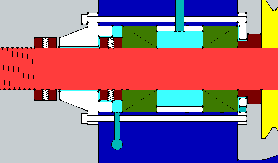

                                                      Bearings are dearsed, ball bearings which should have never been there chucked and an attempt at labyrinth seals made.
                                                      Nose piece is going to be bored/reamed to leave a very small gap around the spindle which should keep a lot of dirt out then the idea is to have the inside of the nose bored to again have a very small gap around the collar. It isn't as complex as some labyrinth seals I looked at but 45mm of tight space with 2 turns seems like it would be good enough. Failing that I could put another groove in.
                                                      I strongly borrowed from the third spindle in the Timkens link.
                                                      Some miscellaenous points:
                                                      The ring in the bore the bearings butt against will be doweled in place which seemed easier than line boring two shoulders in.
                                                      The red piece between the pulley and bearing adjusts preload. Forgot to add any screws but it is basicly a shaft collar. To axially place it I plan to use another shaft collar with holes tapped in it to be paralell to the spindle. The tapped collar is locked in place and screws in the tapped holes will push against the other collar to set preload. Once set the other collar is locked down and the adjusting collar removed. Hope that makes sense.
                                                      Tragically the housing is to be cast alumium. Mk2 might be cast iron but I don't have the funace for that (my cast iron grade graphite cruicible yearns to be used).
