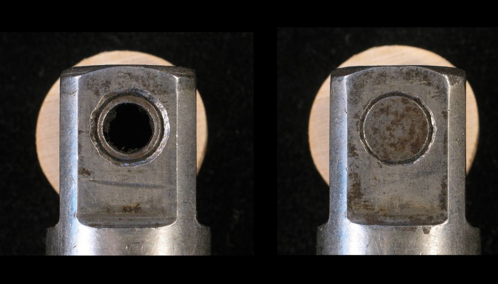

      Hello – I recently bought this 6" x 1/2" socket extension with tommy bar hole.
      I guess it's from the sixties, since it's made from chrome vanadium steel.
      Sadly, the ball catch (or at least the ball) that holds the sockets in place is missing. I can see that opposite the ball catch, there is the rear of some kind of insert
      (the brown circle is a just a piece of wooden dowel supporting the piece)
      Questions:
      1) How where these fitted?
      2) Is there any way a guy with a shed (vice, electric drill, files, hacksaw, usual hand tools) can repair this?
      It's just too nice a thing to see scrapped.

          It looks like the ball catch is just pressed into the square head. If it were me I would try and get the appropriate sized ball (and a spring) , insert into the hole and peen over the rim to lock the ball into place (that is how they are usually held in place). Might be fun getting the right combination of ball size and spring tension but could be worth a punt.

            It is probably a pressed in insert with a ball and spring, or was. I would press out the piece/socket you can see, get a ball that just slides into the bore of the socket. Then put a spring into the socket power fulll enough so that when you sit the ball on top you can press the ball into the socket. Now with the ball depressed punch the top with a centre punch to close up the bore to retain the ball and spring and press back in.

              Replacing the ball and holder insert is the obvious way – press out and press in a new one. Unlikely to be available, but one never knows unless one asks. Option is to make or repair the insert or try to secure a suitably sized ball, with a spring behind, in that socket by peening the edge.
              I think I might make a cone for a ball, parallel behind and threaded to take a screwed in cap that to be loctited in place. Ball may need drilling to make space for a spring.
              Looking at it, there may be a sneaky suspicion that the hole in the extension is not parallel and may have compressed the insert sufficiently at that end, during insertion.

                  Agree, make a new insert and press or loctite in. Don't over think it quick, easy and works is what you want. Frankly its faster to make summat than to search for anew one even if such were available.
                  As NDIY suggests easiest way is to drill from the back leaving a small rim to retain the ball. I'd drill until the drill just breaks through then machine the front back until the ball projection looks about right. My socket sets seem to have a bit ofer 1/3 rd diameter projection.
                  Screwed insert for the cap is engineering, loctite is practical!
                  If the bore in the extension is tapered drill it out parallel first.

                    Do it the easy way.
                    The ball popped out of that existing hole. So if you get a ball the same size, you should be able to pop it back in through the same sized hole. (After putting a spring out of a ball point pen into the hole first.) A tap with a brass drift might help pop the ball in through that hole
                    Then all you need to do is peen that hole closed a few thou to hold the ball in place. Centre pop marks would do the trick. The hardened end of a flat-nosed drift might make a tidier job. Or whatever you have to hand.

                        It is fairly obvious from the photo that a repair has already been
                        attempted ,the tatty chamfer around the insert no doubt done
                        removing the old detent ball .
                        These detent balls are nearly always fitted in a blind hole and the
                        a press tool used to peen the edge over.
                        It would be a mistake to find a ball that fits in the hole,if you
                        look at a new socket end and examine it you will find that the ball
                        has quite some side clearance in the hole,as these things are used in a
                        dirty environment debris soon finds its way into the unit and renders
                        it useless if you have a close fitting ball .
                        Using centre pops the close the hole is equally useless as it leaves an open
                        gap for the dirt to get in ,again examine a new one and you will see
                        what i mean.
                        The sketch here is nearly to scale with 5 mm ball made in two parts
                        and would require the use of a lathe to make.Doing it this way you can
                        assemble and test it before fitting in the existing hole with some
                        low strength adhesive.

                                I have an identical King Dick socket set to yours contained in a blue painted steel case complete with sockets, also extension bar, sliding T bar and a very neat ratchet handle all of have the same arrangement for the retaining ball.
                                john Pace undoubtedly illustrated the general arrangement.
                                I have measured/estimated the ball as being 5/32" diameter – a standard size cycle bearing. I believe after comparing your very clear photos with my extension bar et.al. that you are only missing a spring and the 5/32" ball.
                                Once you have obtained replacements you will need to somehow peen the edges of the insert around the ball by compressing it into its housing and use a centre punch to slightly distort the rim of the housing. Use an automatic punch as it can be used one-handed – Mind your eyes when attempting this. The "factory" peening on my three bars is very neat obviously done in one operation using a form tool – simple but very hard to exactly replicate in the workshop.

                                    John Pace's drawing shows what used to be there.
                                    If you can find a suitable spring and ball, fit them, and just stake the edge of the insert to retain the ball into place.
                                    The spring loaded pin arrangement gives better retention, but the sockets have to have a through hole for it to fit into.
