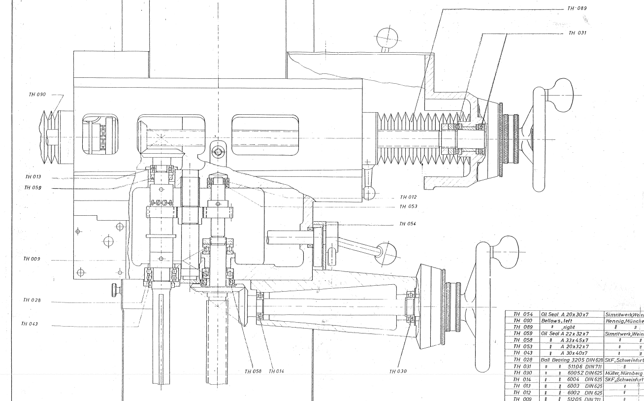

      I want to clean the X axis ways and lead screw of a FUS250 (Thiel 158 clone)  milling machine. For this I want to remove the saddle. I removed first the worktable
      Now I have access to the saddle. I disconnected the lead screw from the saddle at the handwheel end:
      Now I was expecting to be able to push the saddle by hand. But it doesn’t move! I don’t understand why. How is this machine working? I thought there should be some kind of nut for the lead screw in the main body. And a gear that slides along the lead screw for power feed (it has an axial groove). Why the saddle doesn’t move after I disconnected it from the lead screw?
      This is the only drawing I have for this part of the machine. But I don’t see the nut. And why the left end of the lead screw has some kind of clutch? I’m running out of ideas.

      Pete Rimmer
        @peterimmer30576
        My FN22 is the same type of design. That part is called the console table. On mine, you remove the traverse handles and the two end plates then the table slides off. The ‘nut’ is in the end of the z slide housing.
        If your table was sliding with the handwheel but now is not, then it’s probably just sticktion in the ways. Remove the gib amd just bump the table upwards with a rubber mallet. Squirt some oil in there and it will glide right off. This sticktion is the reason we put oil flaking on the ways. It breaks up the surface and allows space of roil to accumulate.
        #733266
        Sonic Escape
          @sonicescape38234
          Yes, it was the gib! I removed completely the two screws at both ends and now I can push the console table by hand. After I’ll clean the ways I’ll use same oil from my lathe. It is a special way oil and it is suppose to help with sticktion.

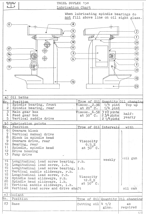

                        This is the oil I was referring to. Since it is suppose to have “very good anti-stick slip properties” I thought it should be ideal for this. Also being sticky will prevent it from leaking all over the machine.
                        But I had a look in the manual and surprise, there is mentioned what oil to use. My oil has viscosity 68mm²/s at 40°C. And the manual recommend 12.8E. But what is E? If it means mm²/s then I’m way off!

                          But what is E?
                          Engler viscosity units. Conversion table here.
                          HTH
                          Nigel B.
                          #733370
                          Sonic Escape
                            @sonicescape38234
                            12.8°E = 97mm²/s. The closest ISO oil is 100. So my oil was actually to thin!
