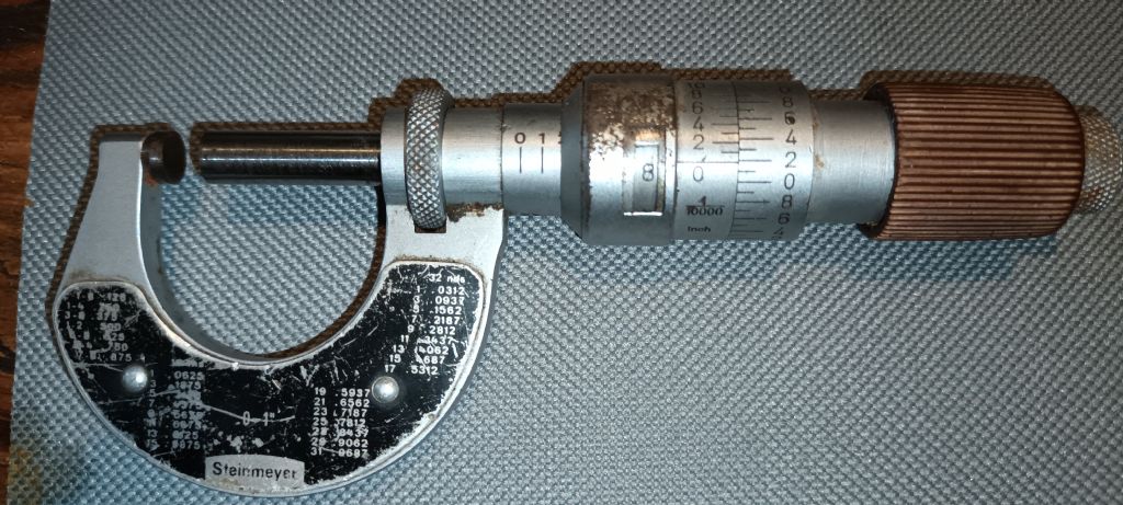

      I'm just back from my local car boot where I picked up a cracking little micrometer for only £2. It seems very well made it all lines up on zero and the dials are clear. Only trouble is it's a bit different to anything I've seen before and is marked as 1 to 10000 and I'm struggling to work out how to read it. The left hand side and the number in the window seems easy enough (in the photo 0.18) but what next?
      #11027
      colin hamilton
        @colinhamilton16803
        #572259
        Anonymous
          I assume the micrometer is imperial and can read to a tenth of a thou. I'd read it as follows. The linear scale on the barrel gives tenths of an inch.The digit in the rectangular window gives hundreths of an inch. Assuming that the scale immediately to the right of the window doesn't move the two scales on thimble together look like a vernier and will give thousandths and ten thousandths of an inch.

          Mike Hurley
            @mikehurley60381
            My thinking also. Andrew beat me to it!
            It does say 0 – 1" just above the Steinmeyer label

                Posted by colin hamilton on 21/11/2021 09:51:35:
                It's a vernier scale, have a look at this link to see an example. They're read by scanning the graduations to find an alignment and doing an addition. The example is metric, which makes for easy reading, but decade inches are just as good. Inch fraction verniers exist too; nasty! Verniers have to be practised and it's easy to misread them. Take care.

                      #572289
                      Nicholas Farr
                        @nicholasfarr14254
                        Hi, well it looks to me that the 8 at the extreme right is in line with the 7 to the left of it, Therefore I think it is reading 0.187.6" But of course I might be totally wrong.

                                  Colin,
                                  As for your micrometer I am reading it from the photograph as 1 + 8 + 1 + 9 (not being able to see the 9 on the left hand vernier scale I am assuming it lines up! )  = 0.1819"

                                        #572462
                                        colin hamilton
                                          @colinhamilton16803
                                          Blimey I can't wait to post my next car boot bargin!! Thanks for the advice. So for the last two digits do I just see which two are aligned and that's the answer?
                                          #572481
                                            Posted by colin hamilton on 22/11/2021 12:53:31:
                                            … So for the last two digits do I just see which two are aligned and that's the answer?
                                            Maybe. The easiest way to find out is to experiment. Get some drills and measure a few shank diameters. Drill shanks aren't accurate, but they're close enough to show how the vernier is read, and whether any arithmetic is needed.
                                            ¹⁄₁₆" look for 0.0625
                                            ⅛" look for 0.1250-ish (0.1245 to 0.1255&quot
                                            ³⁄₁₆" look for 0.1875-ish
                                            ¼" look for 0.2500-ish
                                            Although they look simple micrometers aren't easy to use properly. Takes practice to read an ordinary thou micrometer and yours is ten times more sensitive. It's likely that readings will be all over the place at first. The clutch helps, but getting consistent results really requires the operator to develop a sensitive feel by practising on accurate standards such as gauge blocks. Some people get a feel really quickly, a few never get it, and most need several hours practice. Not good to learn on a wonky micrometer.
                                            A thou micrometer will usually detect size errors in jobbing drill shafts because the steel rods used to make them aren't super-accurate. A tenths micrometer should see variations up, down, and around a drill shank, and might detect temperature changes too. If you measure a ³⁄₁₆" drill and get exactly 0.1875", there's a good chance the operator is torquing the micrometer to get the 'right' answer – observer bias. Unfortunately, in the tenths zone it's hard to tell the difference between correct measurements and errors caused by poor technique and faulty instruments.
                                            Measure a few things and tell us what you get. We should be able to work out what the vernier is doing from a few examples.
