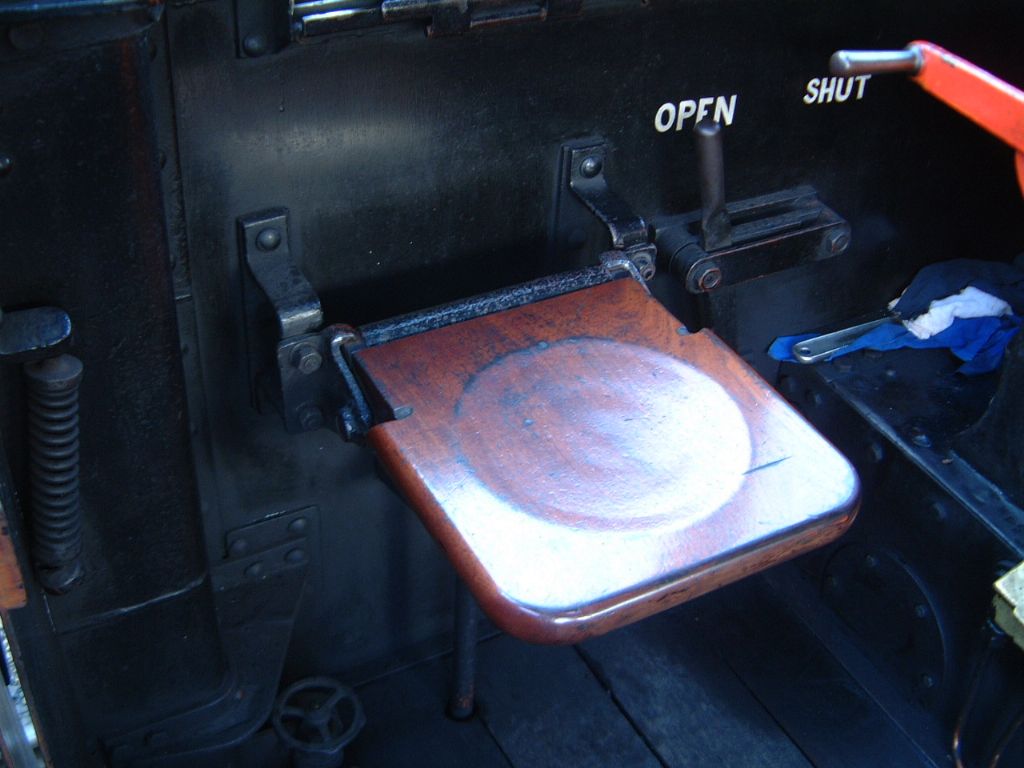

      Here is one for the rivet counters. I would like to be able to fit a couple of tip-up driver/fireman's seats to a 5" gauge loco from oak measuring typically 15" square by 0.1" thick but the problem is that in order to make it look somewhat less slab like I would like to be able to create the bum shaped depression in the centre of the seat. Does anyone have any ideas on just how this might be achieved in 5" gauge? The attached photo shows an example of a full size driver's seat taken at one of our preserved railways.
      #2096
      Greensands
        @greensands
        #574485
          Carve it out with a gouge or some form of disc/drum sander. I assume it's 1.5" square not 15"
          It's an odd shaped bum depression as most people have two buttocks, I wonder if the metal one shown has just become dented over tine by being used as a step

                It does seem strange that a seat would have one central depression as in the picture as many wooden seats have a U shape depression. And I doubt if standing on a wooden seat would dent it like metal Jason.
                Maybe designed like that so they would not want to sit for long. To recreate this a simple dremel type drum sander will aid in making it because of the scale of it but don't forget the bolt in the middlelaugh.

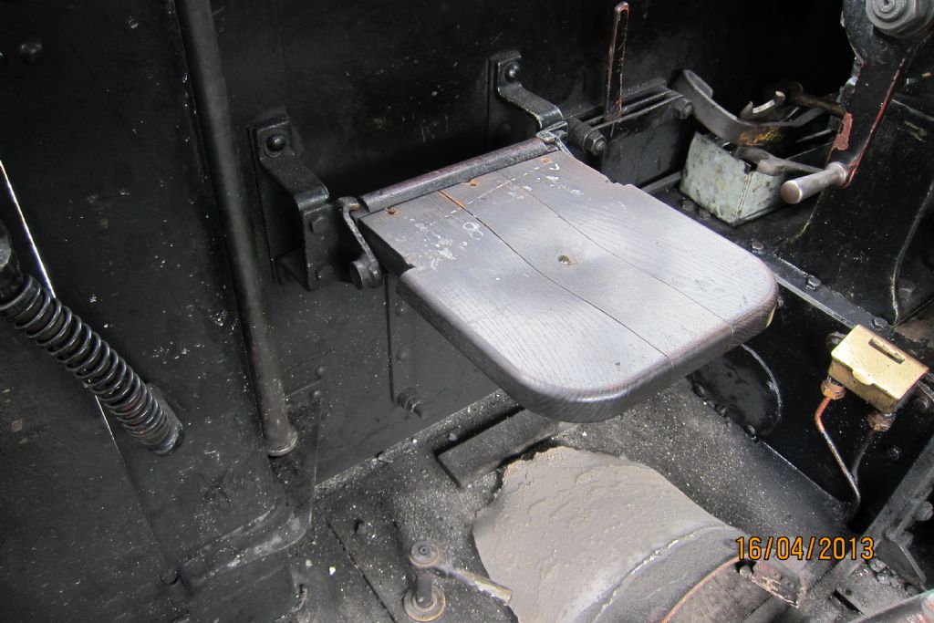

                  Jason, on my screen, the seat shows woodgrain and looks to me like three pieces. To make a replica, I would use a dremel size flap wheel.

                        Sorry, I can see the grain now I have enlarged it, silvery colour made me think it was metal.

                                        Have attached a photo showing a second example of a full sized drivers' seat with an alternative form of profiling which would be easier to replicate in miniature

                                            Posted by Greensands on 07/12/2021 09:36:59:
                                            Have attached a photo showing a second example of a full sized drivers' seat with an alternative form of profiling which …
                                            … looks worryingly like a shallow catchment vessel surprise
