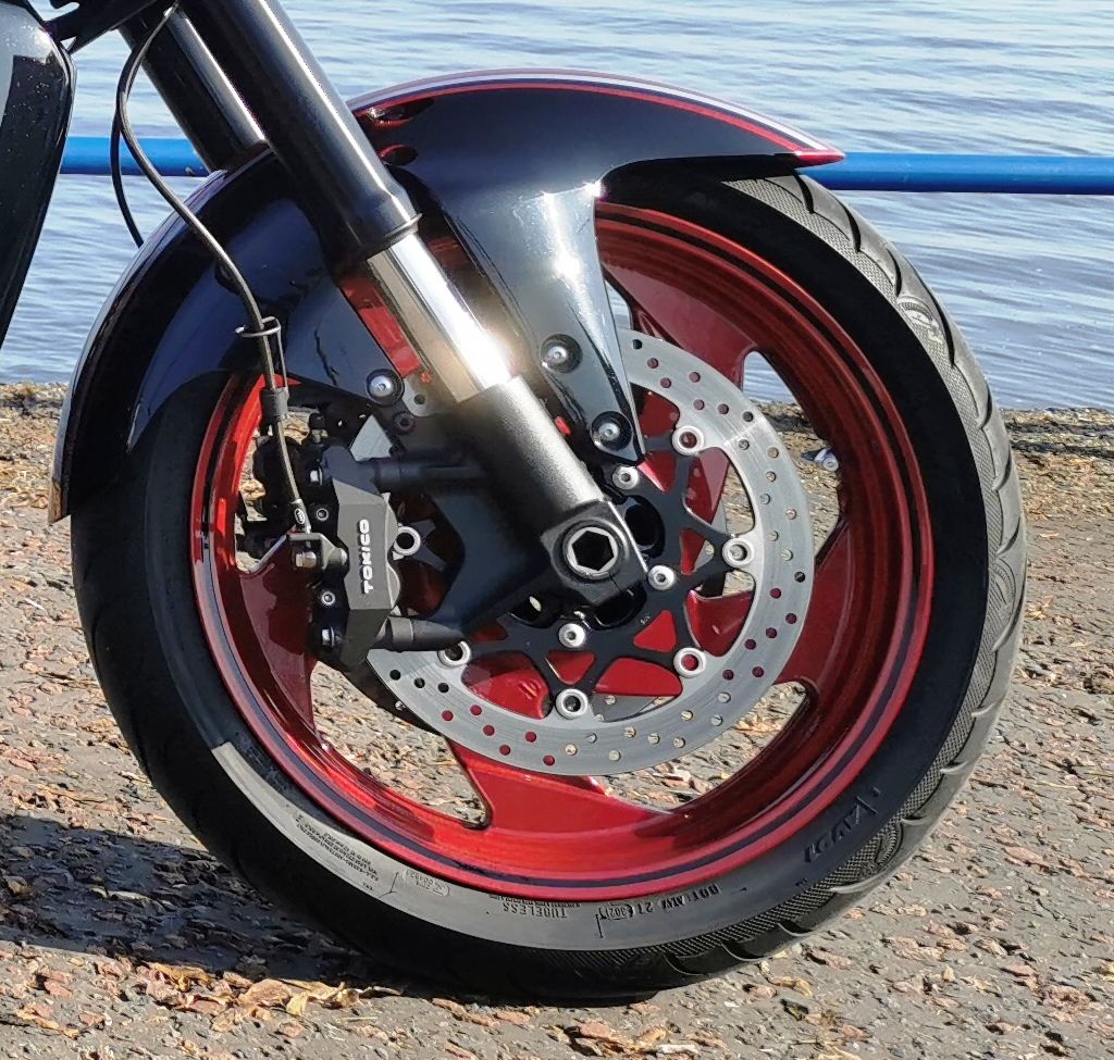

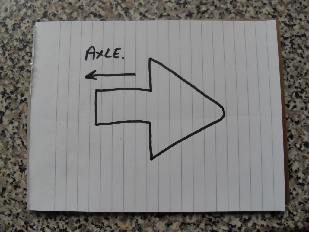

      here is my bike and a close up of the front wheel .. i want to make a couple of alloy spikes that sit inside the axle holes one is round and the other is a hex ( hex on the right and round on the left ) .. see the drawing .. the problem is they are easy to make but i can't work out how to make them stay in ? i know i could make them a tight fit and tap them in but that's no good for a few reasons so is there a way to keep them in the holes ? nothing sticks out they will be sitting flush .. thanks guys …img_20220326_144628.jpgcrop wheel.jpgsdc12176.jpg

          Counterbore the spigot and bond in a strong magnet
          #591940
          BASS 666
            @bass666
            Posted by JasonB on 29/03/2022 16:26:16:
            if you mean the spike then there is nothing for the magnet to stick to cause the axle is alloy and hollow …
            #591945
            Bill Phinn
              @billphinn90025
              Drill and tap the inside ends on both plugs and connect through the hollow axle with a piece of threaded rod.
              Cross drill the round-side spike to take a small tommy bar to enable everything to be tightened down.
              Edited By Bill Phinn on 29/03/2022 16:45:34
              #591946
              bernard towers
                @bernardtowers37738
                eyes on spike and spring thru spindle
                #591948
                bernard towers
                  @bernardtowers37738
                  internally thread spikes and have threaded rod thru spindle, sorry beaten to it
                  Edited By bernard towers on 29/03/2022 16:45:51
                  #591949
                  Howard Lewis
                    @howardlewis46836
                    Anaerobics do not work as well on aluminium alloys as on steel, because of the oxygen in the oxide film, but ought to be worth a try, with an appropriate grade of Loctite..
                    If you wish to tap a fie thread in the bore, and a matching one on the bits, the increased area subject to the anaerobic would result in an increase the shear force required to move one relative to the other
                    Bearing in mind the different expansion rates for Aluminium compared to steel, you could try making the OD of the steel fitting an interference fit in the ally hub, probably 0.0005" .
                    Put the bits in the freezer for at least 24 hours, and then fit them immediately after removal.
                    If need be, as Plan B, make up a "puller" with a fine thread and use that to squeeze the bits into position.
                    If you adopt this, you could possibly increase the interference to 0.001" since that will increase the grip once the steel warms back ambient temperature.
                    The hope has to be that the heat generated by heavy braking does not soak through to the hub and release the new bits.
                    Howard
                    #591952
                    BASS 666
                      @bass666
                      couple of really good ideas there .. thanks guys …

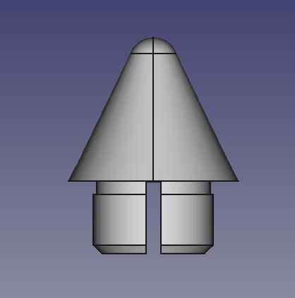

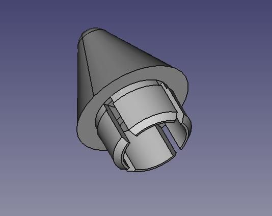

                        A mechanical way of doing it is with sprung fingers:
                        The part that plugs in is turned slightly bigger than the axle socket, say +0.2mm, and the end chamfered for an easy start. The other end is of the plug is grooved down to under axle socket diameter.
                        The inner is bored out to thin down the gripping part so the fingers can give slightly when pushed into the axle. Finally, the fingers are made by slotting the plug part with a saw or angle grinder.
                        No need for special metal – most have enough inherent spring to grip the sides. How far oversize the diameter is and the wall thickness decide how tight the fit will be. Riding the bike will detach the thingy if made too slack. But don't make it so tight it has to be bashed in with a big hammer – it risks damaging the bike!
                        As corroded mechanical grips can be difficult to get off, probably worth providing a good grip for getting it off again! Perhaps slots for a pry-bar or a few holes for a hook.

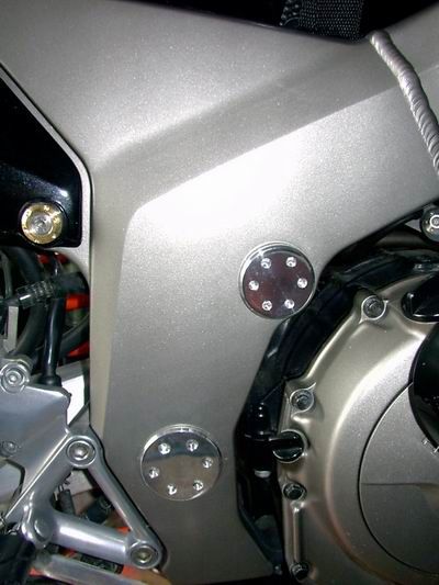

                                                  That's what I used to do, made loads of alloy, brass and stainless frame plugs for bikes and fixed them in with O rings.
